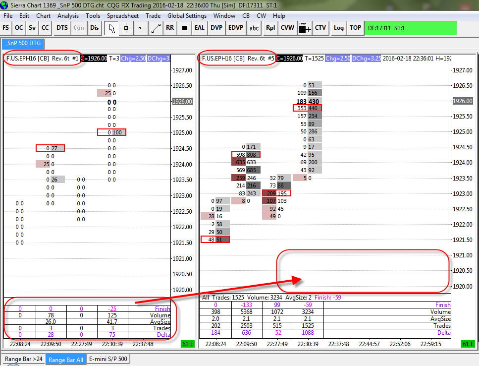

[2016-02-18 11:01:39]
2garin - Posts: 189
Good day support.
How (than) to move the indicator Numbers_Bars_Calculated_Values from chart #1 to chart #5 ?
image18.png / V - Attached On 2016-02-18 10:44:23 UTC - Size: 92.51 KB - 446 views
[2016-02-18 19:58:26]
Here are the step-by-step instructions:
Numbers Bars: Overlaying a Numbers Bars Calculated Values Study from Another Chart

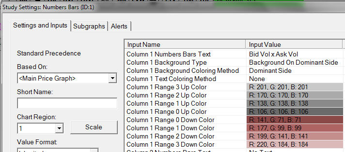

[2016-03-09 16:44:36]
2garin - Posts: 189
Good day support.
How to display _Numbers_Bars_Calculated_Values paint the cell, depending on their weight? Similarly, the indicator _Numbers_Bars.
Date Time Of Last Edit: 2016-03-09 16:54:41
image11.jpg / V - Attached On 2016-03-09 16:44:16 UTC - Size: 77.15 KB - 604 views
image12.jpg / V - Attached On 2016-03-09 16:51:48 UTC - Size: 164.5 KB - 620 views
[2016-03-09 18:39:25]
The Numbers Bars Calculated Values study cells can be colored based upon whether they are higher or lower than the value in the same row in the prior column or whether they are above or below zero. This is all the capability that exists.
We will make sure the documentation explains this.
[2016-03-10 05:02:19]
We have confirmed the documentation does explain using Auto Coloring for the Subgraphs of the Numbers Bars Calculated Values study:
Numbers Bars: Displaying Numeric Information Below Numbers Bars

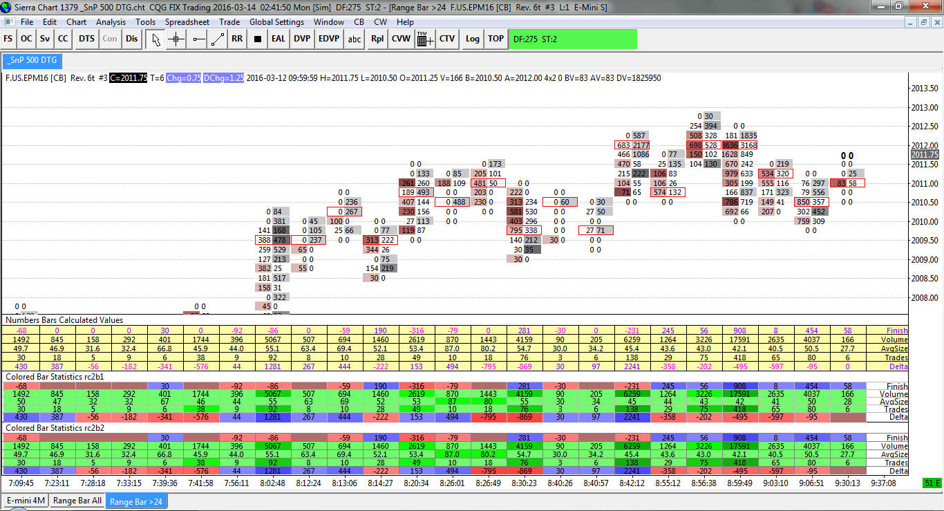

2garin - Posts: 189
Здравствуйте ganz
попробуйте аттачмент
Просто песня. То что нужно. Спасибо!
Оверлей теперь не тот
При переносе на другой чарт путает/портит названия строк.
Date Time Of Last Edit: 2016-03-13 14:23:48

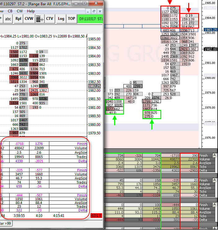

image15.jpg / V - Attached On 2016-03-13 14:02:28 UTC - Size: 347.4 KB - 435 views
[2016-03-13 14:50:11]

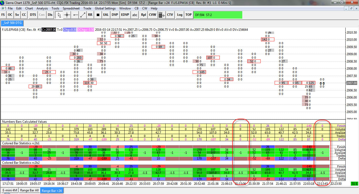

[2016-03-14 10:23:19]
2garin - Posts: 189
Здравствуйт.
image22.jpg / V - Attached On 2016-03-14 10:20:52 UTC - Size: 321.05 KB - 563 views
[2016-03-14 10:43:12]
ganz - Posts: 1048
User62522
Здравствуйте конечно. :)
"ж.. есть, а слова нет" (с) :)
добавил фильтр нулевых трейдов, попробуйте
сравните пжлст с вариантом без фильтра на всякий. спасибо.
attachmentclrBS_rc2b3.dll - Attached On 2016-03-14 10:42:08 UTC - Size: 33 KB - 474 views

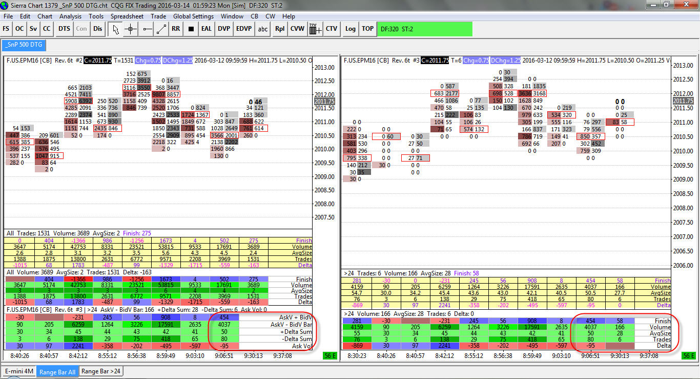

[2016-03-14 15:39:53]
2garin - Posts: 189
ganz
С фильтром и без расчет идентичный встроенному индикатору. Перенос на другой чарт корректный.
Соберу все фильтры сделаю сравнение с МД.
Date Time Of Last Edit: 2016-03-14 15:44:03
imageq1.jpg / V - Attached On 2016-03-14 15:35:09 UTC - Size: 334.26 KB - 437 views

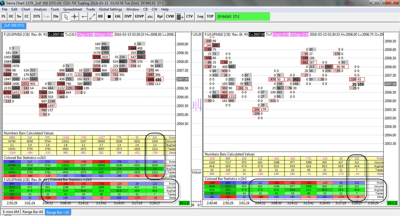

[2016-03-18 16:29:44]
2garin - Posts: 189
ganz
Индикатор красит правильно, переносится корректно, продолжаю тестить. Спасибо!
Пойду писать в сапорт про финишную дельту.
