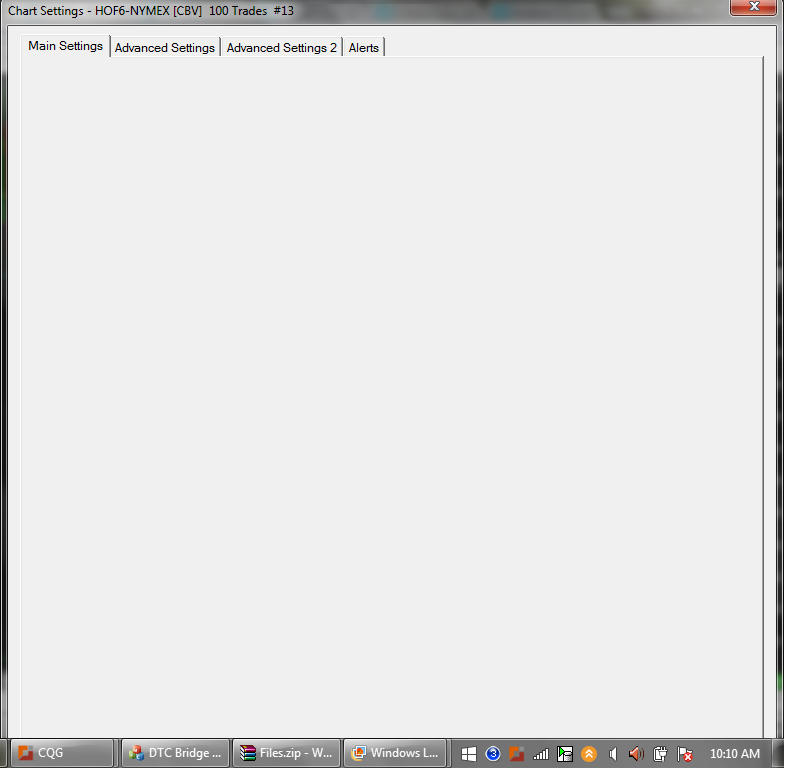

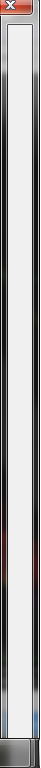

Ok I'm using SC 1330 (prerelease) now, running in ACS safe mode. I installed it yesterday when you asked me to. I duplicated a chart and then tried to pull up the chart settings window and it displayed a blank window which was not responsive to clicks. See attached.
There was no error message. But now pushing F5 and F6 don't work for any chart. If I press f5 I get the following (see attached).
imagechart settings window.png / V - Attached On 2015-11-25 18:13:44 UTC - Size: 71.69 KB - 531 views
imagef5.png / V - Attached On 2015-11-25 18:16:39 UTC - Size: 14.03 KB - 511 views
[2015-11-25 18:25:03]
This is an indication that there are too many windows open and the operating system is having a problem handling that. This is an operating system level problem.
