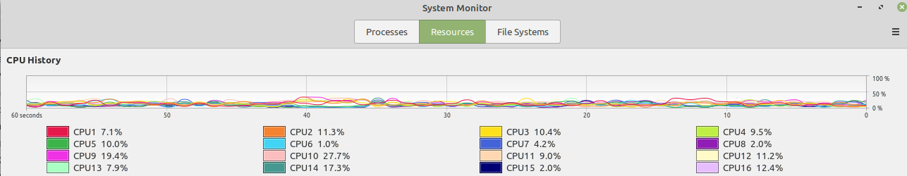

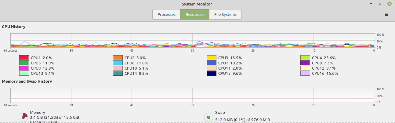

imageScreenshot from 2021-06-05 22-06-31.png / V - Attached On 2021-06-06 02:08:32 UTC - Size: 23.67 KB - 822 views
imageScreenshot from 2021-06-05 22-06-08.png / V - Attached On 2021-06-06 02:08:39 UTC - Size: 69.27 KB - 817 views

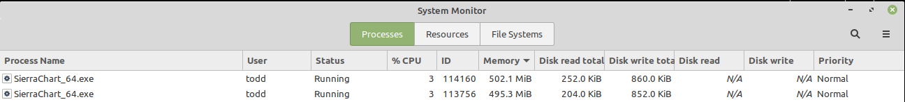

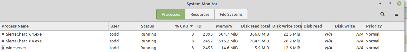

[2021-07-09 18:00:38]
ertrader - Posts: 700

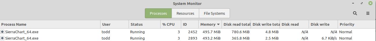

File attached
imageScreenshot from 2021-07-09 14-00-05.png / V - Attached On 2021-07-09 18:00:27 UTC - Size: 53.62 KB - 828 views
imageScreenshot from 2021-07-09 13-59-43.png / V - Attached On 2021-07-09 18:00:33 UTC - Size: 23.93 KB - 784 views

[2021-07-09 19:27:14]
Winserver is 2%. 3% SC instance 1, 3% SC instance 2. Total 8%. So many fewer issues than windows and yes I am enjoying not fixing Windows all the time!

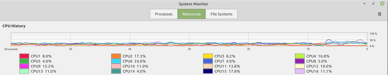

[2021-07-10 01:23:23]
ganz - Posts: 1048
ertrader
3% SC instance
are there any sshots for this?
[2021-07-10 03:16:46]

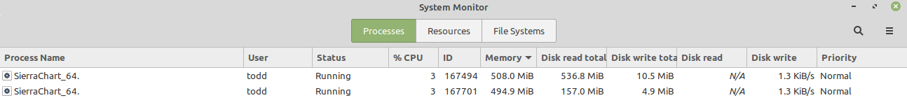

Here you go...screenshot of Linux system monitor. Aggregate % can fluctuates a percentage up or down or so. Everything else shows around 0% usually.
To be fair, my Windows 10 i7 test computer has been more stable than prior Windows updates the last 3 months or so. The usual break/fix/break/fix Microsoft cycle. (yes, Windows is test, Linux is production because SC likes to only talk Windows if you have to talk with them about any issues.)
Date Time Of Last Edit: 2021-07-10 04:17:58
imageScreenshot from 2021-07-09 23-15-57.png / V - Attached On 2021-07-10 03:16:30 UTC - Size: 29.23 KB - 856 views

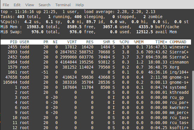

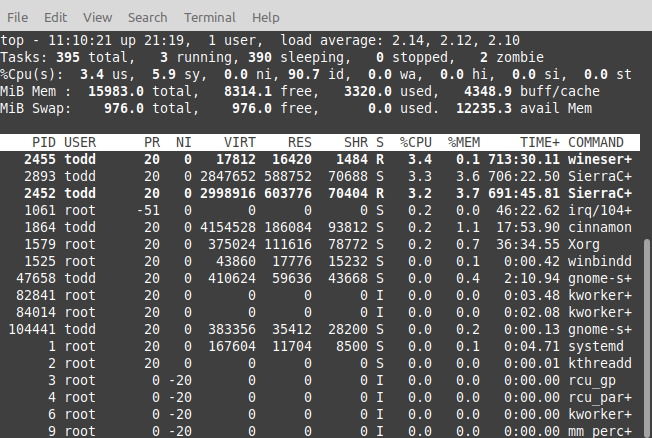

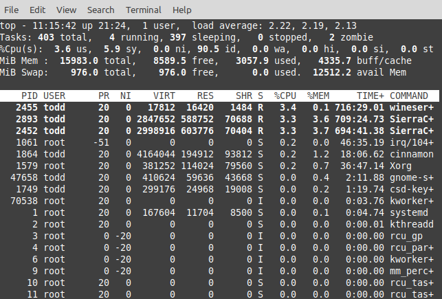

[2021-07-10 15:17:32]
Sure..here you go... Same results. Took a few screenshots as I moved and scrolled around on both monitors. It never moved above 4% for each. This does take into account all the CPU cores.
Date Time Of Last Edit: 2021-07-10 15:20:45
imageScreenshot from 2021-07-10 11-10-23.png / V - Attached On 2021-07-10 15:11:23 UTC - Size: 72.26 KB - 791 views
imageScreenshot from 2021-07-10 11-16-16.png / V - Attached On 2021-07-10 15:16:36 UTC - Size: 69.05 KB - 761 views
imageScreenshot from 2021-07-10 11-15-44.png / V - Attached On 2021-07-10 15:16:44 UTC - Size: 66.92 KB - 780 views

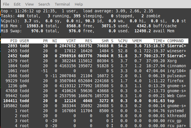

[2021-07-10 15:28:14]
If you take only 1 CPU core and compare (top default), here are the results. This system has 8 physical cores and 16 threads so you have to take that into account. Top does this in either Irix or Solaris mode. Irix (single core but you have to manually take into account # of CPUs and threads) or Solaris mode where top does it for you. You can toggle between the two modes with "shift i" while top is running.
http://manpages.ubuntu.com/manpages/trusty/man1/top.1.html
This is explained in the "3. FIELDS / Columns" section of the manpages in "1. %CPU -- CPU Usage"
Date Time Of Last Edit: 2021-07-10 15:37:11
imageScreenshot from 2021-07-10 11-26-14.png / V - Attached On 2021-07-10 15:27:10 UTC - Size: 81.79 KB - 759 views
[2021-07-10 15:36:32]
ganz - Posts: 1048
ertrader
yes. 50+% looks real.
you will get 10-15% on Win10 by design.
[2021-07-10 15:46:27]
ganz - Posts: 1048
ertrader
but wine can't do it and uses only one core
also win 7/10 uses GPU a lot efficient in this case
so you just spend HW power for nothing here heating the universe.
