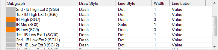

I have been trying to figure out how to write alerts with not too much success. I was wondering if I could get someone to write an example for me. I would like an alert played when price gets within 2 ticks of the IB low or high from above or below. Thank you.

Try this:
=OR(ABS(C-ID7.SG7)<=TICKSIZE*2,ABS(C-ID7.SG9)<=TICKSIZE*2)
You can put it on the Alerts tab of any study, or Chart Settings.
If you put the formula on the Alerts tab of the IB study, you don't need the ID#s.

In the meantime, you can use something like this:
=OR(ABS(C-ID7.SG7)<=0.5,ABS(C-ID7.SG9)<=0.5)

Sawtooth - Posts: 4352
If you are using the formula in post# 4, you'll need to edit the bolded value for the symbol's tick size value *2.
