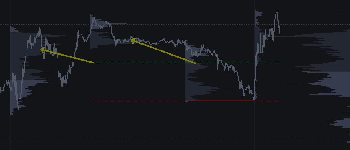

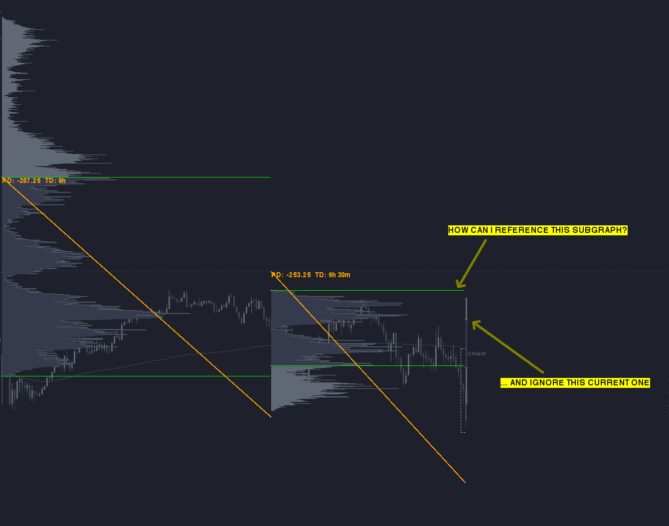

hi
im trying to reference the VAH/VAL subgraphs and ignore the current ones.

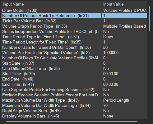

i set my the vol by price to reference 1 day lookback but keep referencing the new one.
https://postimg.cc/bss2Hfqp
i cant use the VOLUME VALUE AREA LINES STUDY because of the time period of my profiles in the chart (They have different time spans)
https://postimg.cc/jCPn54q4

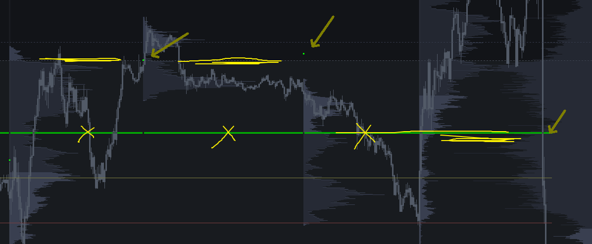

Trade with ICE - Posts: 50
thanks ... yea I have the same issue like with the HIGH/LOW FOR TIME PERIOD STUDY.
it needs a value of the previous value to be constant so it will not follow the next one.
i hope im making sense

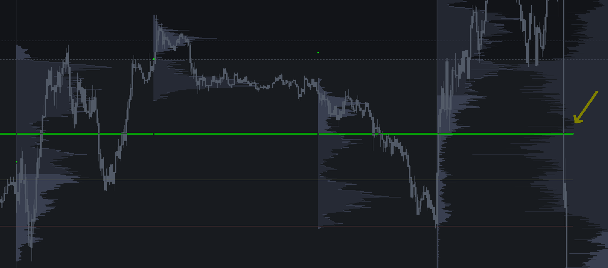

i guess it got tracked...(but with a dot) and the line didnt stay there but follow the next
imageScreenshot 2025-04-02 142846.png / V - Attached On 2025-04-02 21:30:24 UTC - Size: 30.65 KB - 243 views

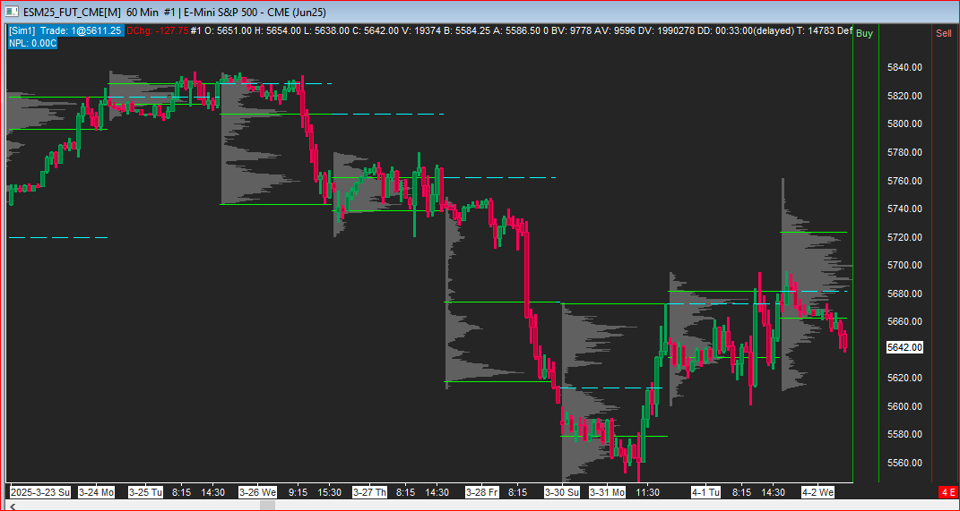

See attached pic for how it looks to me: the persistent value is the dashed cyan line.
Date Time Of Last Edit: 2025-04-02 21:38:01
imageVAH persistent.PNG / V - Attached On 2025-04-02 21:35:59 UTC - Size: 40.11 KB - 238 views
