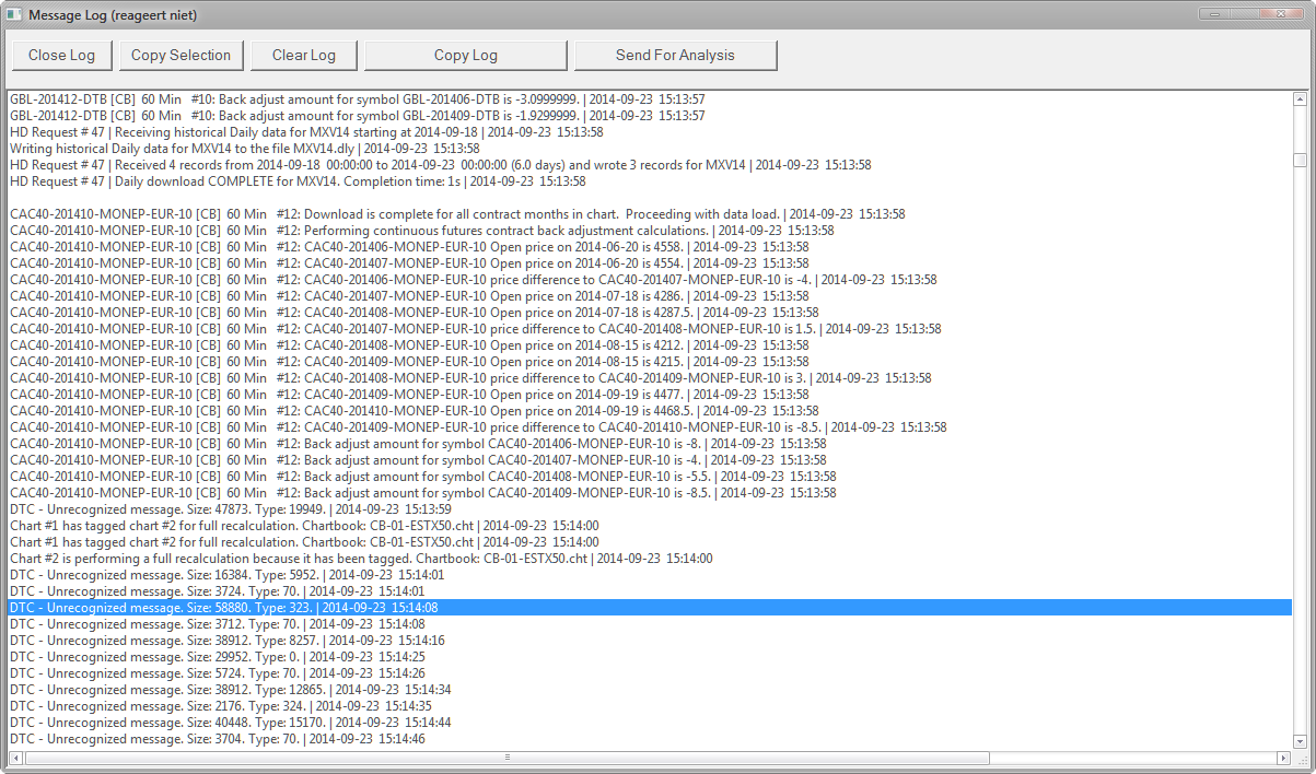

Lately I've been seeing the message "DTC - Unrecognized message" in my message log.
Today, it happened again after I opened a chartbook.
I'm seeing several messages like this:
"DTC - Unrecognized message. Size: XXXXX. Type: XXX | Time"
The sizes and types vary (see attachment).
After that, Sierra Chart became unresponsive, like it usually does.
Normally I'm seeing loads of "Unrecognized messages" per second with a size of 0. That causes SC to become unreponsive. I've waited 30 minutes in the past for the program to become responsive again, but it doesn't. I think this occured again today, because of the position of the scrollbar.
The problem occured when I was on version 1137 and it still occurs today (version 1192). Could you please solve this issue, or tell me how to solve it (if the issue is on my end)?
Thank you.

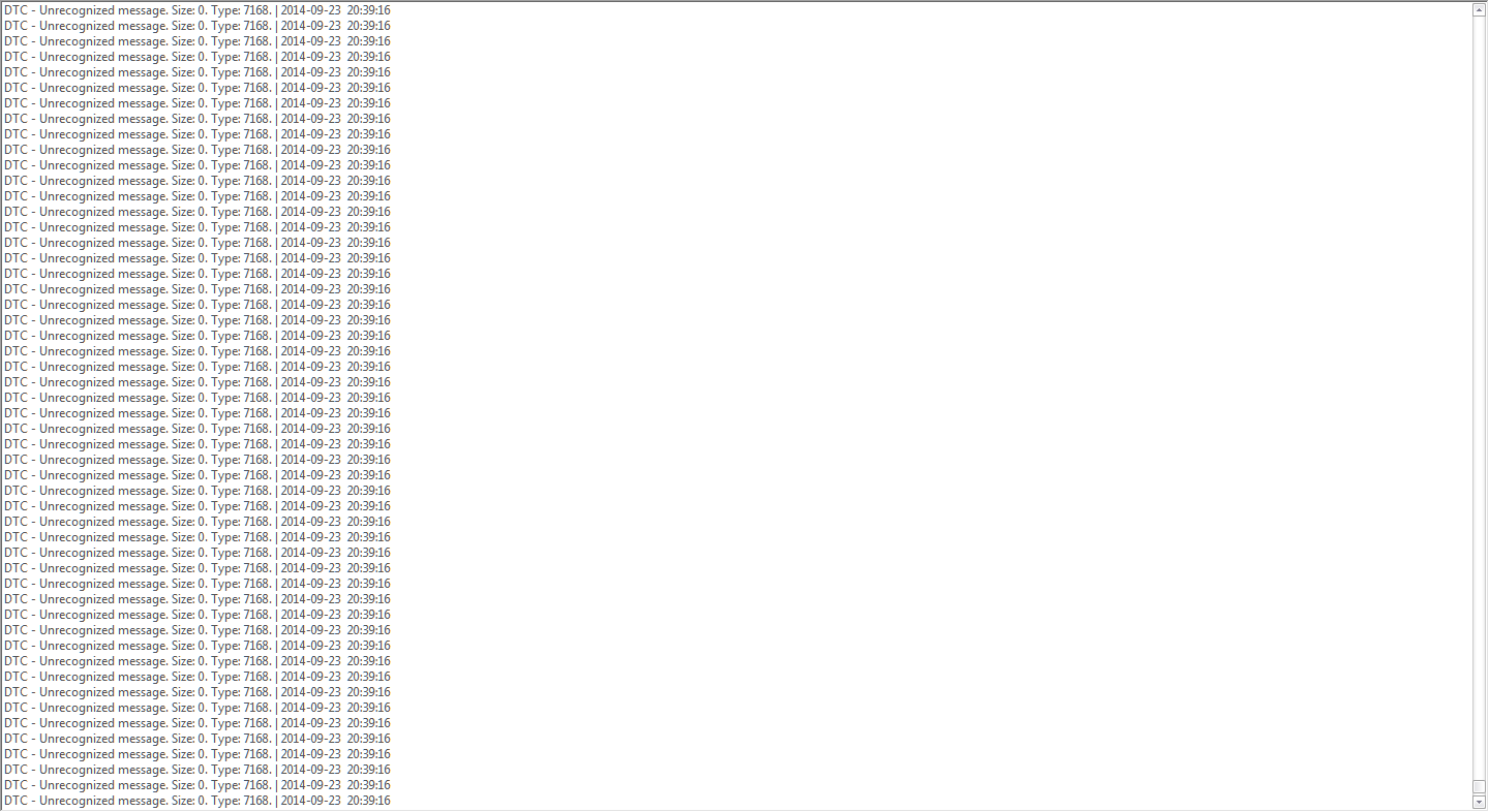

I did some testing and it took me a while before I got the unrecognized messages. I first started with a 5 chart chartbook (365 days loaded), then increased it to 20 charts, then I made the charts continuous, but I still didn't see the message. It was only after I increased the number of days to load to 999 that the "unrecognized message" started to appear.
In the attached log, the first Unrecognized message appears at 20:37:57 (after the loading of SI-201412-NYMEX-USD-5000 charts). Then after loading the CL-chart, the program receives several unrecognized messages (end of file, starting at 20:38:00).
This was my last chance to grab the message log, because after that, the program received loads of Size 0 unrecognized messages and then became unresponsive.
I have attached several files:
1 - The chartbook I created
2 - The message log from opening the CB
3 - A screenshot of the message log after the program became unresponsive
attachmentTest-Unrecognized-Message-2.cht - Attached On 2014-09-23 18:47:54 UTC - Size: 392.98 KB - 645 views
attachmentunrecognized message log.doc - Attached On 2014-09-23 18:48:15 UTC - Size: 686.5 KB - 602 views
image2014-09-23-20-39-18.png / V - Attached On 2014-09-23 18:48:48 UTC - Size: 124.31 KB - 535 views
