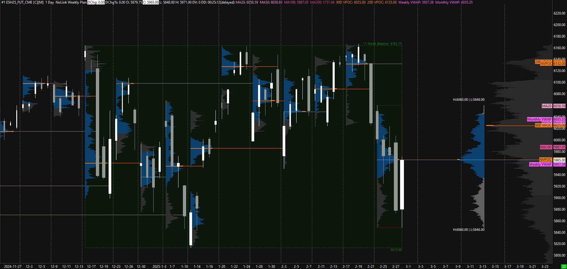

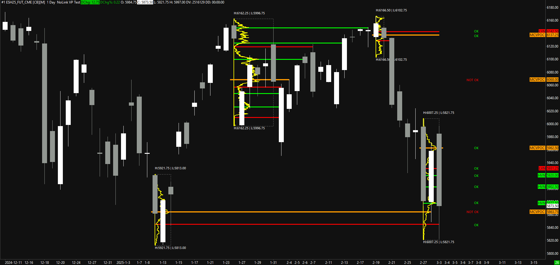

when I draw volume profiles manually the label for an already intersected VPOC will be displayed on the y axis. Interestingly no label will be displayed for peaks and valleys if they are intersected. If you look at my chart I've marked the labels which are ok or not(from my point of view). Is it possible to suppress labels for intersected POCs as you do it for peaks and valleys?
https://www.sierrachart.com/image.php?Image=1740921240746.png
When I use periodic daily or weekly profiles the label for intersected POCs is not displayed on the y axis!
https://www.sierrachart.com/image.php?Image=1740921917367.png
Future Intersection Method is set to chart bars on all profiles.

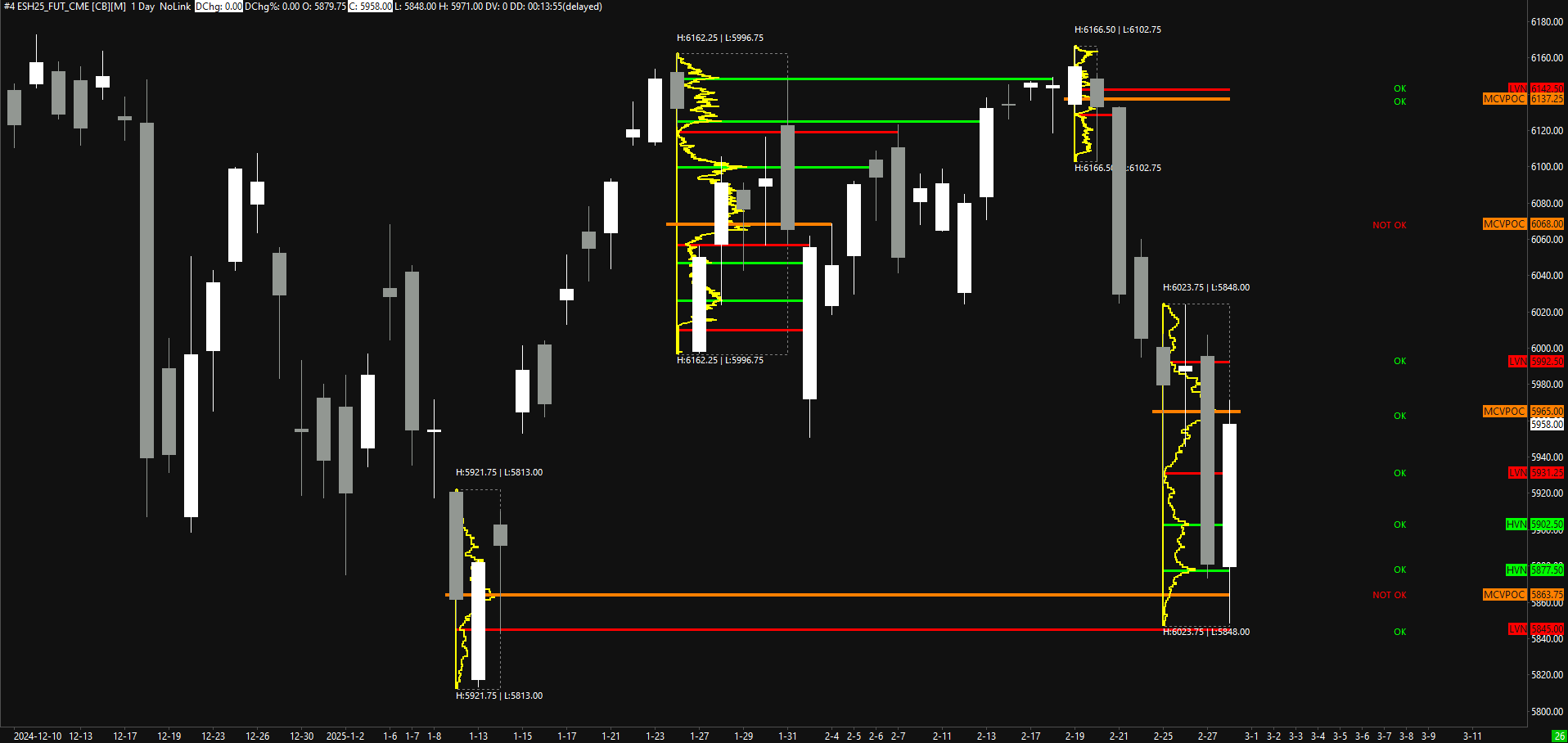

gz6969 - Posts: 51
Please see the attached chartbook. The labels of the MCVPOCs at 6068.00 and 5863.75 are not ok because they are already intersected.
This is how the chart looked at the time I've saved and uploaded the chartbook.
https://www.sierrachart.com/image.php?Image=1741037732816.png
Private File
[2025-03-04 15:59:49]
John - SC Support - Posts: 48142
The reason for what you are seeing is that when you set the Input for "Draw Mode" to be "Volume Profiles & POC, VAH, VAL, VWAP Lines" you will get the Name and Value Label showing, even if the line has been intersected. Since you are extending the lines, you can set the "Draw Mode" to be "Volume Profile" and still have the extension line showing.
