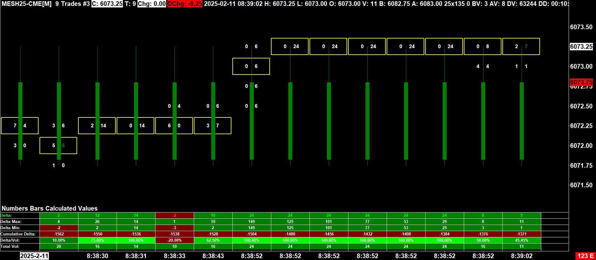

I need to create a footprint mode chart with a tick set to 9 i.e. a candle forms only after 9 ticks.
I tried to follow your instructions but the result is what you see in the screenshot (and it is wrong).

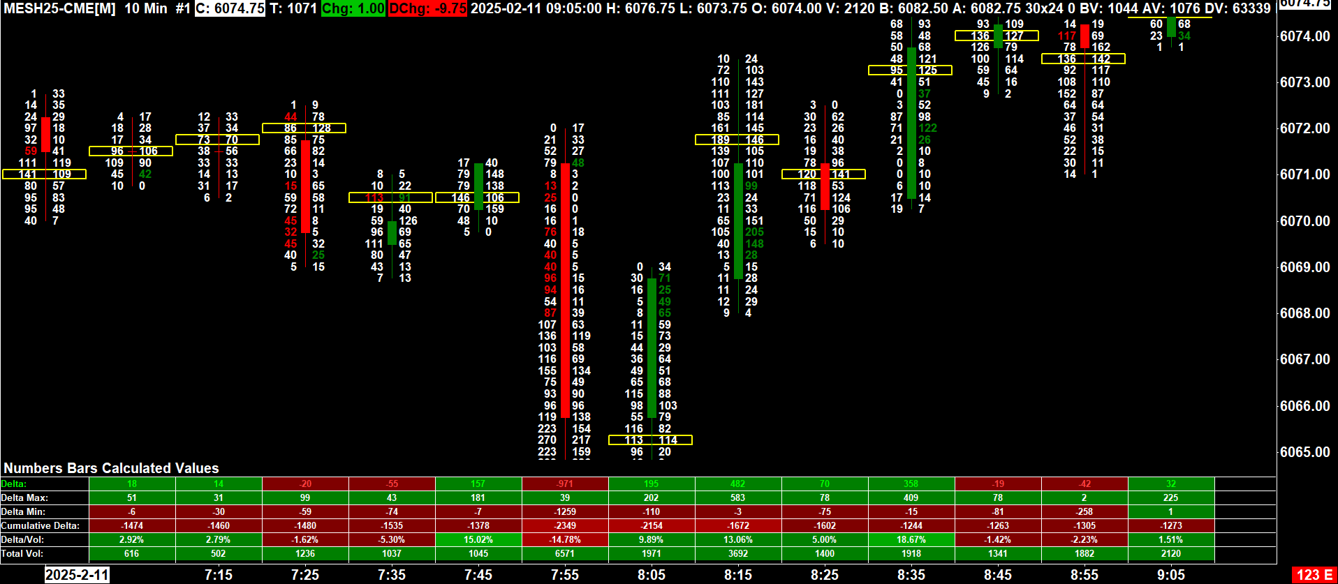

I started by copying the footprint chart I usually use (see photo) and then changed the settings as written in your guide but nothing.
https://www.sierrachart.com/image.php?Image=1739353864865.png
https://www.sierrachart.com/image.php?Image=173935389724.png
[2025-02-12 16:36:23]
If your issue is with regards to the bars that are on the chart, then that is due to your overlaying the bars from a different timeframe chart. You need to overlay the bars from the same chart so that it is the same bar period.
