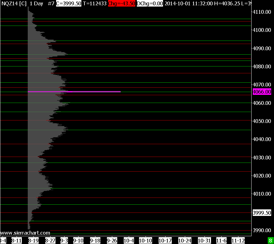

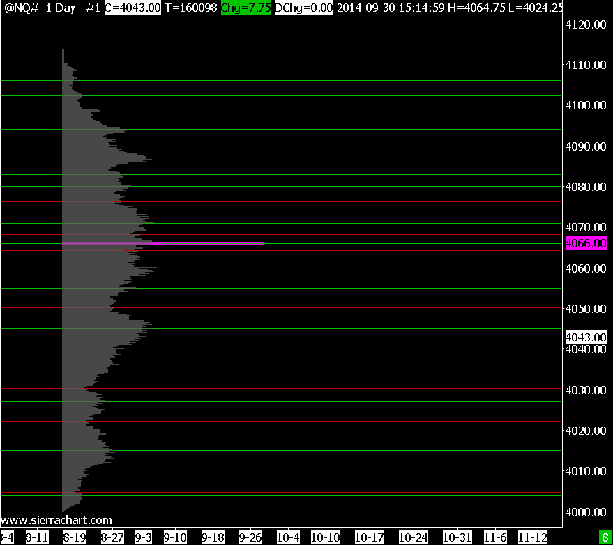

We are going to look into this again. We realize now why the Session Times changed for us and that is because we changed the symbol of the chart.
[2014-10-01 17:04:11]
The correct point of control from 2014-08-18 is 4066. This is what we get with the Sierra Chart Exchange Data feed and IQ Feed:
http://www.sierrachart.com/image.php?l=1412183003453.png
http://www.sierrachart.com/image.php?l=1412183045130.png

Being that the point of control with the Sierra Chart Exchange Data Feed and also with IQ Feed are both the same at 4066, then we can say that that is accurate for the settings that you had.
How can you definitively prove that something is not correct within Sierra Chart? This is quite difficult because of the immense amount of data being calculated. We we are confident the calculations are correct. We are certain that the calculations are correct based upon the settings you are using.
In our tests, we are certain that tick by tick data was being used.
You cannot specify only tick by tick data with IQ Feed, but that is what is being used in the calculation because the point of control matches the Sierra Chart data feed.

We do not think there is any problem with the data from IQ Feed because the same point of control is obtained from the Sierra Chart Exchange Data Feed which is only tick data. So from IQ Feed you must be getting tick by tick data as well for the time period of the volume profile.
We do not really know what more to say about this because we are certain the calculations are correct.
One thing that could be done is to do a volume profile calculation across a smaller period of time and then manually do the calculations to see if it is correct or compare that to your other program.
We have no reason to believe that Sierra Chart is doing anything wrong because the volume at price calculations have been under development for a very long time and is very will debugged by now.

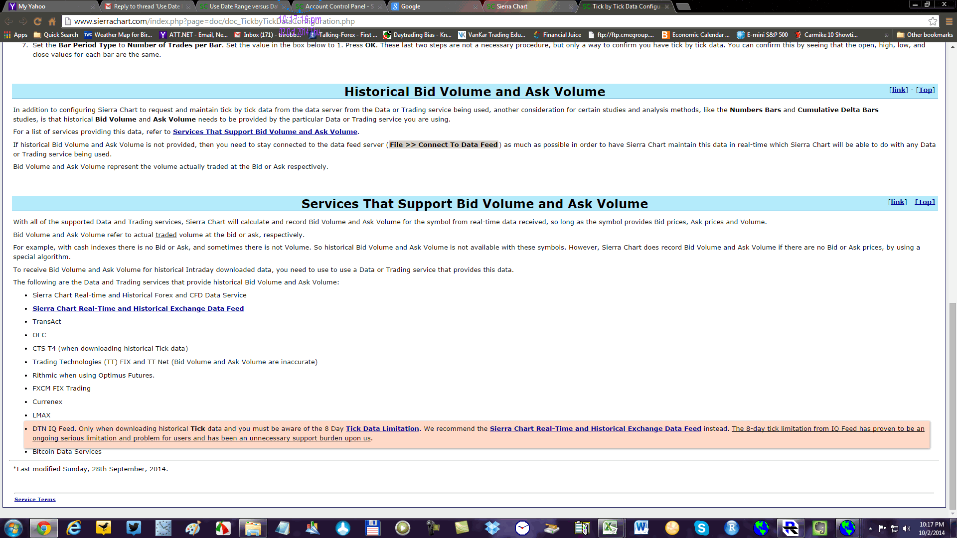

I think I may have found the problem. See screenshot.
imageDTN limitations.png / V - Attached On 2014-10-03 03:18:50 UTC - Size: 97.72 KB - 520 views
[2014-10-03 03:19:54]
RobertL - Posts: 26
I have to have at least 90 to 120 days of Tick data from DTN.
[2014-10-03 04:33:05]
We do not think that that limitation is the problem as long as the data is being downloaded during the evening session hours.
Additionally, we get the very same result using your Chartbook and the Sierra Chart Exchange Data Feed which has complete tick data.
