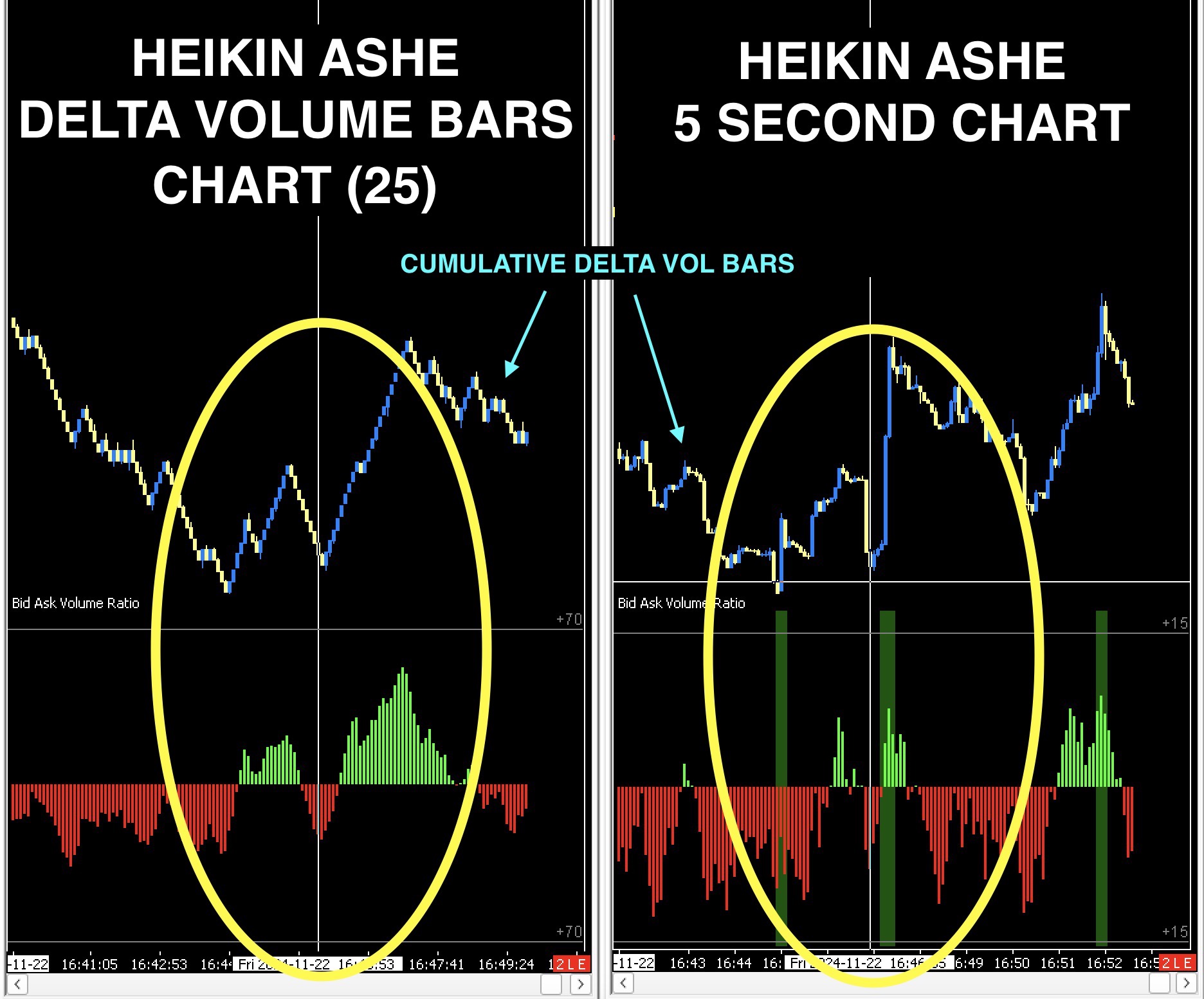

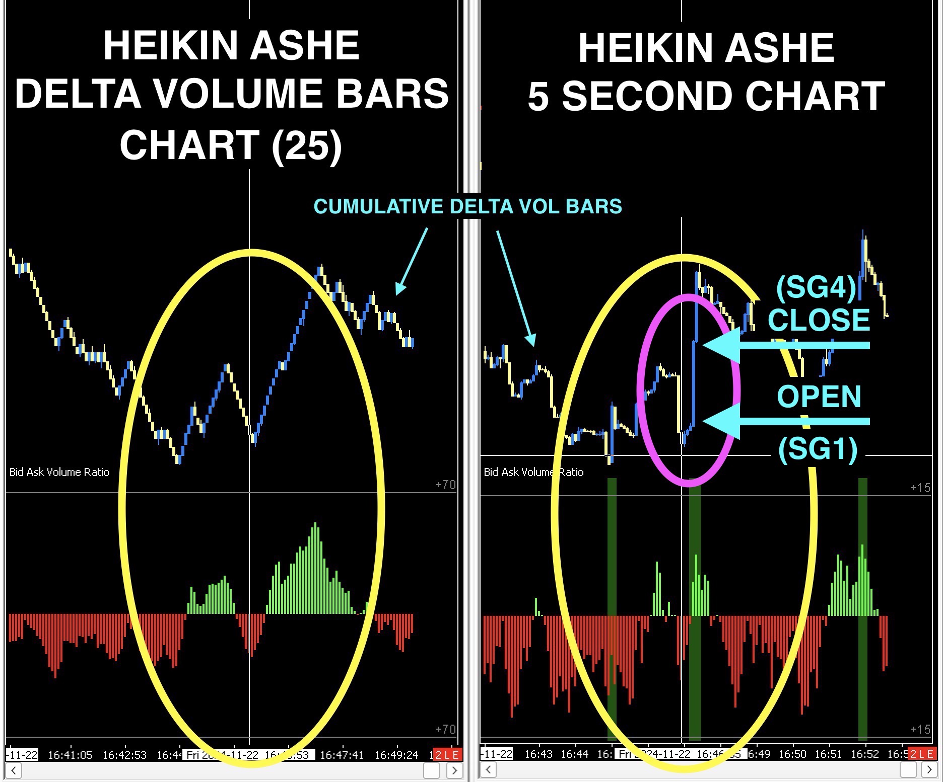

I currently use a Heikin Ashe '5 Second' chart with Cum Delta Bars study and Bid/Ask ratio study and use the 'Colour Bar based on Alert Cond' study alert formula... =AND(V>400, ID9.SG4 > ID9.SG1) for a bar that is above 400 in volume, and the close being higher than the open (on the cum delta bars SG's) for a positive colour bar alert on the Bid Ask Ratio Study. (Screenshot attached for your reference)
I want to switch the chart to a Heikin Ashe 'Delta Volume Bars' with a setting of 25....and have the same Colour bar based alert.

imageCOLOUR BAR BASED ON ALERT CONDITION Screenshot.jpg / V - Attached On 2024-11-26 00:32:35 UTC - Size: 425.2 KB - 172 views

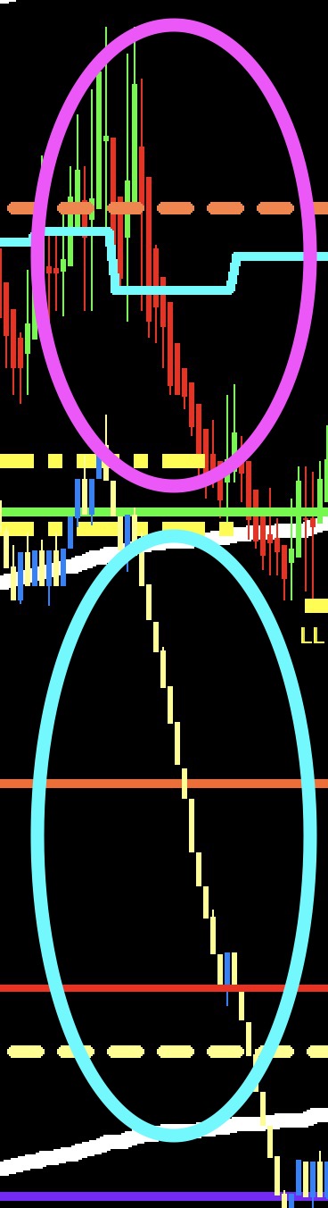

NOTE: From the screenshot attached you can see that the volume comes in much better and earlier on the Cum Delta Volume bars in the Blue circle, than the messy Heikin Ashe Bars in the pink circle which are very choppy at the same area!
Thanks!
Date Time Of Last Edit: 2024-11-26 22:36:49
image1.jpg / V - Attached On 2024-11-26 22:33:21 UTC - Size: 103.53 KB - 249 views
