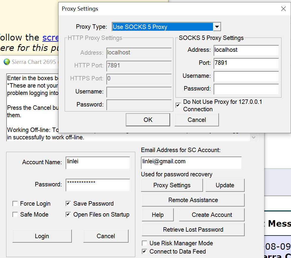

While enabling socks5 proxy as in the screenshot, chat program cannot be connected and data in charts are ok.
Chat program keeps reconnecting.
Without socks5 proxy enabled, everything works good.
image2024-10-22_17-08-29.jpg / V - Attached On 2024-10-22 09:11:59 UTC - Size: 225.42 KB - 238 views
image2024-10-22_17-06-30.jpg / V - Attached On 2024-10-22 09:12:07 UTC - Size: 79.88 KB - 235 views

When using the Socks proxy, all connections are being tunneled through the proxy. The issue would have to be with the proxy not allowing the chat port number which is:
2024-10-22 17:04:06.533 | Chat | Connecting to the server chat2.sierracharts.com. Port 10065
Check the logs on your proxy server and see if you see the connection.
