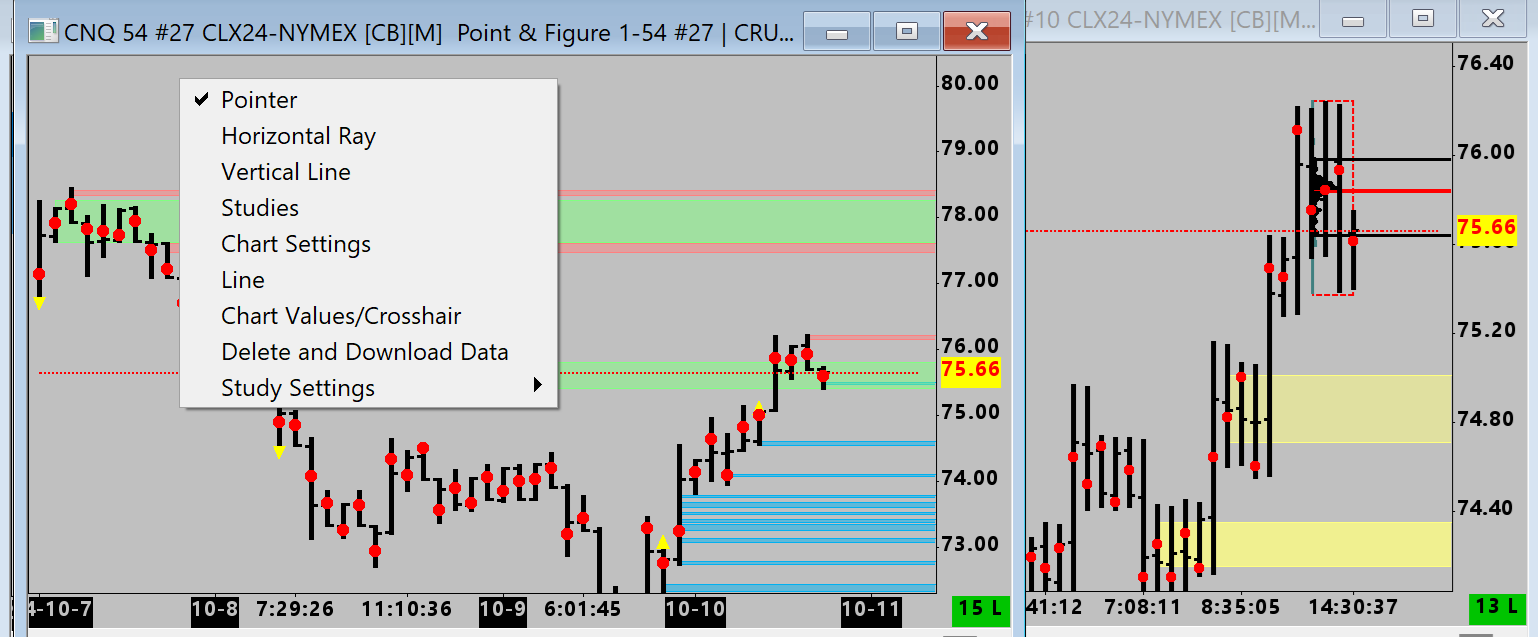

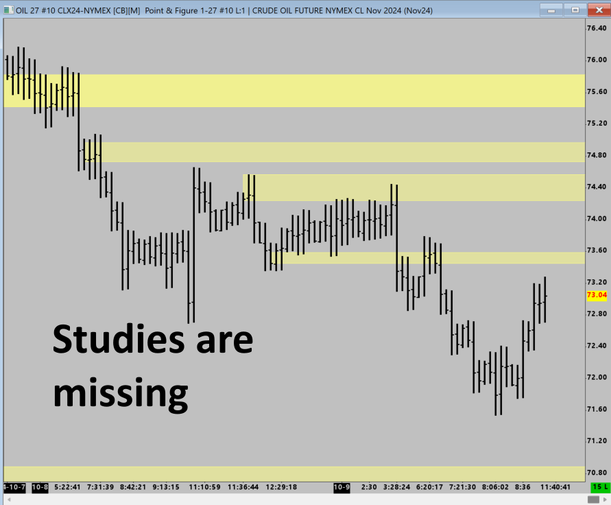

When SC is loaded, all the charts are missing the studies that have been applied to the charts.
When you right click the mouse most of the the options are missing.
This has been going on for over a week.
I've been downloading the newer updates of SC and sometimes it helps and when I shutdown and startup again, the same issue shows up.
I've downloaded the most current version of SC last night and it worked, now this morning it doesn't.
Please see attacked image.
Regards
imageStudies.png / V - Attached On 2024-10-09 16:16:20 UTC - Size: 25.09 KB - 230 views
imageStudies are missing.png / V - Attached On 2024-10-09 16:16:31 UTC - Size: 59.7 KB - 249 views
[2024-10-09 17:56:56]
First, update to the latest release - 2691. This has the issues with right-mouse options, keyboard shortcuts, and menus fixed.
With regards to the studies, we can not say. There is no reason for a study to be missing from your chart. We recommend loading a backup copy of the chartbook by following these instructions:
Chartbooks (Workspaces): Accessing a Backup Chartbook File

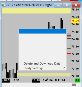

[2024-10-10 15:55:46]
Dan the Man - Posts: 111
Hi John,
Yesterday I did install to release but it still didn't resolve the issue.
So, I re-installed it again and it worked.
That was yesterday.
Today 2024-10-10 When I started SC, it was the same issue, no right click menu and missing studies. It was (release 2691)
I re-installed release 2691 and it's working.
The attached image is from this morning.
Regards,
imageRight Click.png / V - Attached On 2024-10-10 15:54:02 UTC - Size: 25.9 KB - 195 views

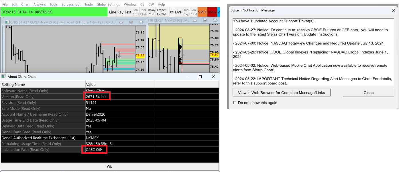

Did you, by any chance, recover and older global settings file (Sierra4.config)? Or did someone share this file with you?
[2024-10-10 23:02:39]
At the end of today's trading day shut down my computer and then restarted and reloaded SC that was updated to release 2691.
The same issue with the right click of the mouse, remains.
So, I re-applied the release 2691 and then the issue was gone.
Then shut down and restarted SC and the mouse issue is back.
I have done this 4 times already so, I know the issue remains.
Regards,
imageMouse Issue.png / V - Attached On 2024-10-10 23:02:03 UTC - Size: 135.23 KB - 182 views
imageNo mouse issue.png / V - Attached On 2024-10-10 23:02:11 UTC - Size: 81.35 KB - 239 views

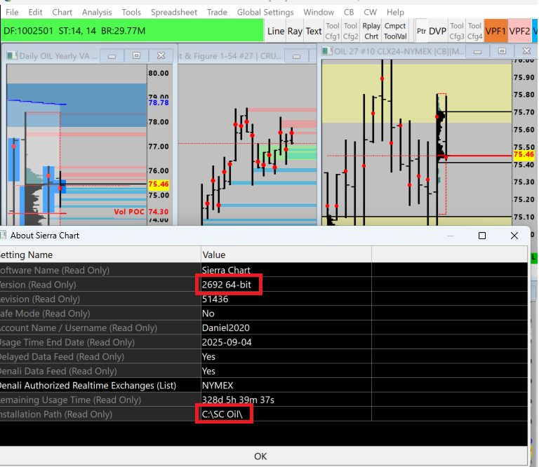

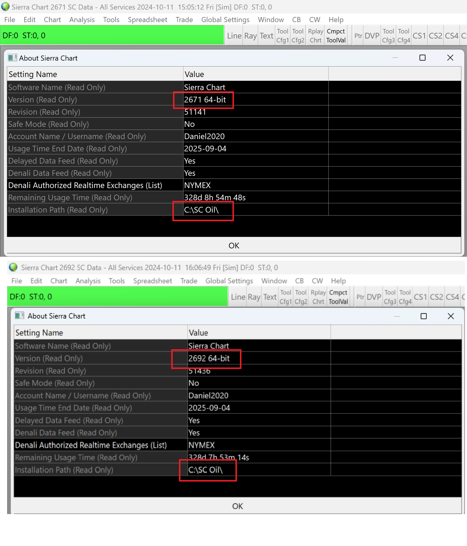

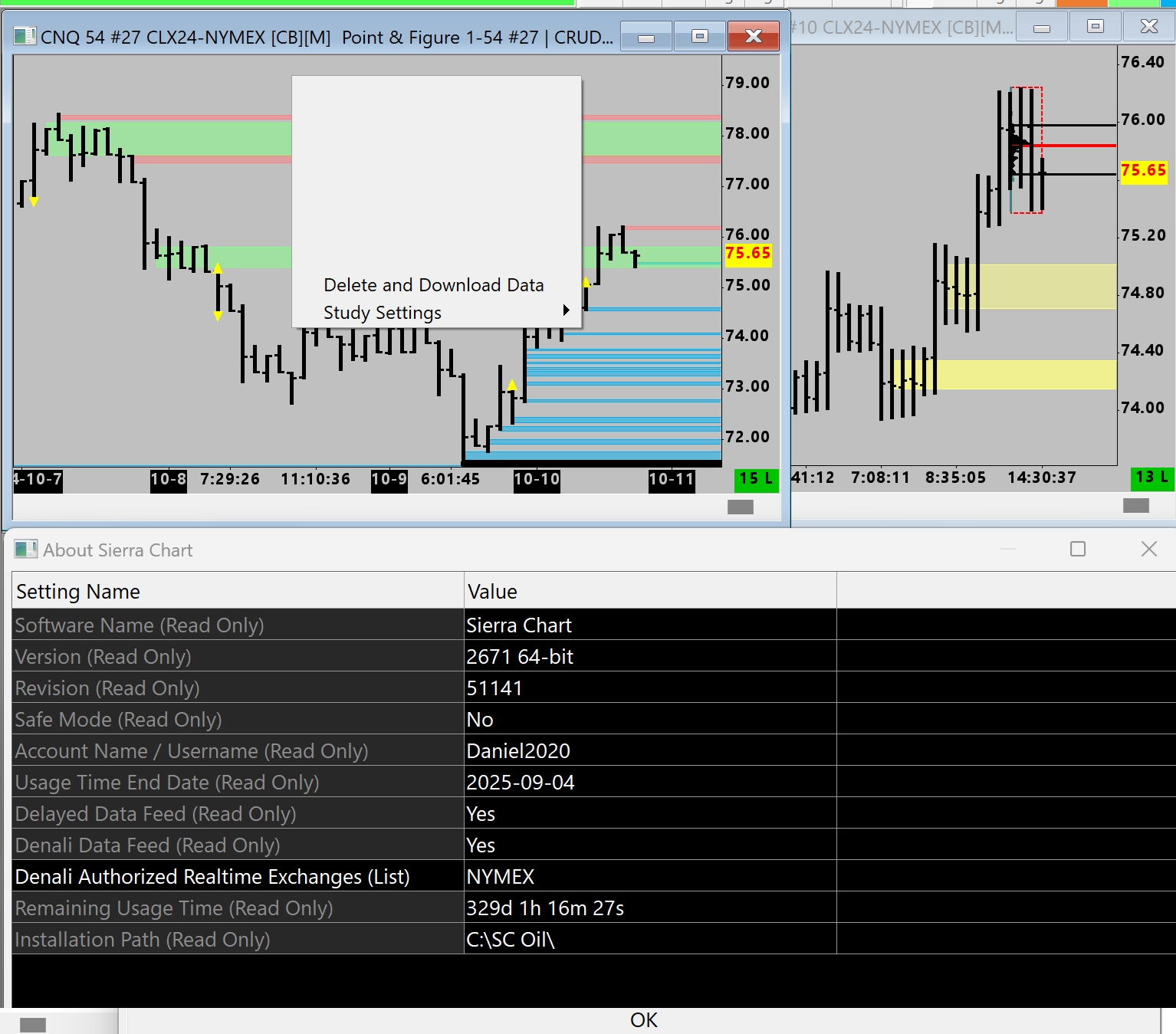

In the image you provided where the right-mouse options are not showing properly, the version shows as 2671 (not 2691). Do you have multiple installations of Sierra Chart, where one is on an old version?
[2024-10-11 16:13:02]
Hi John,
In the "SC Oil" that I do use there were 2 instances that I deleted. That did not help.
When I shut down and re-started SC, it opens up again in release 2671
In the attached image, I highlighted the path folder and the version #.
Somehow the update is not being saved and applied.
Regards,
imageNo Update.png / V - Attached On 2024-10-11 16:09:46 UTC - Size: 229.81 KB - 217 views
[2024-10-11 18:14:40]
We are a bit stumped by this, as typically this situation occurs when there are multiple installations, but you definitely show that both versions are in the same installation folder. Additionally, this could not be caused by another program, as once the new version is installed, the old executable is gone. So there is no way that it could be restored.

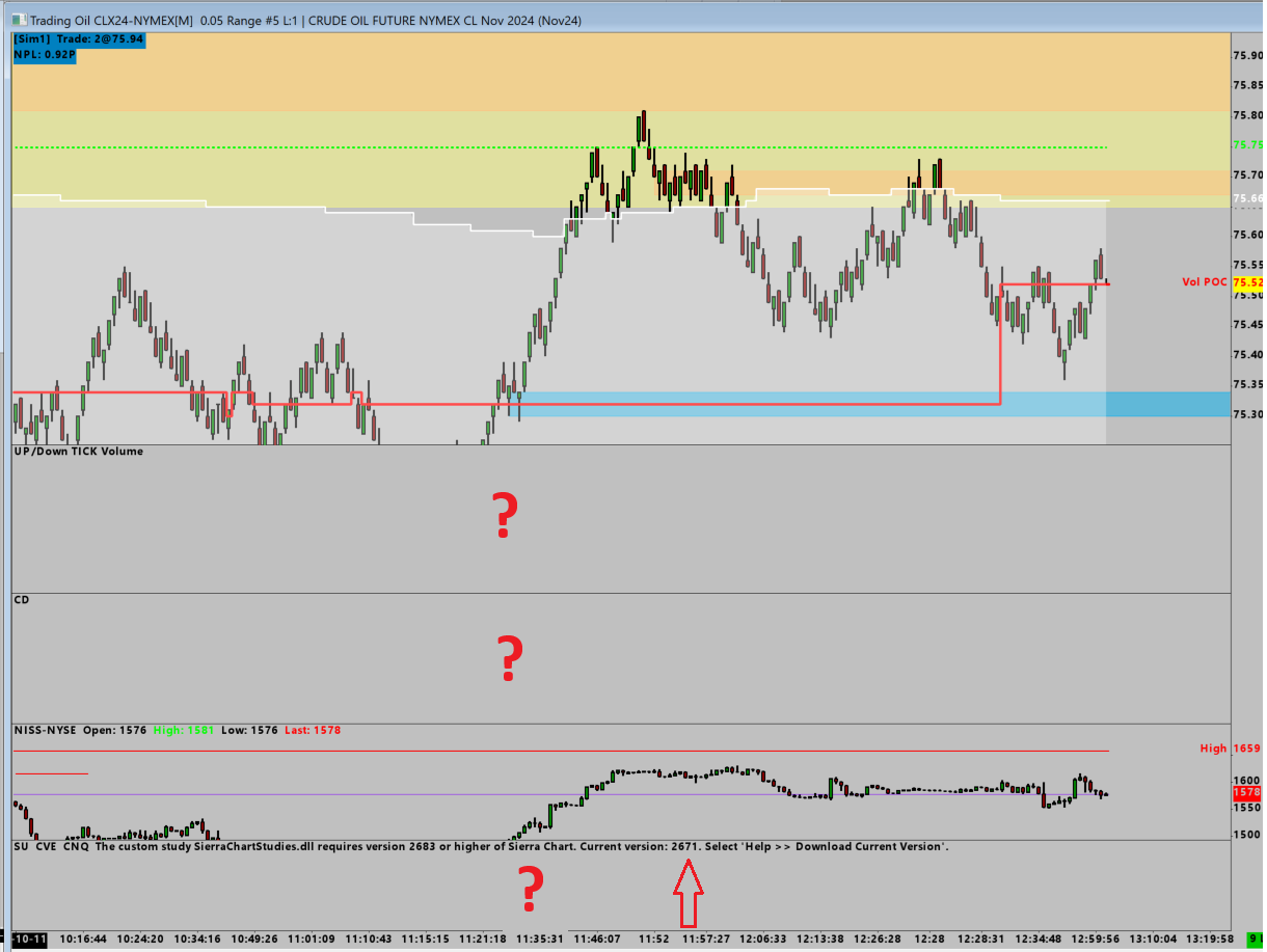

[2024-10-11 18:51:13]
Hi John,
I "shut down and re-started the PC" and then opened SC.
When I start SC there is no message regarding this.
I added a image showing the start message that I always receive.
I added 2 images, showing the update version and the shut down the computer and restarted SC
Regards,
imageBefore shut down.png / V - Attached On 2024-10-11 18:49:33 UTC - Size: 143.33 KB - 215 views
imageAfter shut down and restart.png / V - Attached On 2024-10-11 18:49:42 UTC - Size: 204.08 KB - 149 views
[2024-10-11 19:08:57]
Hi John,
I restart the PC and SC.
I started up in release 2671. Plus the studies are not displayed as per the attached image.
Regards,
imageAfter shut down and restart - 1.png / V - Attached On 2024-10-11 19:08:36 UTC - Size: 94.75 KB - 181 views

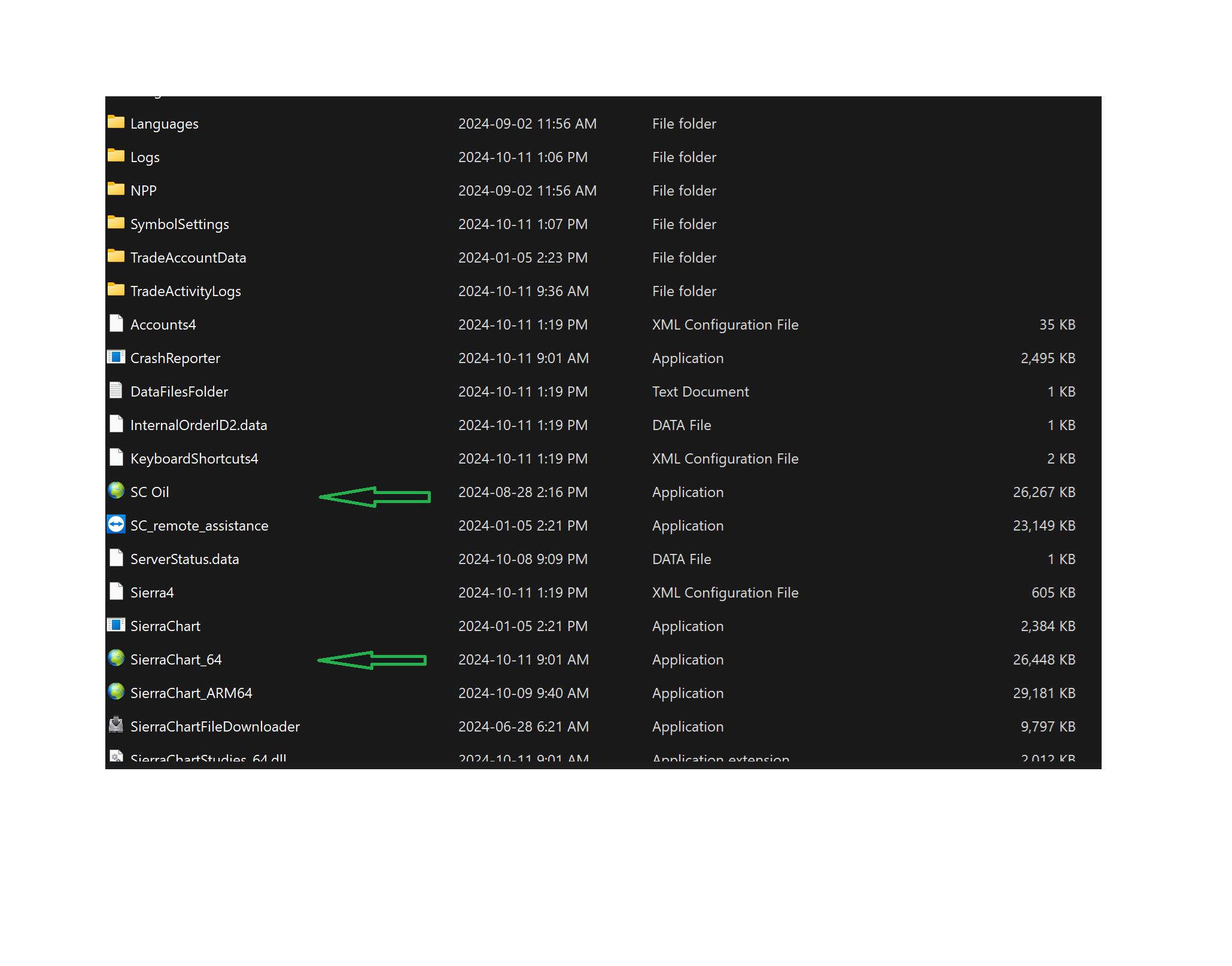

Found the problem
I have a shortcut on my desktop called "SC Oil".
I decided to look in the "SC Oil" folder and there is also another SierraChart_64 besides the SC Oil.
When I open "SierraChart_64", it loads to the correct version but not "SC Oil"
I have been using the desktop shortcut for over 5+ years and have never had a issue like this.
Regards,
imageFound the problem.png / V - Attached On 2024-10-11 19:28:39 UTC - Size: 191.26 KB - 228 views
[2024-10-11 19:32:37]
Ah ha!!! Very good.
