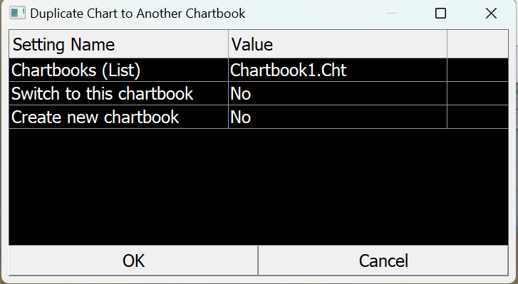

The attached image is what you should see when you select "Duplicate Chart to Chartbook". At the very top is the option to select the chartbook you want to copy to.
If you are not seeing the option to select the chartbook, then resize the window by selecting corner and making the window larger. It may be that the item is hidden from view for some reason.
The option for "Switch to this chartbook" makes it so the system will change you to the chartbook you are copying the chart to. The option for "Create new chartbook" creates a new chartbook to copy the chart into, rather than using the selected one.

But figuring it must be me that is reading the your instructions wrong, so I started to tap round the box again and yes there it is, the drop down menu of open chartbooks.
Hooray! All is good, thank you. But can I make a plea for all the knumb sculls like me. If you had said, "in the Value column next to Chartbooks(List) Tap here for a dropdown list of open chartbooks, select the one you wish to duplicate to" I would have known what it was you were trying to tell me and that is the thing, you knew what you were telling me, but I didn't. And I find this so often when reading the help/how too sections. They are written by people who know how to do something, but I think the writer often forgets that the person reading the instructions is here because he/she doesn't know how to do that same something. If the line I have suggested was to be inserted into the instructions in the Using Chart Template section, I wouldn't have been baffled and you wouldn't have been bothered.
