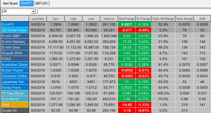

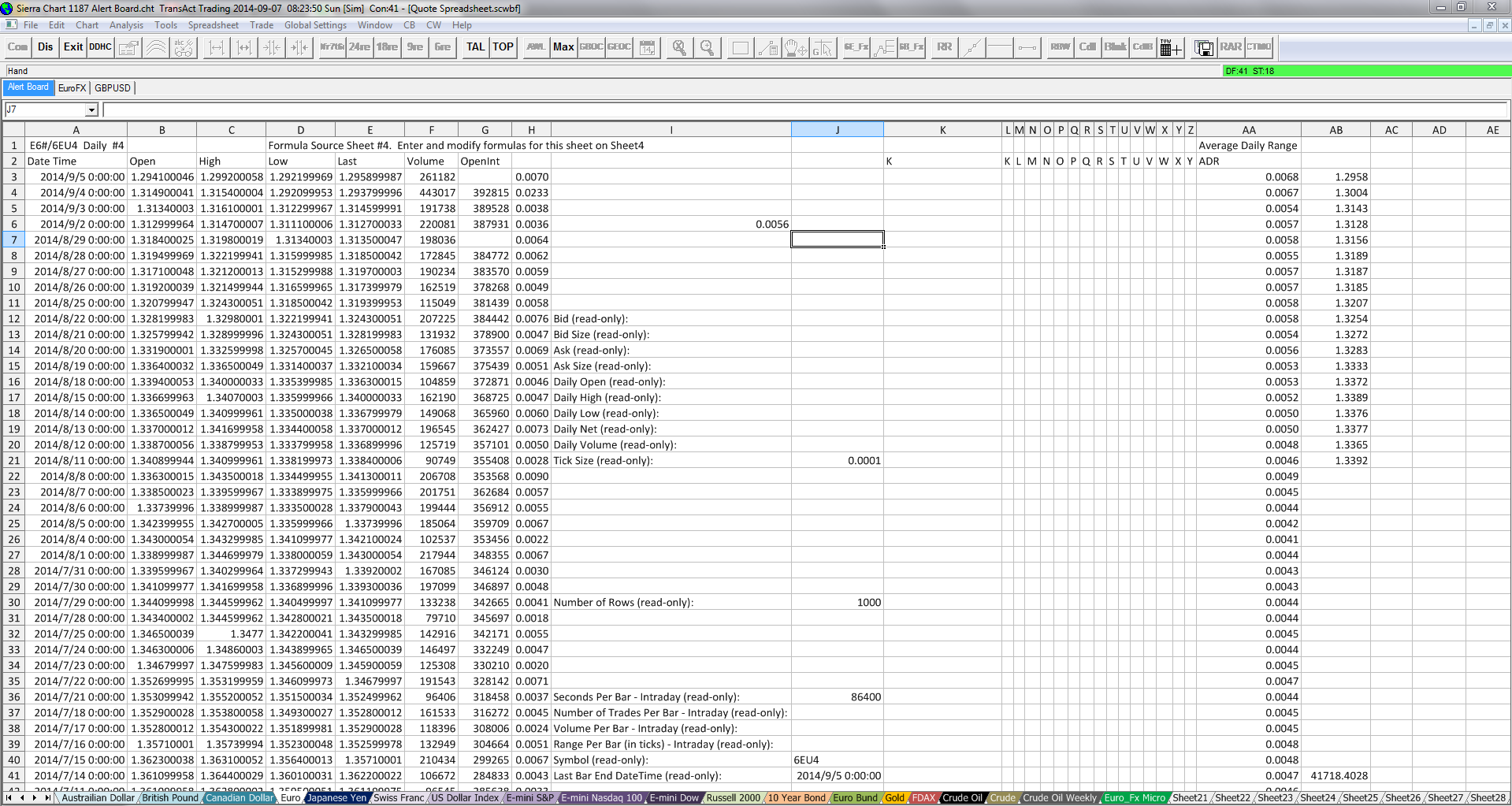

abrown8703 - Posts: 64
I've been having similar issues with spreadsheets as well. A quote board that I created years ago is a total mess now. Chart output data is being sent to wrong sheet #. Please advise.
[2014-09-07 09:40:05]
We need more information about the problem. It is far from clear.
You make mention of a Quote Board and then you talk about chart output data. Are you using the Spreadsheet Study?
[2014-09-07 12:30:53]
Each instrument listed on quote board(see image) has a separate daily chart with "spreadsheet study." That Data then is sent to a spreadsheet that then feeds the Quote Board spreadsheet. Very simple. A few days ago for reasons I am not sure of, data started to be sent to the wrong sheet # thus my Quote Board spreadsheet data was all wrong.
image1.png / V - Attached On 2014-09-07 12:29:55 UTC - Size: 276.98 KB - 624 views
image2.png / V - Attached On 2014-09-07 12:30:03 UTC - Size: 58.04 KB - 651 views

We apologize for the late reply on this.
We think this has to do with adding and deleting Sheets and affecting references to existing Sheets. This is thoroughly documented in this section here:
https://www.sierrachart.com/index.php?page=doc/doc_SpreadsheetStudyInputs.html#OutputSheetNumber
