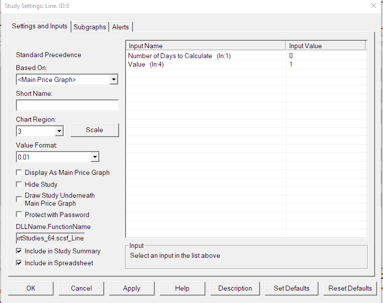

I have been trying to find the Source Code for the Line study.
A picture of the line study settings form is attached.
I want to add the ability to draw a line at the bar Low price at a specific time.

imageLine Study.PNG / V - Attached On 2024-10-06 16:33:41 UTC - Size: 27.88 KB - 237 views

gcUserStudies - Posts: 146
Using the study name you posted... You can search each Studiesx.cpp file in the ACS_Source directory. Example, I searched for scsf_Line. I'm showing it's in Studies7.cpp

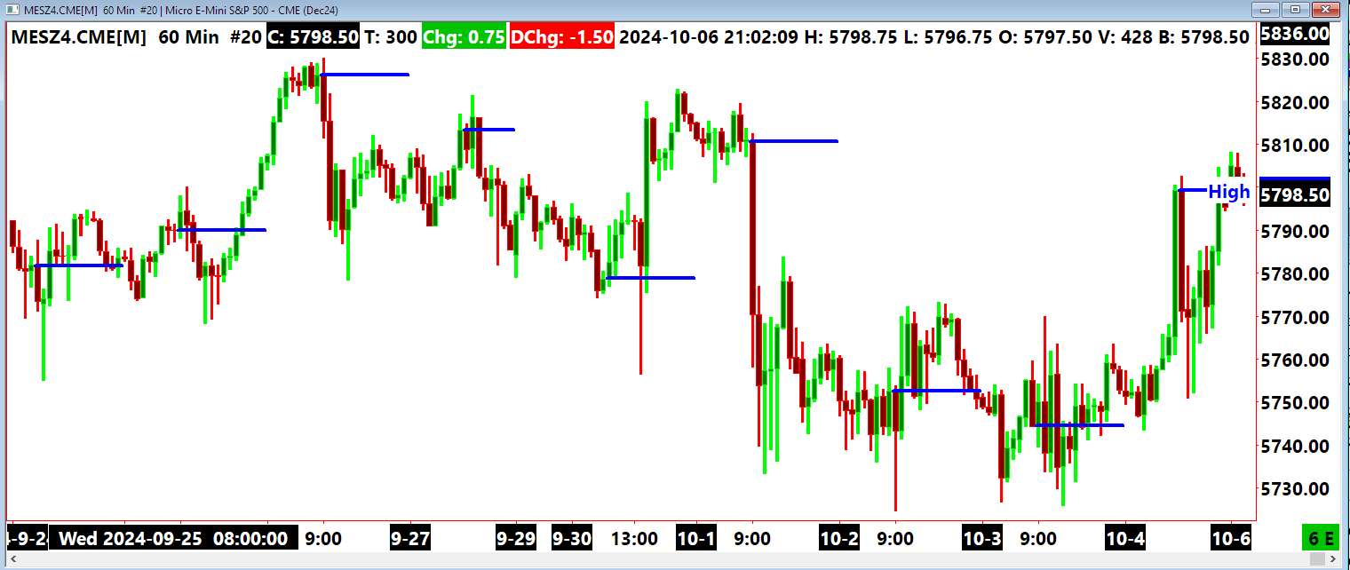

The High/Low for Time Period - Extended study gives me what I need.
I set the start time and end time the same.
Set the input data high and input data low the same.
I hid the low subgraph.
That works perfectly.
But I can't get the stair step line to extend into the next day and beyond.
Any thoughts on that from anyone?
I want to be able to see the previous price lines extended to the right edge of my chart going back days and even months.
Screenshot attached
Date Time Of Last Edit: 2024-10-07 01:04:12
imageLine Study2.PNG / V - Attached On 2024-10-07 01:02:53 UTC - Size: 78.15 KB - 219 views

Does anyone have any suggestions on how to get the High/Low for Time Period—Extended study to extend previous price lines to the right edge of my chart?

User431178 - Posts: 910
No, you would need to modify it to do that.
Any of the following could work:
1. Include subgraph pairs (hi/lo) for D-1, D-2 etc (up to D-29), so 30 days of hi/lo.
2. Include an option to set for D-n, then add multiple copies of the study for each D-1, D-2 etc.
3. Use chart drawings to display the hi/lo for each period.
Sierra Support can this be done with this study?
Not Sierra support, but no, you only have two subgraphs, high and low, and it does not allow you to set for n-periods back.
