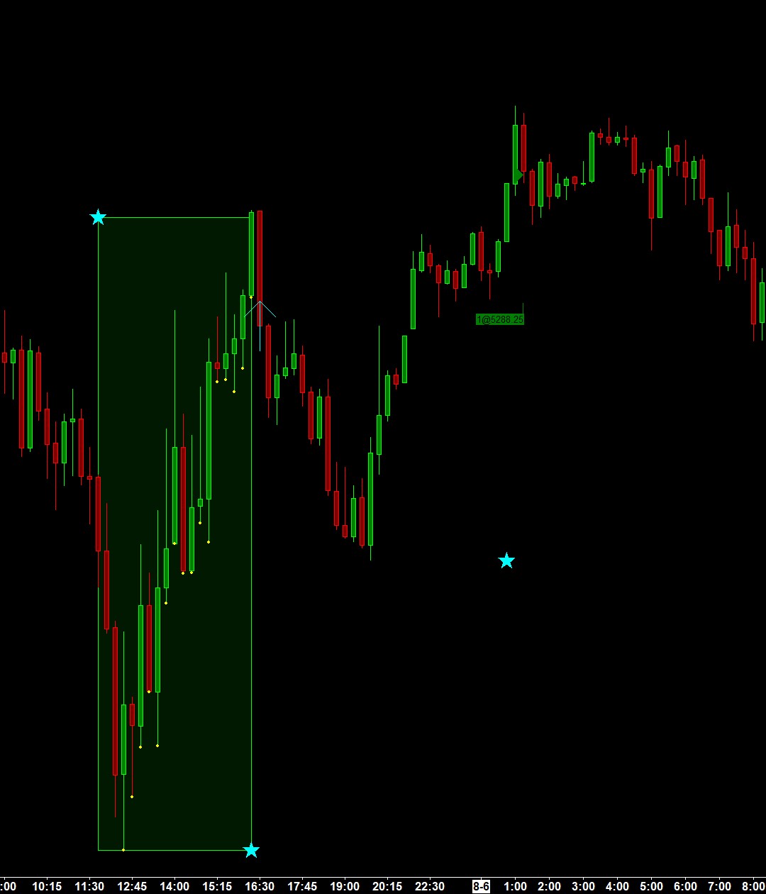

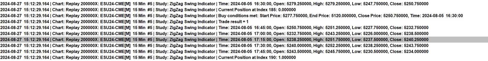

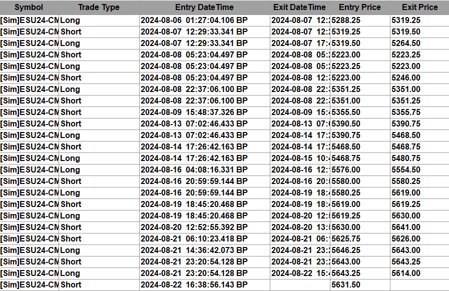

The first trade in the backtest should be taken on 8/5 at 16:30 (15m chart). I've attached 3 images. My message log, the picture of the chart, and the trade activity log.
In the message log, you'll see that a message printed saying buy conditions were met, and the trade result printed as 1 (successful). The current position 5 minutes later also shows long 1 contract.
In the chart image, you'll see a light blue arrow at the time the trade was SUPPOSED to be taken. However, you'll also see the green triangle much later on at a different price displayed by the show orders / fills setting.
Lastly, in the trade activity log, you will see no trade taken on 8/5 at 16:30.

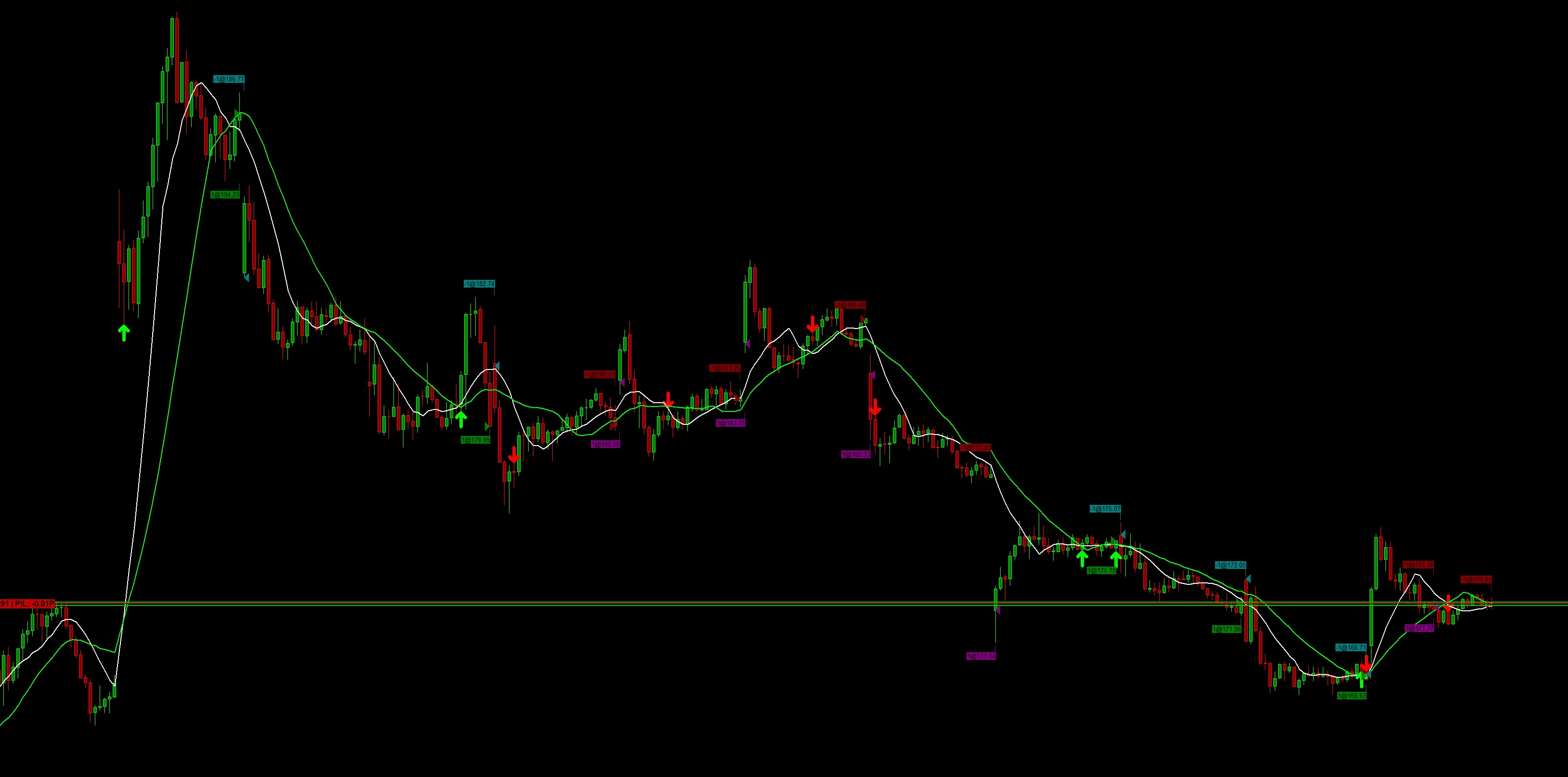

Hello. I have done some further digging, and am running into even more curious problems.
I tried running a strategy of mine in a backtest that I know previously worked as I had expected. I was running into similar issues now, of the trades listed being totally inaccurate. So, I then tried using one of Sierra's templated strategies, since those surely should work correctly. And, in doing a Replay BackTest, I once again ran into the same problem. I've attached a picture of a TSLA chart with Sierra's template moving average crossover strategy run on it. Please note that the green / red arrows displayed by the strategy itself do not match the order markers.
I will try uninstalling and reinstalling Sierra, to see if that helps. Will report back what happens.
imageSierra TSLA inaccuracy.jpg / V - Attached On 2024-09-04 01:07:42 UTC - Size: 304.26 KB - 248 views

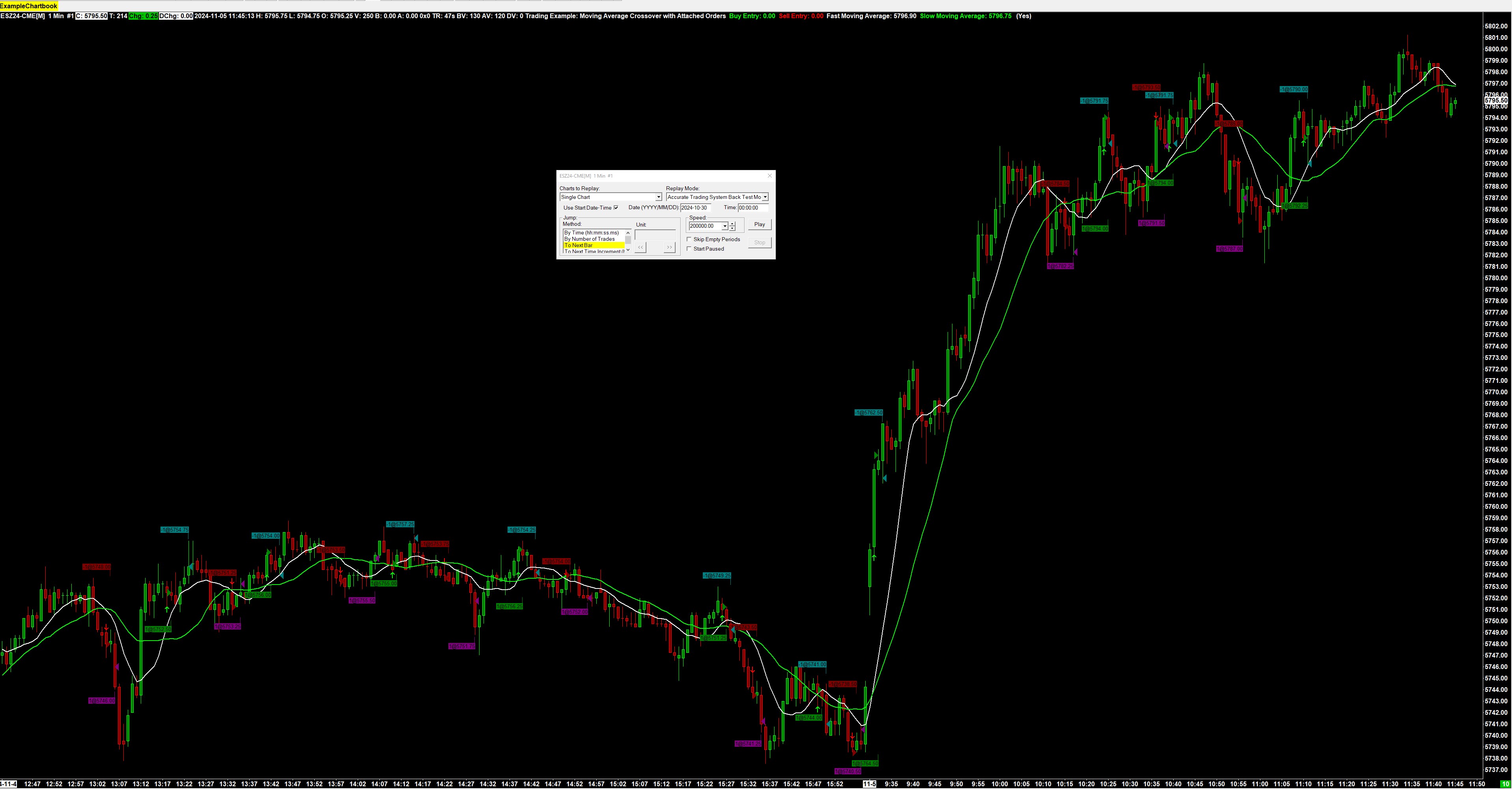

I've attached a picture of the results from another Replay Backtest using Sierra's MA Crossover strategy on a 15m TSLA chart. Similar inaccuracies remain. Please do let me know what you discover in your testing -- I look forward to resolving this issue and getting back to some development using Sierra's incredible software!
Thanks,
PS
imageTSLA Sierra MA Backtest.jpg / V - Attached On 2024-09-06 11:49:06 UTC - Size: 580.65 KB - 197 views

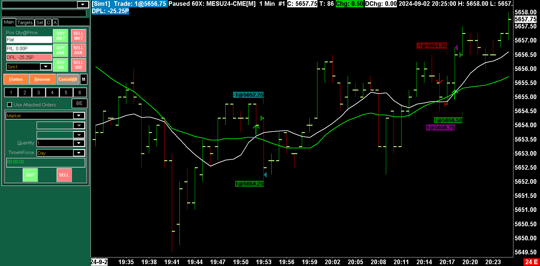

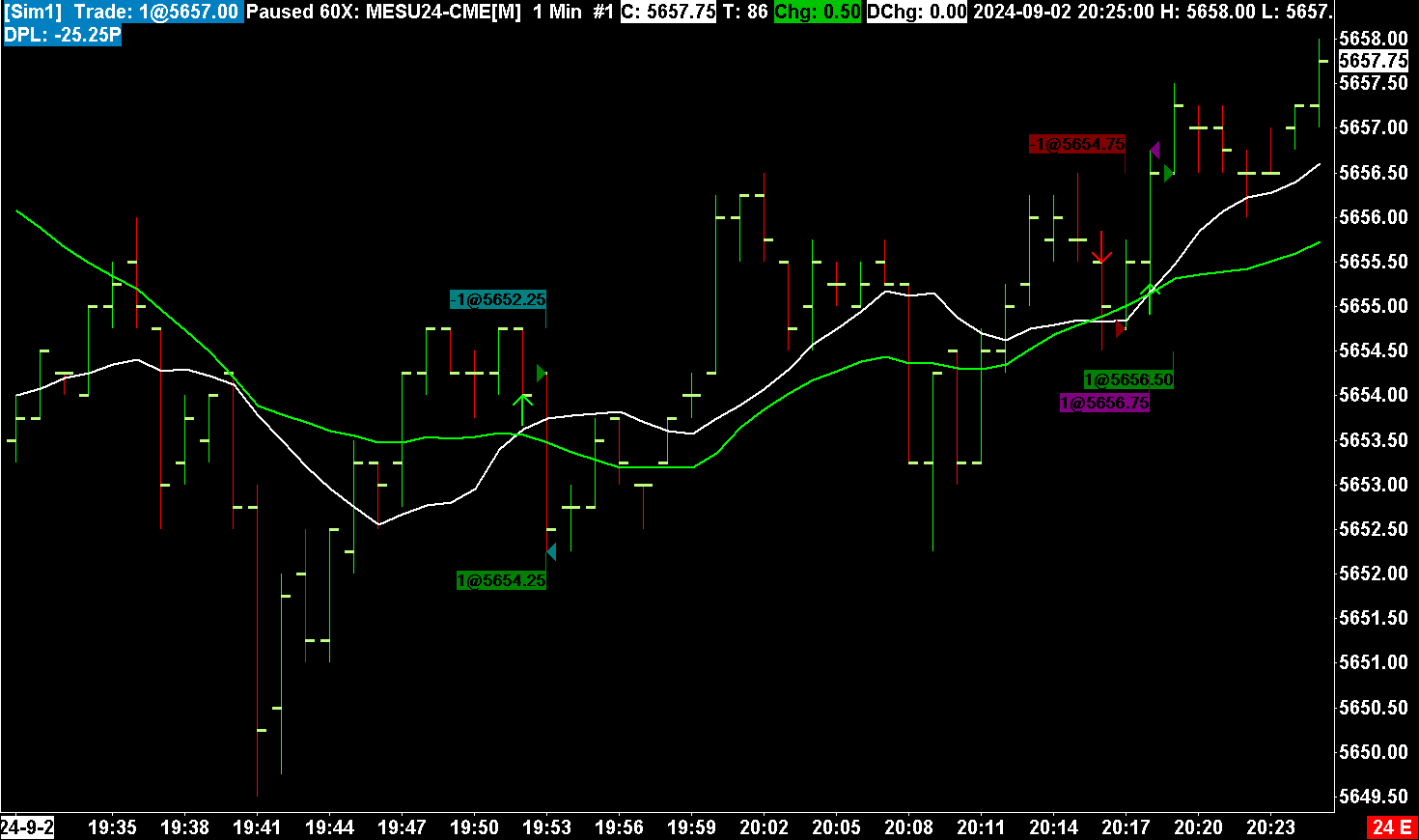

We did not do any testing yet until now. We need to know precisely the name of the study you are using for this:
We tested just now: Trading Example: Moving Average Crossover with Attached Orders
Here is what we see at a portion of the chart:
https://www.sierrachart.com/image.php?Image=1725887452256.png
We did not observe any issues looking at some of the order fills. One thing to understand, is that the exit order which is done by an Attached Order is not going to have any arrow on the chart. You just see an order fill on its own for it.
We apologize for the colors. They are not the best.
One thing that we did though is we paused the back test in the current state. Maybe there is an issue, when the back test completes and then later if there is a full recalculation of the study the arrow placement is different. Then we need to examine why there is a difference in that case.

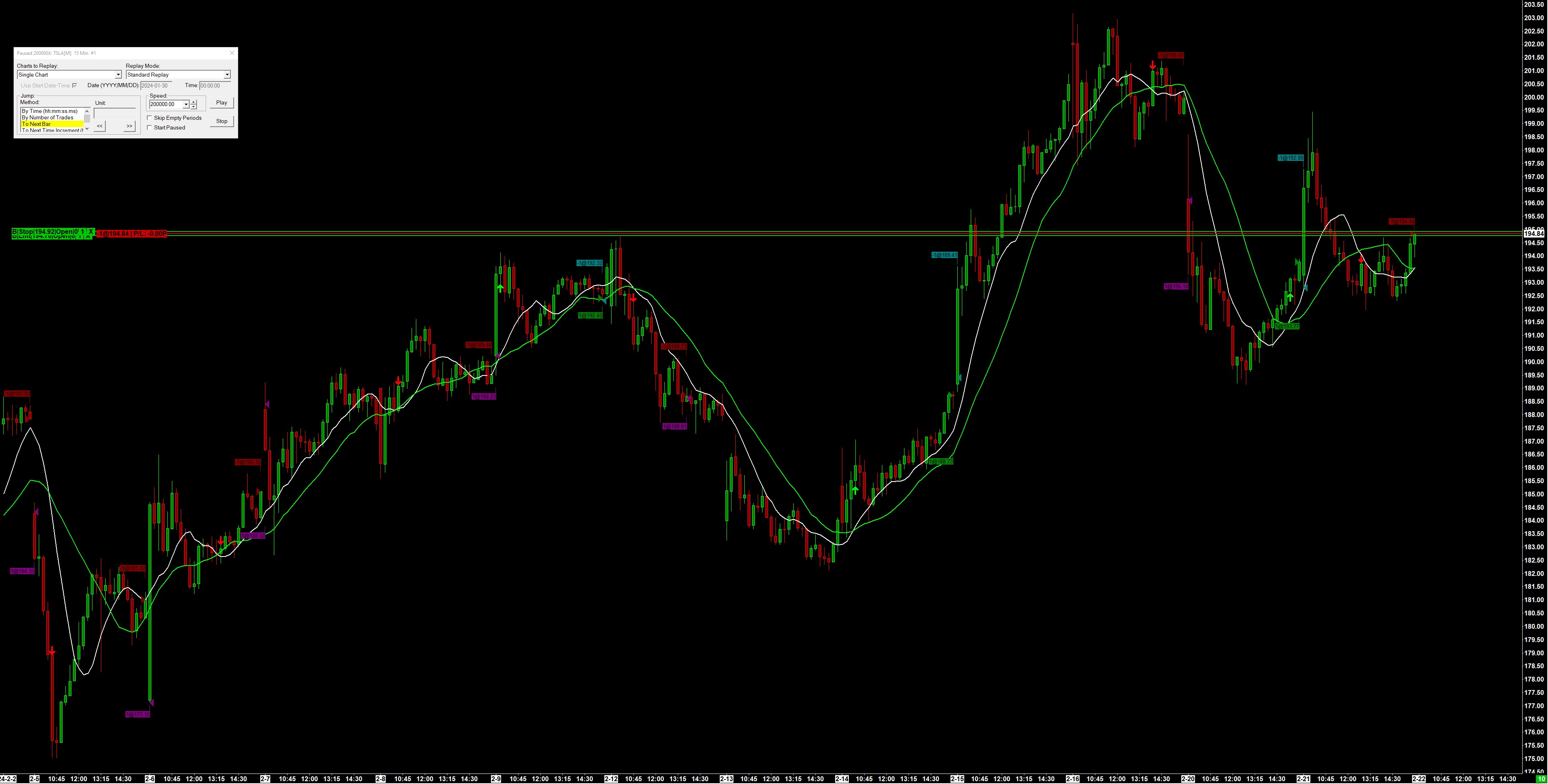

Hello. Apologies for the late reply. I tried following as mentioned, switching to Accurate Mode, and orders are still incorrect. Attaching picture here. Orders should simply be made on the moving average cross, as per Sierra's Trading Example MA Crossover strategy code.
imageSierra Accurate Mode.jpg / V - Attached On 2024-11-05 16:55:23 UTC - Size: 612.15 KB - 158 views

User431178 - Posts: 910
Picture looks normal and correct.
That system enters on close of bar.
Where do you see errors?
