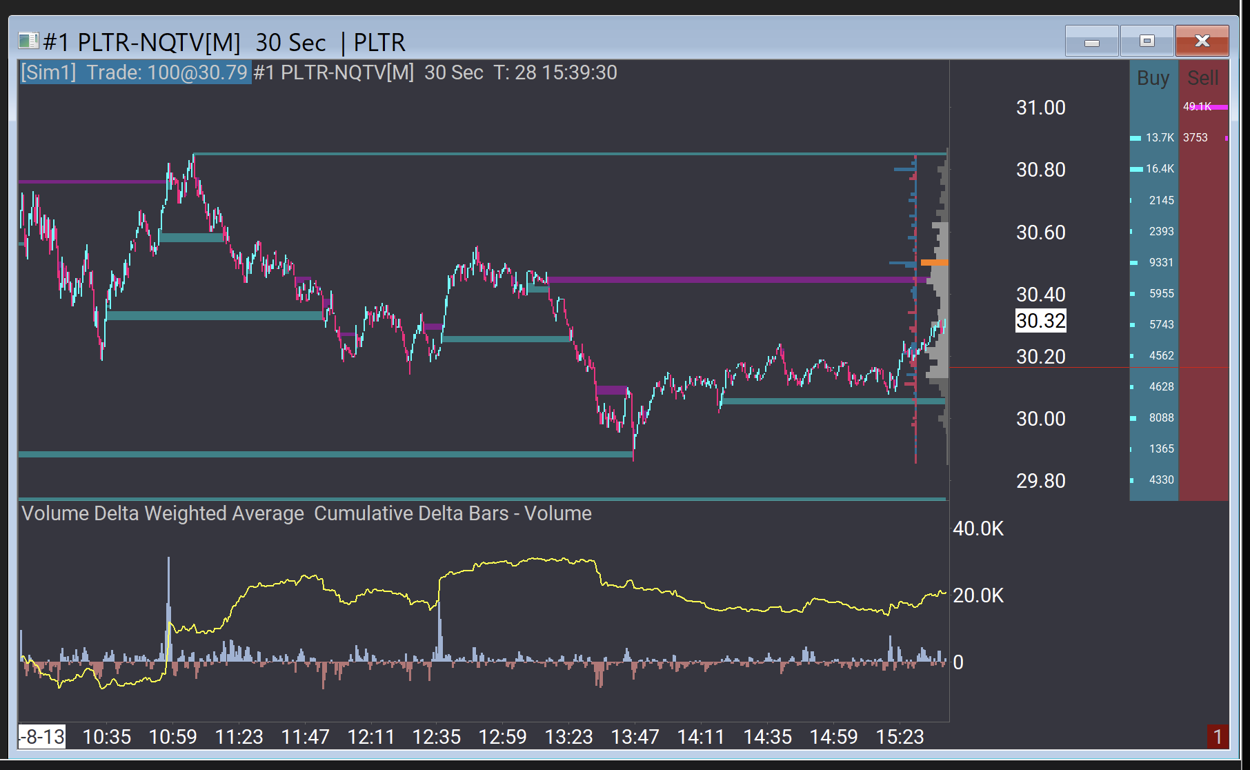

sean3000 - Posts: 65
I have a study in a lower region with values that can become very large, so I prefer to set this study's value format to Large Integer with Suffix.
However, doing this causes the main region's price column to become much wider than the price text.
Is there any way to address this?
imageScreenshot 2024-08-13 at 9.36.01 AM.png / V - Attached On 2024-08-13 15:57:10 UTC - Size: 167.91 KB - 234 views

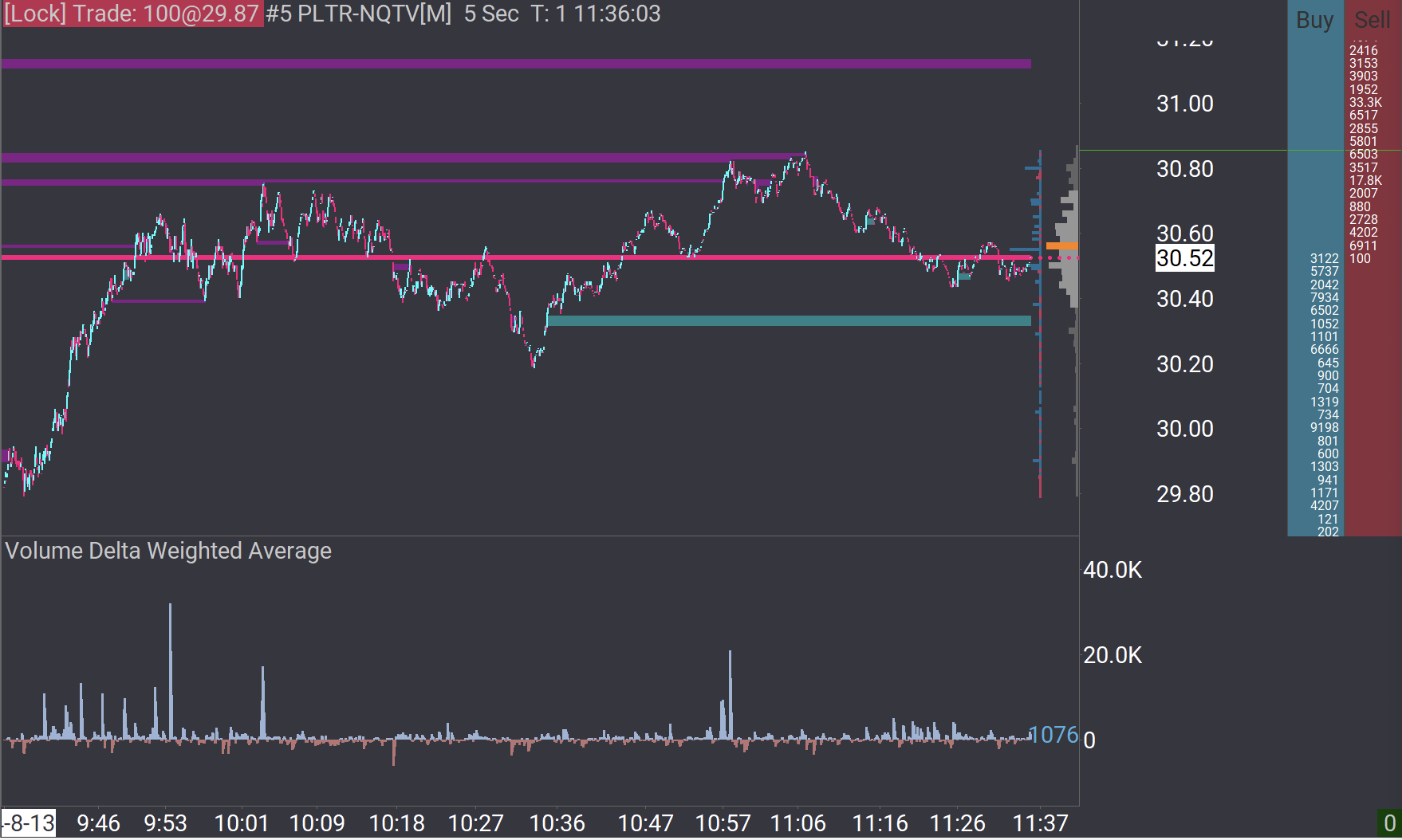

[2024-08-13 16:34:25]

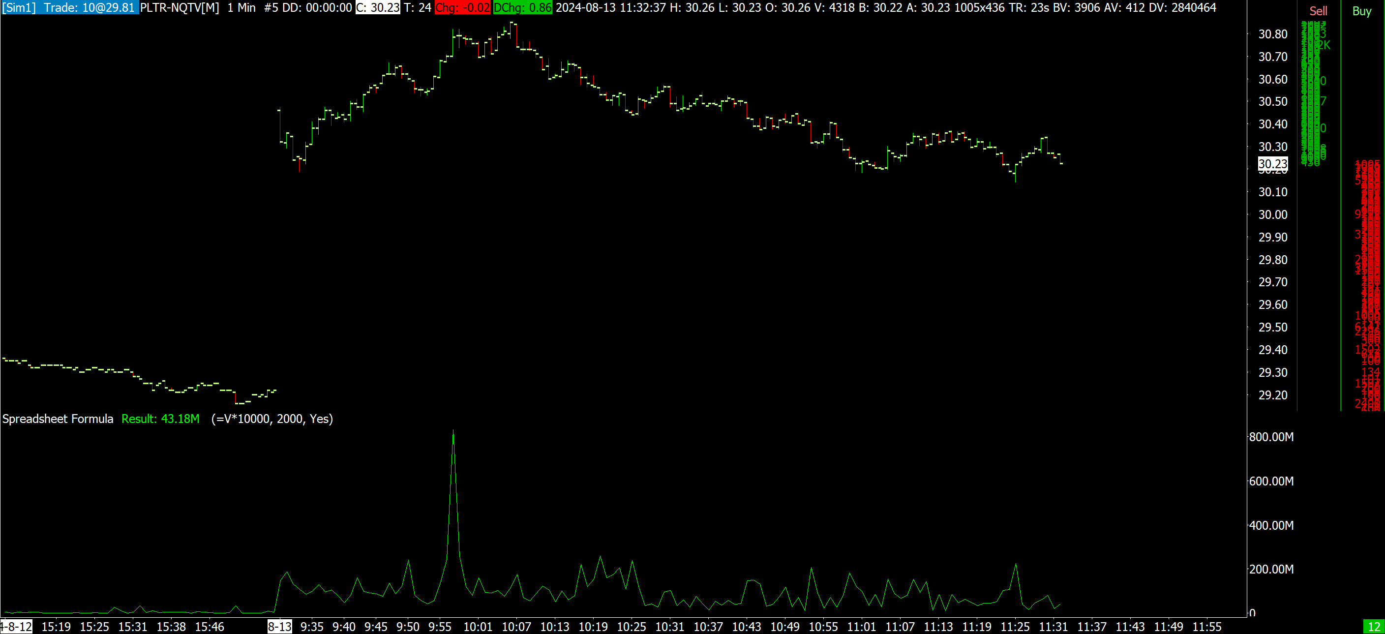

The first answer is that you can not change the width of the price ladder. So how it is showing is what it is.
But, we are a bit confused on why you are having it be so wide. We did a couple of setups similar to what you have and we are not able to reproduce the width you are seeing. Attached is basically the same layout as you have, but we do not see the large width you are seeing. Rather, you can see that the width is being driven by the size of the numbers in the study in region 2.
Please get us a copy of that chart for us to take a look. Follow these instructions:
imagePLTR-NQTV[M] 1 Min #5 2024-08-13 11_32_41.133.png / V - Attached On 2024-08-13 16:32:59 UTC - Size: 88.58 KB - 302 views
[2024-08-14 19:47:45]
Thanks. Attaching a screenshot and chartbook with isolated chart.
imageScreenshot 2024-08-14 at 1.43.02 PM.png / V - Attached On 2024-08-14 19:45:05 UTC - Size: 134.58 KB - 326 views
attachmentPrice Column Width Issue 08-14-2024.Cht - Attached On 2024-08-14 19:47:01 UTC - Size: 9.48 KB - 388 views
