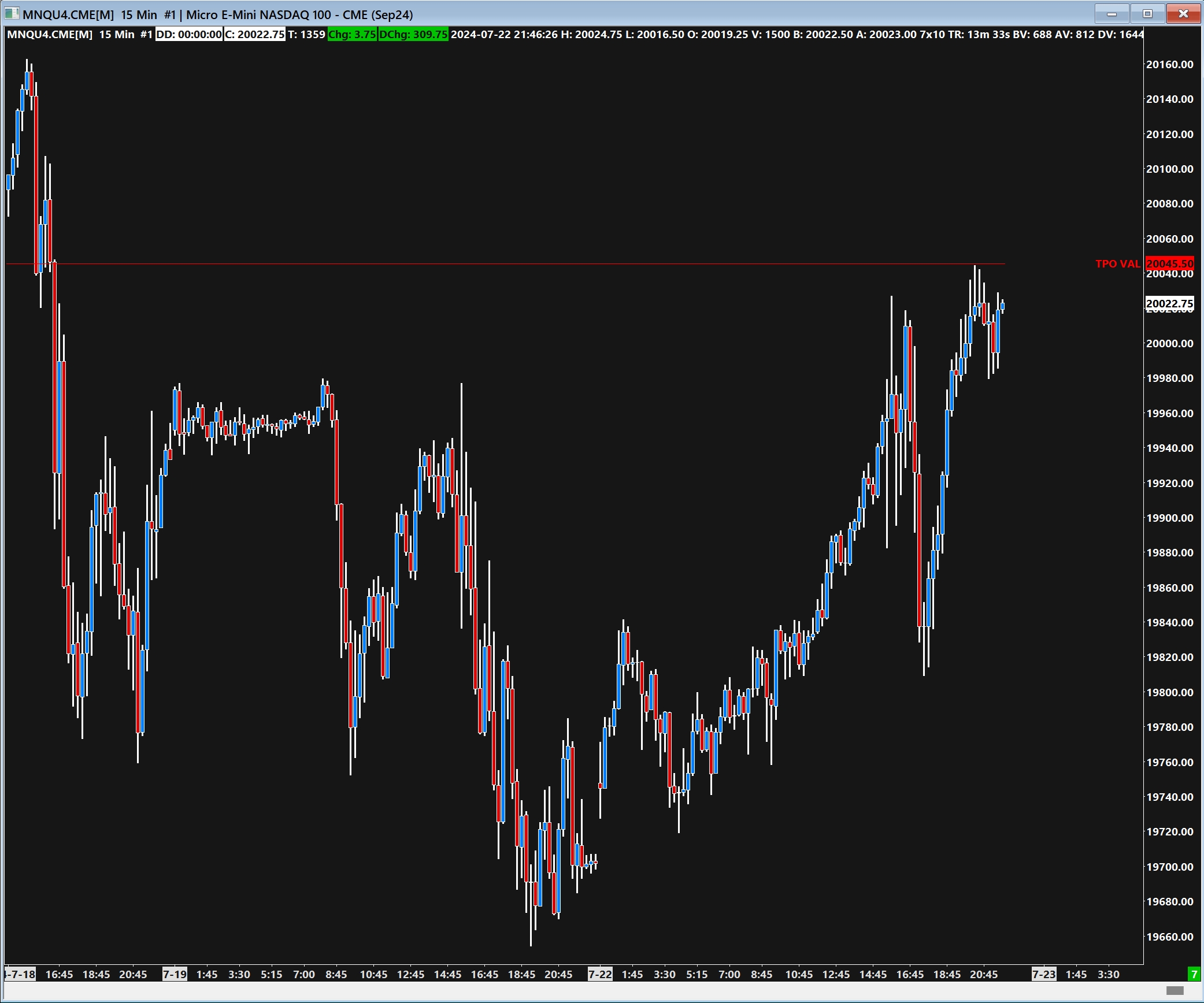

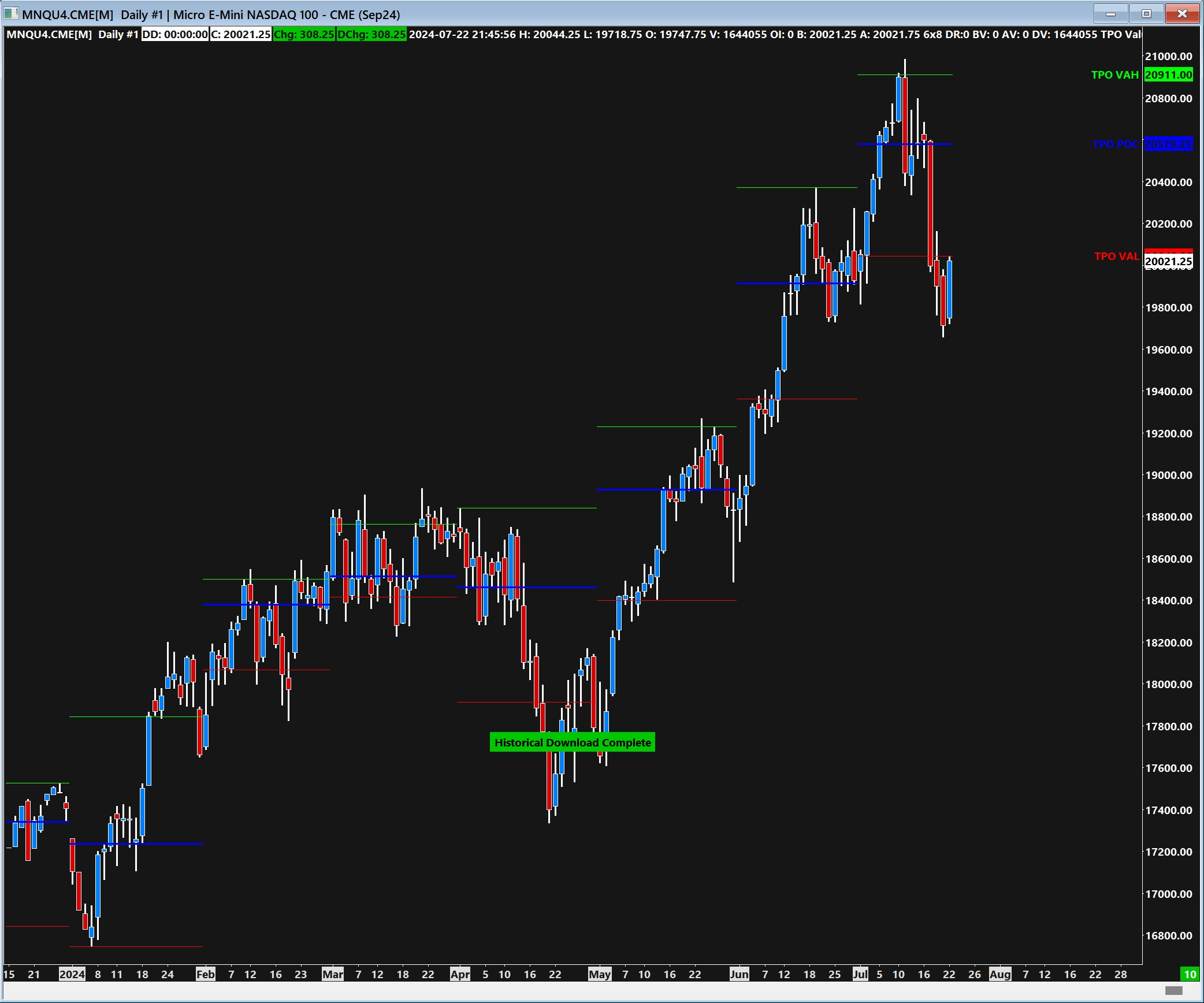

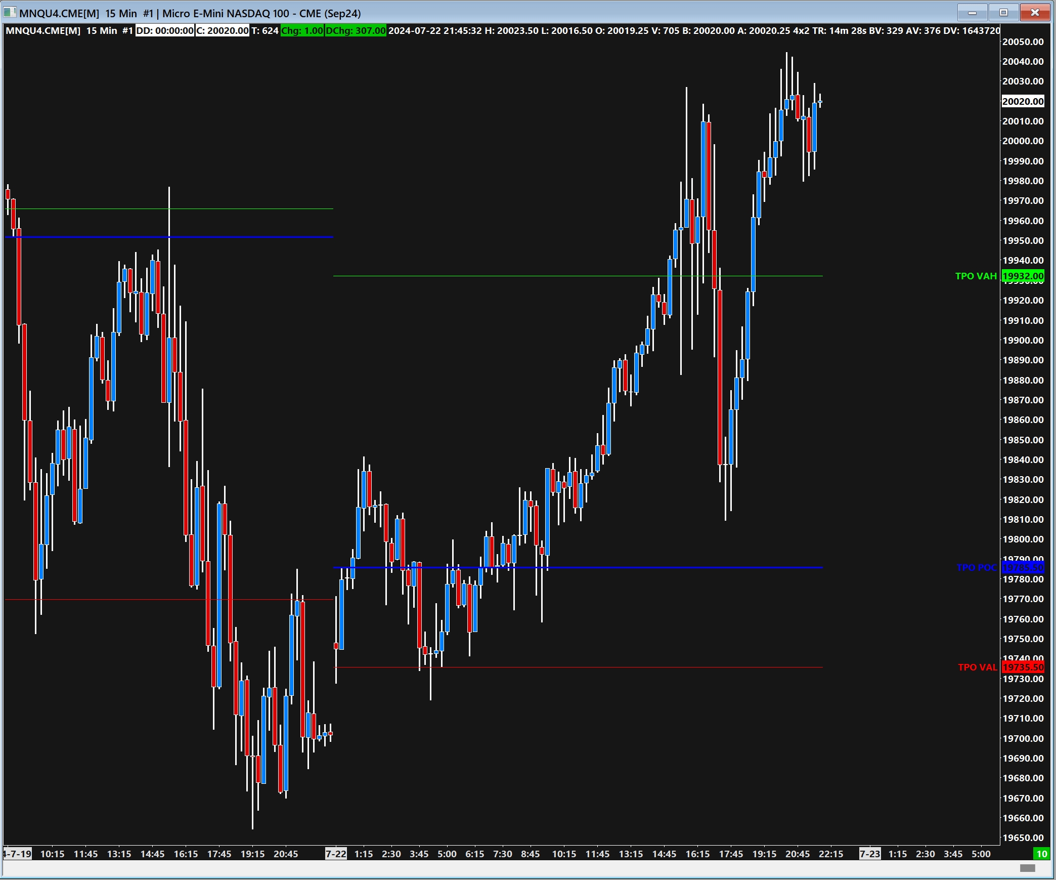

[2024-07-22 19:48:29]
Benutzer4711 - Posts: 39
But i can expect that when i switch back from daily to M15 the TPO Value area lines are displayed on the correct price.
See attached screenshots.
Date Time Of Last Edit: 2024-07-22 19:50:23
imageScreenshot_M15.jpg / V - Attached On 2024-07-22 19:47:09 UTC - Size: 668.64 KB - 255 views
imageScreenshot_switch_to_Daily.jpg / V - Attached On 2024-07-22 19:47:13 UTC - Size: 572.22 KB - 246 views
imageScreenshot_switch_back_to_M15.jpg / V - Attached On 2024-07-22 19:47:21 UTC - Size: 600.97 KB - 204 views
[2024-07-22 20:31:03]
The "TPO Letter Time Length in Minutes" is not being kept between changes. So it is changing to 1440 when you change to a Daily, so you would need to change this back to 30 when you change to a 15 Minute chart.
We have changed the code for this, so this will also stay as it was set when you change to a Daily chart if the option for "Automatically Correct Invalid Time Period Type/Length" is set to "No".
This will be in the next Pre-Release - v 2661.
