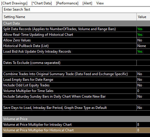

I use Numbers Bars, with the "Chart Data - Volume at Price Multiplier for Intraday Chart" set to 8.

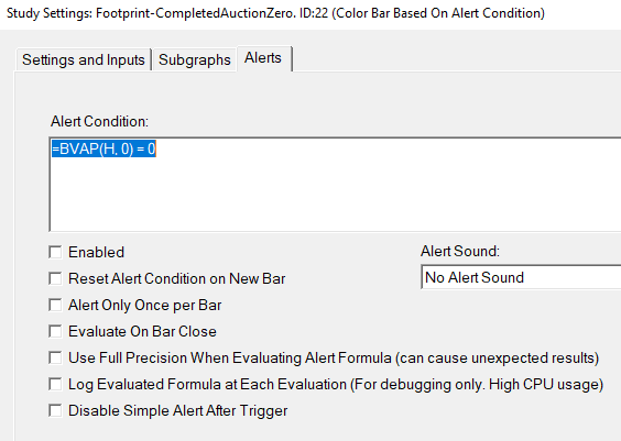

Alert Condition:
=BVAP(H, 0) = 0
Almost every bar shows the alert.
With the multiplier set to 1, the High Bid does often show 0.
I am guessing the problem is due to BVAP getting its' value with the Multiplier set to 1, and disregards my custom value?
Is there an easy way to get BVAP to obey the Multiplier setting, or calculate the correct value with math in the alert box?

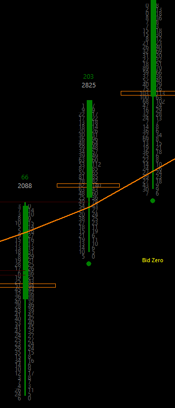

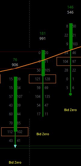

Here's what the candles look like with Multiplier set to 8. The volume as price that is hidden often has a 0 on the Bid High, so the alert triggers, but that's not what I'm after. I want to trigger only when my chart actually shows 0.

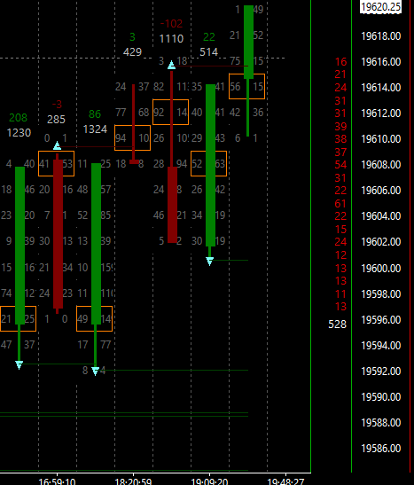

However, using tick size to 2.0 makes the chart completely different than using volume at price multiplier 8.
This is a Renko, Numbers Barschart, ticker NQ.
With tick size 2.0 and multiplier 1, the chart is horizontally compressed, having about 6 bars for a full day, and the vertical bars are too tall to be readable on my screen.
Using tick size 0.25 and multiplier 8, I get a couple hundred bars that are vertically compressed and readable.
Is there another way to get BVAP working while still having a vertically compressed set of Numbers Bars using multiplier 8 or similar?

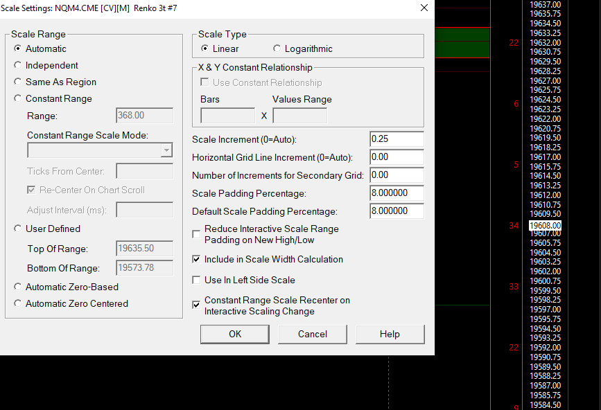

But I just noticed the tick size of 2 (of course) changes the DOM tick size to 2, and I need the dom tick size to be 0.25 to trade from it.
I changed the Scale Settings, Scale Increment to 0.25 to make the DOM look correct with all the price levels showing, but I can only click to trade in increments of 2.0.
Is there a way to change the DOM to be tradeable at 0.25 price increment while leaving the bars visually at 2.0 tick size?
