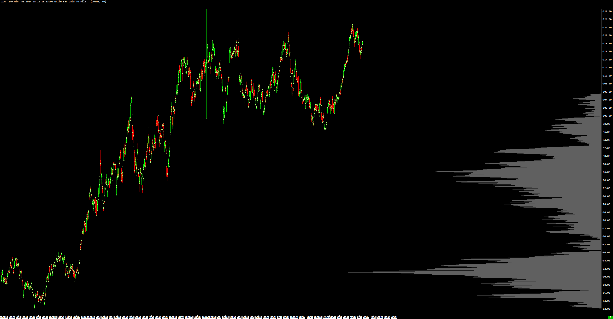

Hello, I'm trying to create volume profiles over extended periods (5+ years) on stocks using the consolidated tape data feed. To save space, I've set my intraday storage unit to 1-minute.
However, the volume reported is inconsistent through time and flips between what appears to be reasonable volumes to very large volumes (possibly a factor of 100,000x). Can you comment on what the issue may be and/or how to correct this? I can provide further details as needed.

[2024-05-10 19:34:35]
BillsSBC - Posts: 40
Please see attached. You'll notice the upper portion of the volume profile appears to be missing but it's because of the unusually large volume numbers that dominate the volume below.

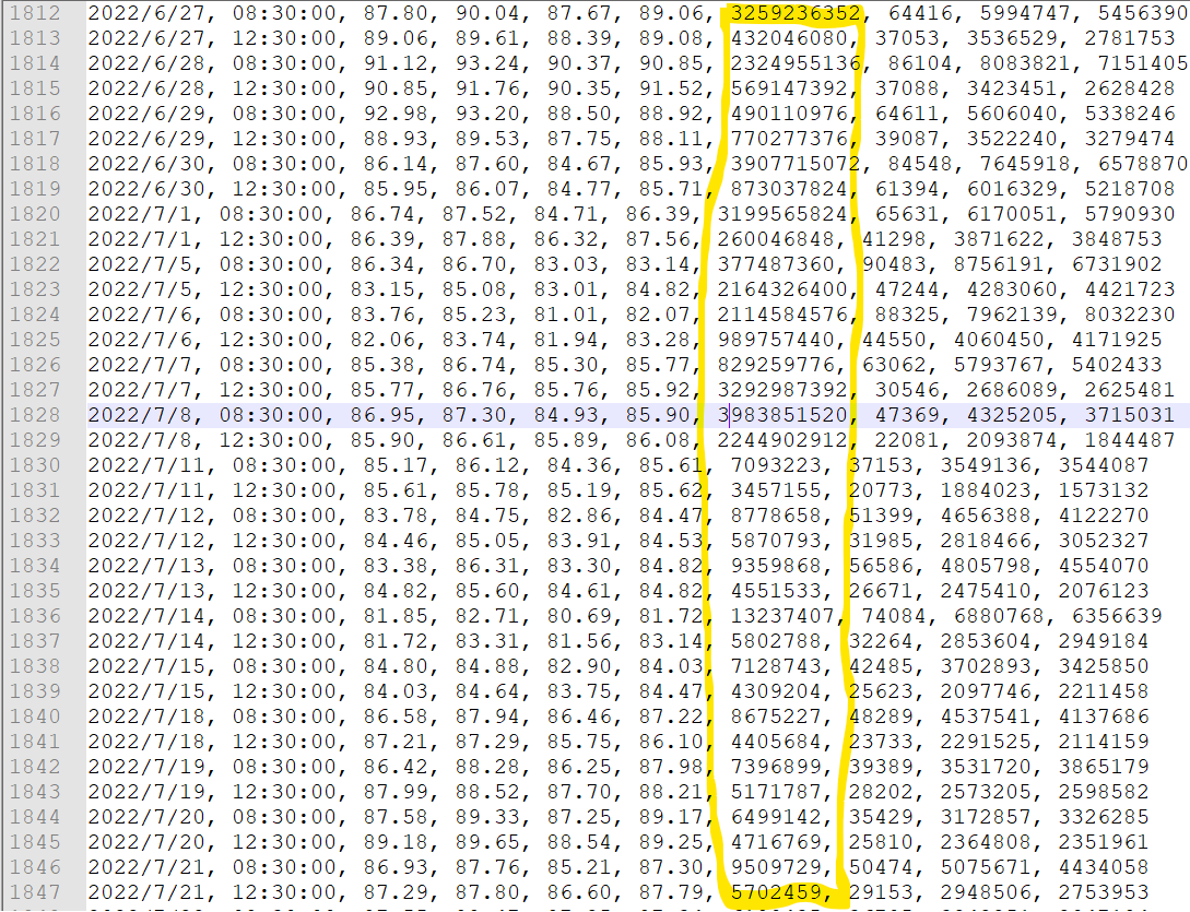

[2024-05-11 18:16:21]
We exported the data for the same time period you show and for the dates of 7/5 through 7/8 we have different values. But the rest of the numbers match exactly. We are not sure why your data seems to be "corrupted" for those numbers. See the attached image which has the volume with the yellow highlight around it.
With that chart active, please select "Edit >> Delete All Data and Download" and then see if the volume numbers from those dates match up to what we show.
imageXOM-BarData.png / V - Attached On 2024-05-11 18:16:17 UTC - Size: 152.18 KB - 297 views
