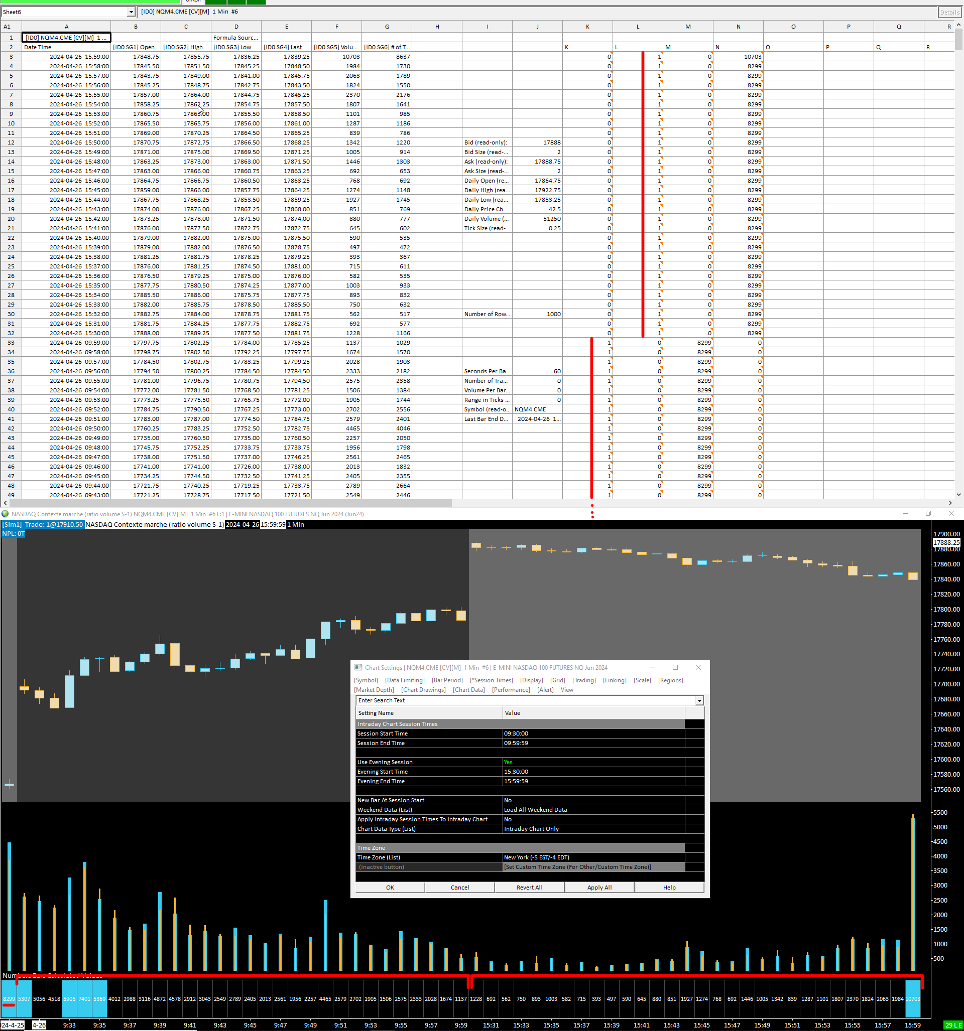

Hello everyone,
I have a problem with a spreadsheet, here are the formulas in the different columns and ID2.SG13 corresponds to the total volume of the bar.
K: Period variable (time)
=AND(FRACTIME(A3)>=TIME(9,30,0),FRACTIME(A3)<TIME(9,59,59))
L: Period variable (time)
=AND(FRACTIME(A3)>=TIME(15,30,0),FRACTIME(A3)<TIME(16,59,59))
M: Maximum volume calculation period 9:30 a.m.-10:00 a.m.
=IF(K3=1,MAX(ID2.SG13@3:ID2.SG13@62),0)
M: Maximum volume calculation period 3:30 p.m.-4:00 p.m.
=IF(L3=1,MAX(ID2.SG13@3:ID2.SG13@62),0)
My chart is set in a session 9:30 a.m. - 9:59:59 a.m. and with an evening session 3:30 p.m. - 3:59:59 p.m. (see capture).
My goal is to obtain the maximum volume between 9:30 a.m. and 10 a.m. on one column and on the other between 3:30 p.m. and 4:00 p.m.
The problem is that there is a gap, it takes into account the previous candle. That is to say that here on column M (bottom), the maximum volume between 9:30 and 10:00 should be 7401 and not 8299.
I don't understand where the problem could come from. Someone would have any idea ?

[2024-04-29 17:36:18]
John - SC Support - Posts: 47854
The problem is that you are using relative references to the cells. So for Row 3 everything works fine, but for Row 4 the calculation in M4 would be the following:
=IF(K4=1,MAX(ID2.SG13@4:ID2.SG13@63),0)
And so on, so you are not viewing just the data from the one period of time. You would have to change these to be absolute references in order to get the correct data. So you would want to enter the following for M3 (for example):
=IF(K$3=1,MAX(ID2.SG13@$3:ID2.SG13@$62),0)

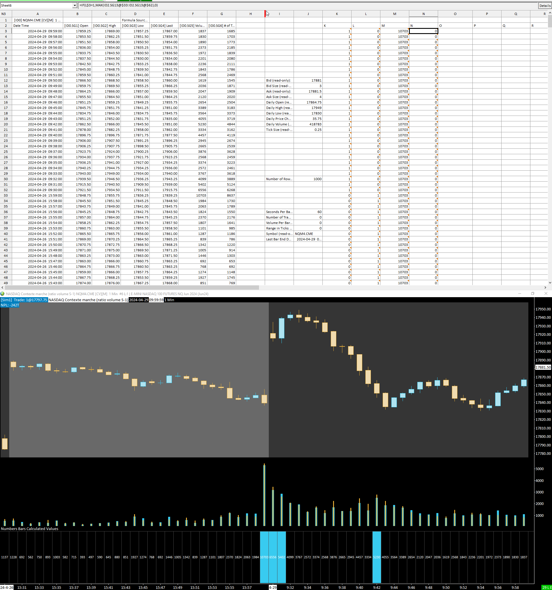

User440951 - Posts: 54
Thank you for the feedback.
I understand the logic and tried your formula.
Unfortunately, the result is equally improbable and does not correspond to my objective.
I put in M3: =IF(K$3=1,MAX(ID2.SG13@$3:ID2.SG13@$62),0)
And in N3: =IF(L$3=1,MAX(ID2.SG13@$3:ID2.SG13@$62),0)
image2024-04-29 20_50_07.png / V - Attached On 2024-04-29 18:50:36 UTC - Size: 172.38 KB - 184 views
