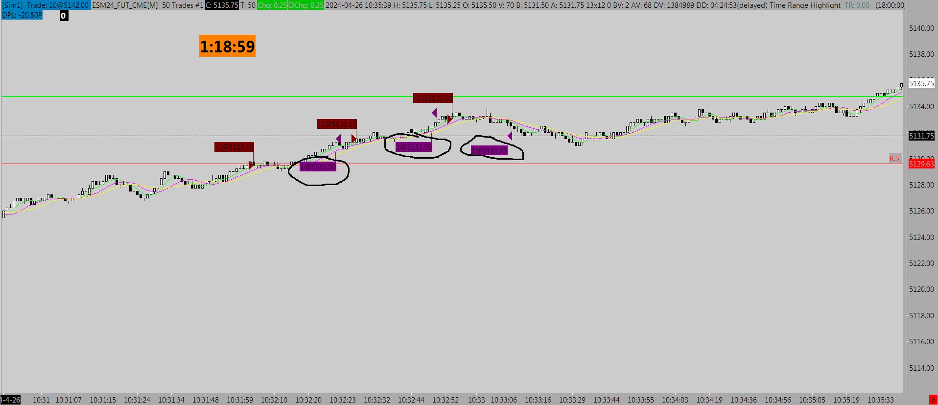

I have a 50 tick chart, and using automated trading with color bar based on alert condition combined with spreadsheet.
in the the color bar based on alert condition - the alert is triggered when the price is crossing the pivot point R.5 from below
this is the formula -
=OR(L=ID1.SG5,CROSSFROMBELOW(L,ID1.SG5))
and then I have formula in the "sell entry column" in the spreadsheet to enter short when this is true.
in the 26.04.24 the value of R.5 was 5129.63, during the trading, the software entered trades that has nothing to do with the formula (see attachment).
why this is happening ?

[2024-04-27 13:57:53]
Sawtooth - Posts: 4361
Check the Trade Service log for info about the entries.
Suggestion:
- Instead of using the Color bar study for entry signals, use this spreadsheet syntax formula in M3:
=OR(D3=ID1.SG5@3,CROSSFROMBELOW(D3:D4,ID1.SG5@3:ID1.SG5@4))

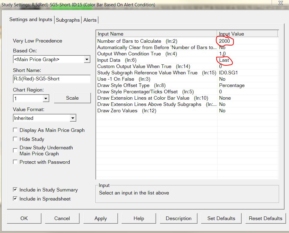

[2024-04-28 15:07:41]
alexo2022 - Posts: 55
When I'm using the color bar study the alert formula is -
and the settings and input -
Numbers of bars to calculate (ln:2) - 2000
Input data (ln:6) - Last
(see attachment)
when I writing the formula you wrote
=OR(E3=ID1.SG5@3,CROSSFROMBELOW(E3:E4,ID1.SG5@3:ID1.SG5@4))
I'm not getting same entry results,
how can I can get the same results using formula instead of the color bar?
and how can I make sure, the software doesn't getting inaccurate entry points ?
imageColorBar - Setting and Input.JPG / V - Attached On 2024-04-28 15:07:24 UTC - Size: 131.75 KB - 264 views
[2024-04-28 23:05:59]
You cannot use L to get the Last price. The Last price is not L, it is C.
The Last price on the spreadsheet is in E3, so the equivalent is C for the color bar study
The Low on the spreadsheet is in D3, so the equivalent is L for the color bar study.
This is why they are not the same.
[2024-04-29 11:46:12]
I understand what you wrote, my question is what the input data in the color bar alert study mean,
you can choose "open", "high", "Low", "Last".
if I choose "last" for example, how it's affecting the alert ?
and if I decide to use a formula instead of the color bar alert,
how can I produce the same result as if I was choosing "last" in the input in the color bar alert.
[2024-04-29 12:31:00]
The 'Input Data' of OHLC etc is only used when the 'Output When Condition True' is set to 'Use Input Data'.
That setting has no effect on the T/F of the alert.
Color Bar Based on Alert Condition: Output When Condition Is True
if I decide to use a formula instead of the color bar alert, how can I produce the same result
=OR(D3=ID1.SG5@3,CROSSFROMBELOW(D3:D4,ID1.SG5@3:ID1.SG5@4)) on the spreadsheet will produce the same result as
=OR(L=ID1.SG5,CROSSFROMBELOW(L,ID1.SG5)) on the Alerts tab of the color bar study.
Thanks for the help.
just for others who will read this in the future,
regarding the entry accuracy problems I had,
I read the log, and find out there were other sheets in the spreadsheet
that were running also automated trading,
so the problem was that I had multiple sheets running automated trading simultaneously,
and that's why I saw "inaccurate" entry points.
