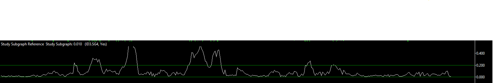

attached is a picture showing a subgraph of a spreadsheet formula I'm working on. How would I go about coloring bars whenever the line crosses and closes above the 0.200 line? thanks

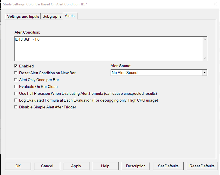

Use the following formula for the alert in the "Color Bar Based on Alert Condition" study:
ID1.SG1 > 0.2
Where ID1 is the ID of the study that draws the line and SG1 is the subgraph of the study that is the line.

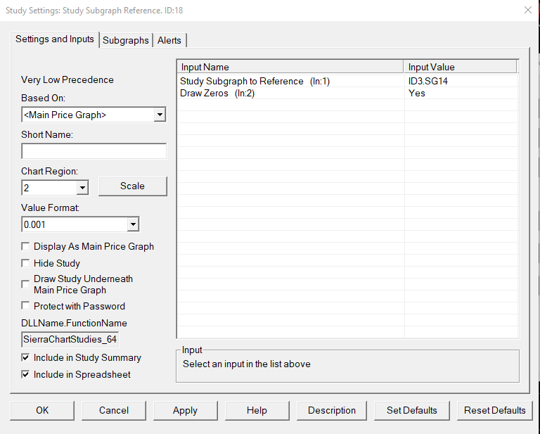

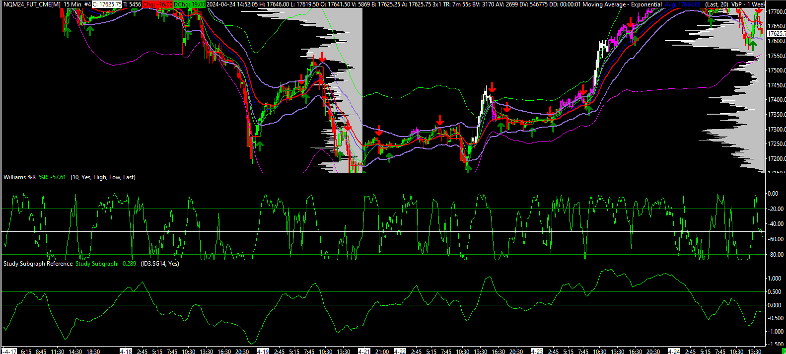

so the formula worked, but it's not coloring the bar past this week no matter how much bar I put to color
Did you change the formula to be the ID and Subgraph for your study? ID1 and SG1 are just examples. You need to change these for your setup.

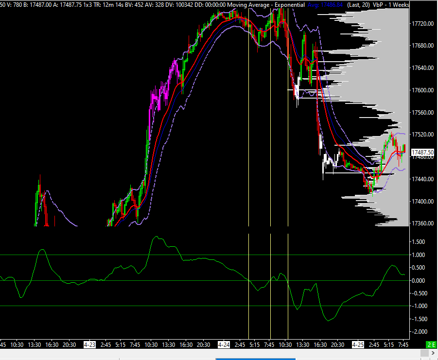

Sorry, I'll try to explain better. I would like to color the bar of the exact candle that causes the study to close above or below 0. I've attached a photo with yellow vertical lines. In essence I would like the study to color those bars

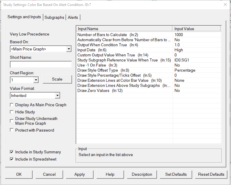

With regards to the bars that are being colored (or not being colored going back), we see that you have the "Numbers of Bars to Calculate" set to 1000. Try increasing this to get colored bars further back in time.
With regards to the other question, the image you provided is basically asking to color the bar when the study value is 0. In order to overcome floating point errors and the fact that the result may not be exactly zero, you would want to test a small range of data around zero. So you would use a formula like the following:
=AND(ID1.SG1 > -.01, ID1.SG1 < .01)
This will give you a true result when the value of that subgraph at that bar is between 0.01 and -0.01.

So I set the bars to calculate to 5000 and still won't go past yesterday.
The formula you gave worked and oddly enough it colors bars past yesterday
