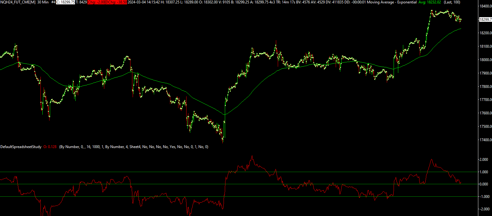

so I'm just trying to standardize an ema based off LN previous bar change. My question is shouldn't the value be at 0.00 whenever price is at the EMA? please see attached photo any help is appreciated

Update: I've played with the scaling and still have the issue, I also plotted just the L column which is the LN of the ema and it aligns perfectly but loses it standardization
[2024-03-05 18:59:56]
John - SC Support - Posts: 48509
What do you mean by "LN"? And what do you mean by "...but loses it standardization"?
As you can tell, we know nothing about the calculation you are doing, so we can not answer your questions.

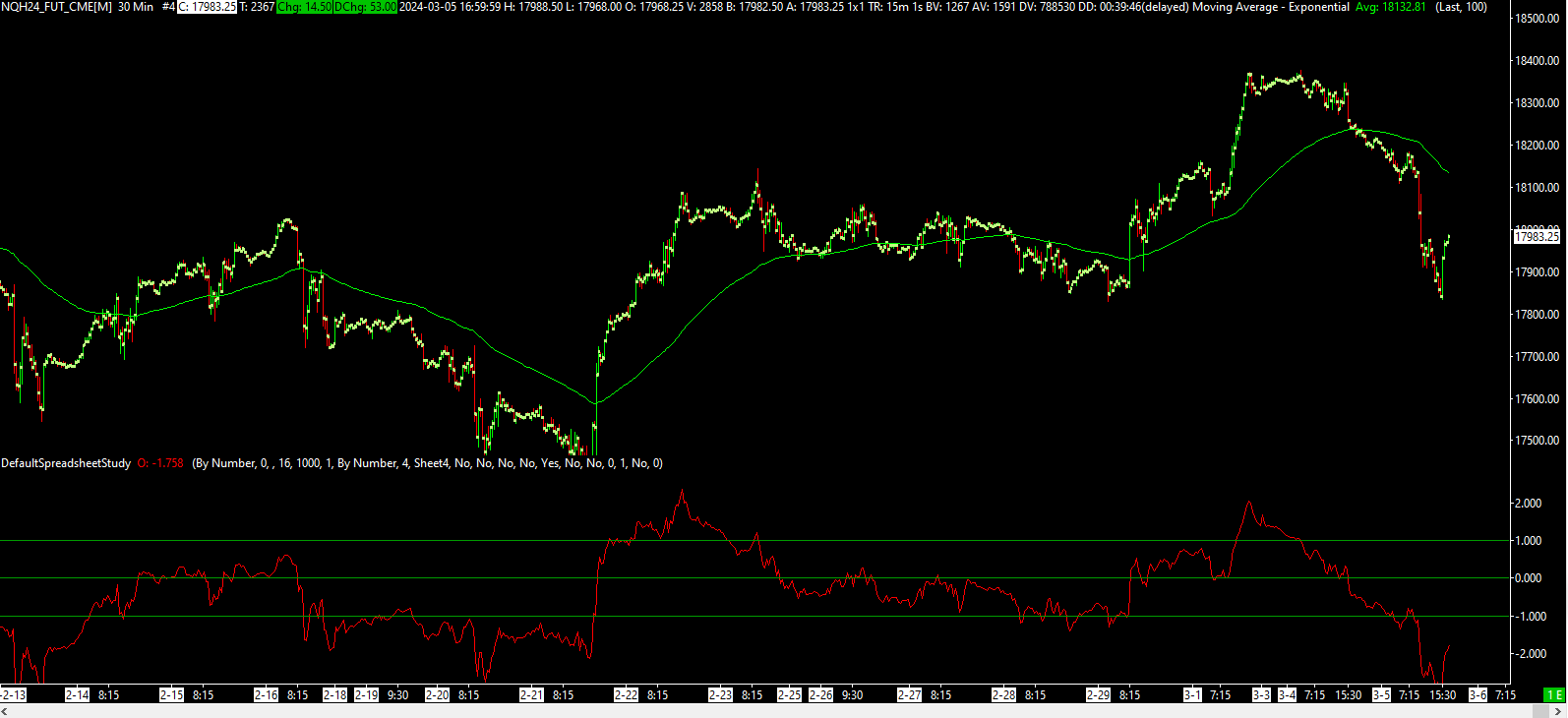

Thanks for explaining that, I had no idea. I thought it was the same thing. I used the formula you suggested and it's still the same
imageScreenshot 2024-03-05 173957.png / V - Attached On 2024-03-05 22:40:36 UTC - Size: 47.11 KB - 216 views
[2024-03-06 15:33:59]
What exactly is the problem? If you are referring to when the data should be 0, then the probabilities of this are very small, as the value in the L column would have to match the Mean of the population (cell M3). It will not be when the Close is the same price as the EMA (as noted above).

so how can I get that done with the EMA? what am I doing wrong? I'm not trying to be difficult just trying to teach myself and learn
[2024-03-07 16:08:31]
You are taking the natural log of the EMA from the current bar divided by the EMA of the previous bar, and then using that to determine the Slope and Intercept for an input into the Z-Score.
The formula we use in our Z-Score study is the following Z(index) = ((X(index) - SMA(X)) / SD(X)
Where X is the Input Data, SMA is the Simple Moving Average of the data, and SD is the Standard Deviation of the data.
Therefore, for what you are doing in a spreadsheet, your formula would be the following
= (ID0.SG4@3 - ID1.SG1) / $N$3
Where ID0.SG4 is the Close, ID1 is the EMA study with SG1 being the EMA subgraph, N3 is the cell that holds the Standard Deviation of the EMA (not the LN(EMA/EMA(-1)).

That worked. Thank you so much for your help and time
