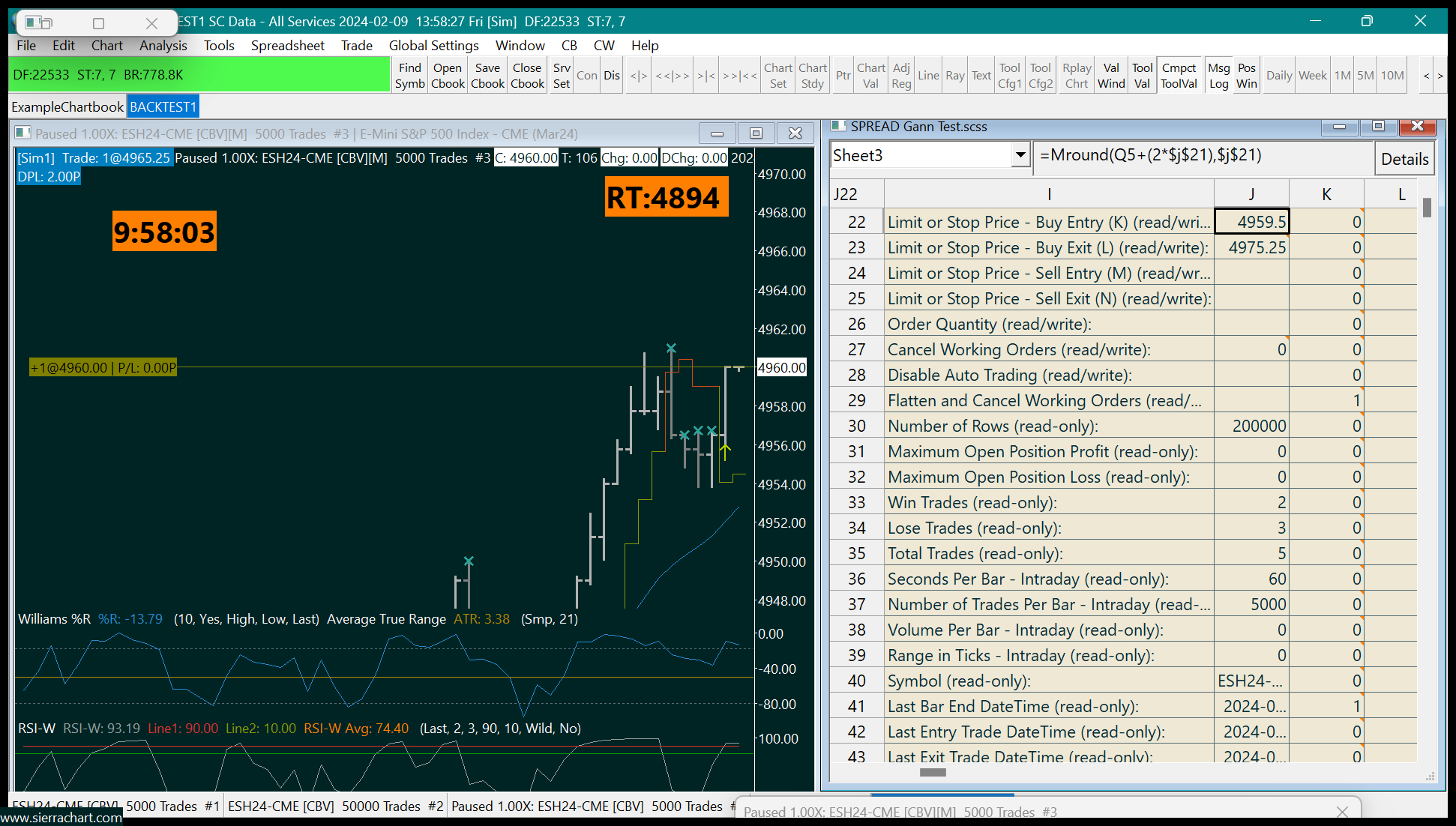

I am trying to create a spreadsheet auto trading system but the entry order is not the one specified by the formula and value that I have on J22. for example
I am using the Gann hi-lo activator on AD and when this one indicates a turn (k3=1), I want a limit order indicated by j22 2 ticks above the previous reading (AD4+(2*$j$21)), it works great when the close is below AD4, so when price reaches the order, it buys the order, BUT, if price closed above the previous activator (AD4), let's say it closed 5 ticks above the previous activator, which is higher than the level (AD4+(2*$j$21)) it places the order at that last close level and I will prefer to be placed exactly 2 ticks above the previous reading and get activated if price comes back.
going through the documentation I found this is worked around with buy triggered limit orders, how can they be applied to the spread sheet auto trading?
or if there is another turn around or value/formula in another cell I am missing out, will you please tell me how to do it or point me in the right direction?

From what you are stating, it sounds like you would need to use a "Stop-Limit" rather than a Limit. Refer to the following:
Order Types: Stop-Limit

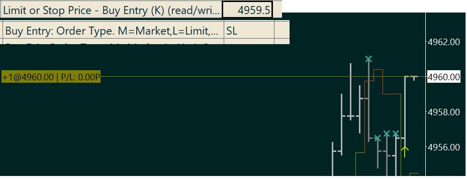

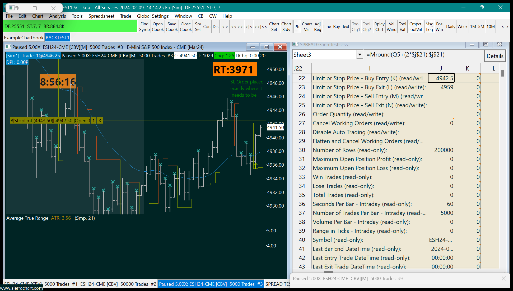

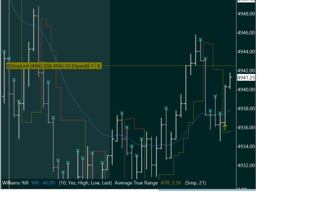

User555185 - Posts: 11
Thank you for the response, indeed Stop-limit was the first option.
So the question will be: How can a stop limit order be placed below the last trade price on the spread sheet system for trading?
As mentioned before, when the close is below where the price that is suppose to be set at the stop limit once the signal is triggered, it works find, but when the signal is triggered, and Close is above the desired price for the stop limit, order is triggered at the market price and receive the next error:
Buy stop must be at or above last trade price
but I am specifying that it should be in a level that sometimes will be below the last trade price.

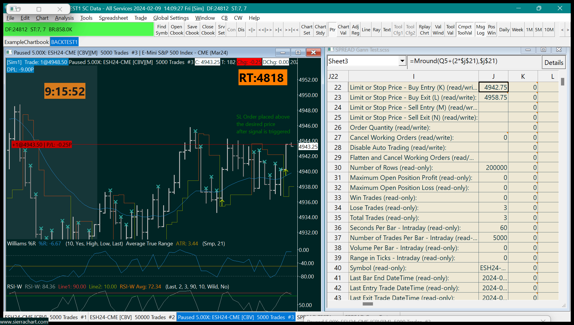

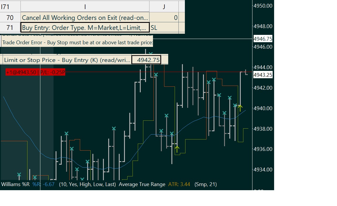

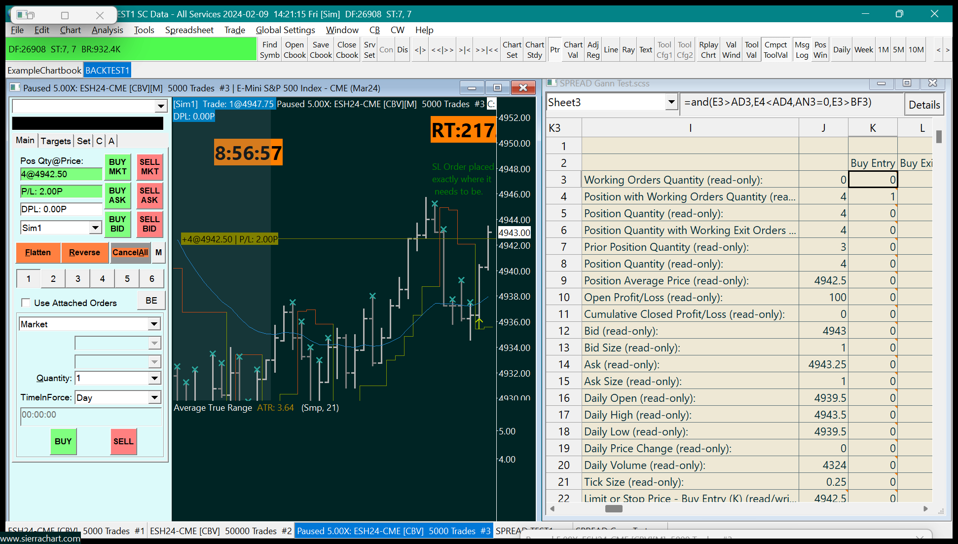

Below you will find 3 examples, also with screens of the cells at which the stop limit bust be places and the type of order, in the first two images are showing the behavior on entry ant a not desired entry price and the third one show that it works perfectly when last price is below the desired entry price price. Cell J71, it is set to: SL
https://www.sierrachart.com/image.php?Image=1707508709597.png
https://www.sierrachart.com/image.php?Image=1707509369186.png
https://www.sierrachart.com/image.php?Image=1707509667252.png
I have also went to global settings> chart trade settings> General> Reject stop orders that will immediately Fill set to YES and it did not make a difference.
Also, noticed that when stop limit is triggered is buying a random number of contracts which is not desired.
How can it be set up on the spread sheet system for trading to just buy/sell a specific number of contracts? Maximum position allowed is set to 1 for the moment and you can see that the order bought 4.
https://www.sierrachart.com/image.php?Image=1707510076270.png

[2024-02-09 21:13:35]
John - SC Support - Posts: 48587
On the Trade Window for the chart that is associated with the spreadsheet, there are options in the "Set" tab for "Stop-Limit Order Limit Offset". Make sure this is set how you want. It sounds like you want these to be 0.
We are not sure we are following the situation. But here are the things to keep in mind. If you are wanting to place a working order at a price that is in your favor (e.g. a Buy order at a price less than the current market price) then you would enter a Limit order. If you are wanting to place a working order at a price that is not in your favor (e.g. a Buy order at a price higher than the current market price) then you would enter a Stop-Limit.
It sounds like you may need to change your order type depending on where exactly you are wanting to place the trade. You can set the Order Type in cell J71 using a condition like the following:
=IF($E$3 > 1800.00, "L", "SL")

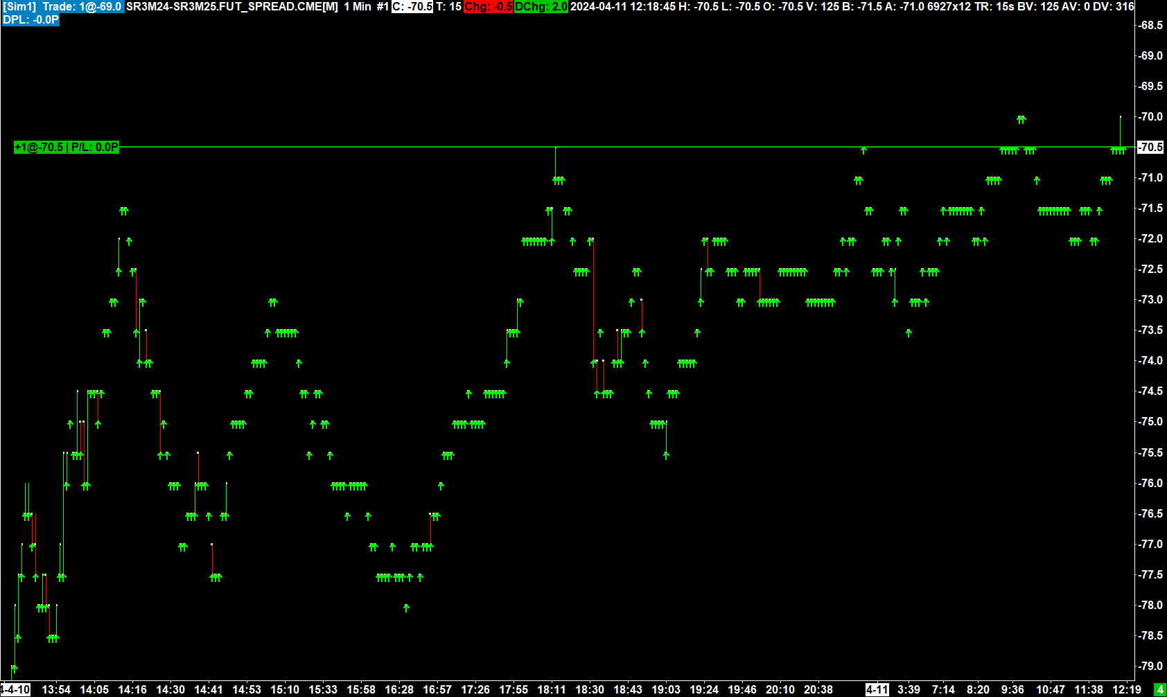

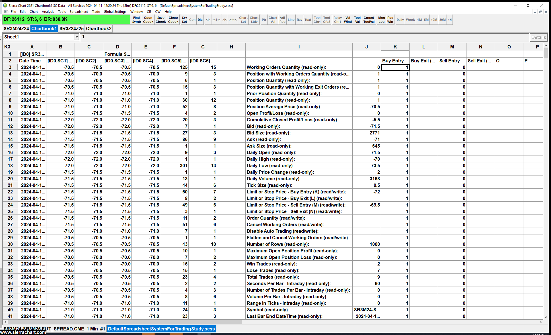

[2024-04-11 08:44:01]
rahul.pitty - Posts: 13
I did that using limit order and it worked fine. But that is not the case when I am deriving the limit price value from a formula or maybe near to the current price.

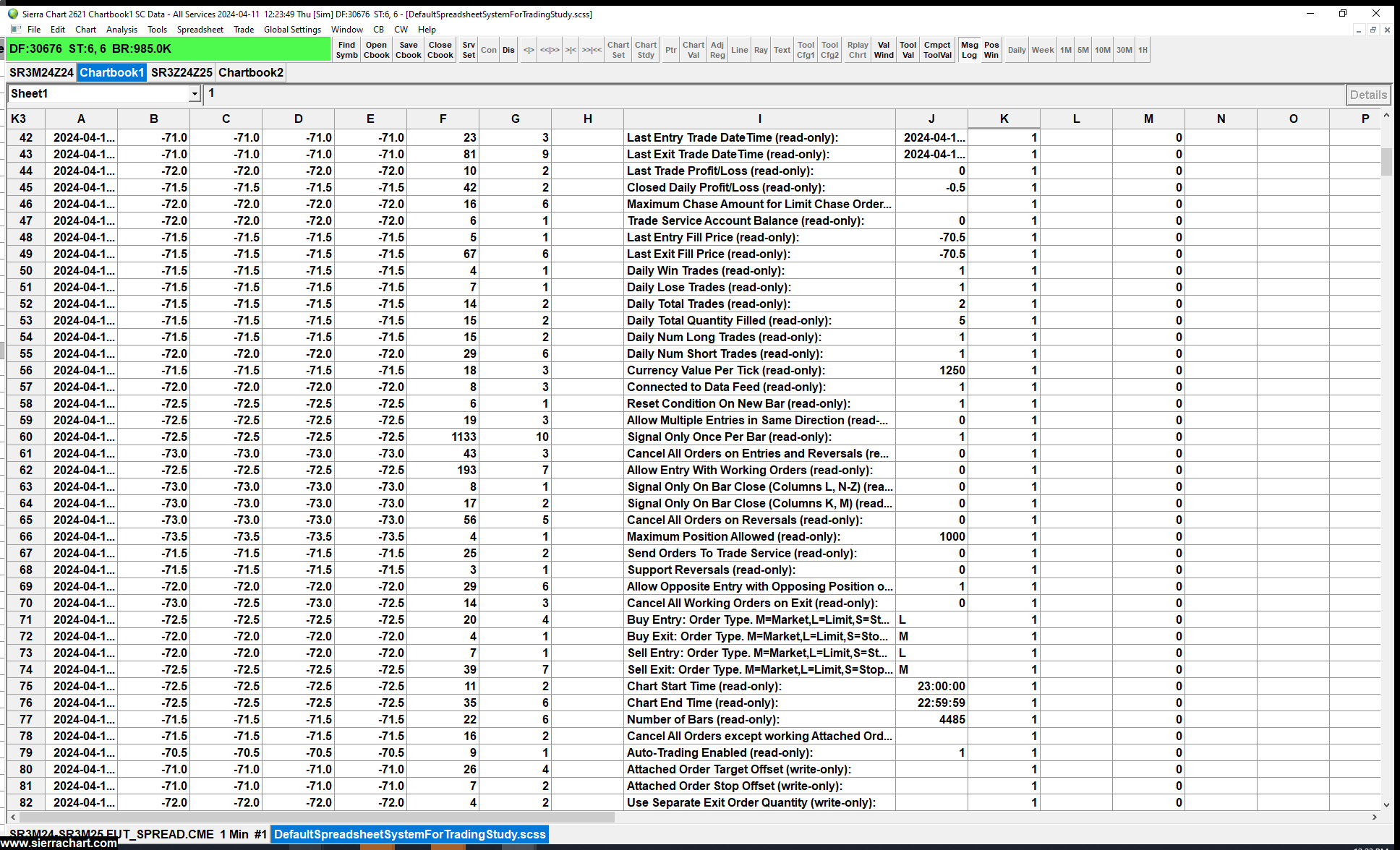

https://www.sierrachart.com/image.php?Image=1712827150358.png
https://www.sierrachart.com/image.php?Image=1712827250290.png
Humbly request you to help me solve the issue on priority.
Date Time Of Last Edit: 2024-04-11 09:24:47
[2024-04-11 11:24:36]
https://www.sierrachart.com/image.php?Image=1712834384128.png
https://www.sierrachart.com/image.php?Image=1712834426275.png
https://www.sierrachart.com/image.php?Image=1712834632843.png
this is the example of simple limit order placed through spreadsheet which got filled at wrong price.
[2024-04-11 15:04:30]
Is the issue where the Limit is being placed to begin with, or is it the price at which it fills?
[2024-04-12 05:58:04]
it is entering limit order at wrong price so I am not getting fills at desired price.

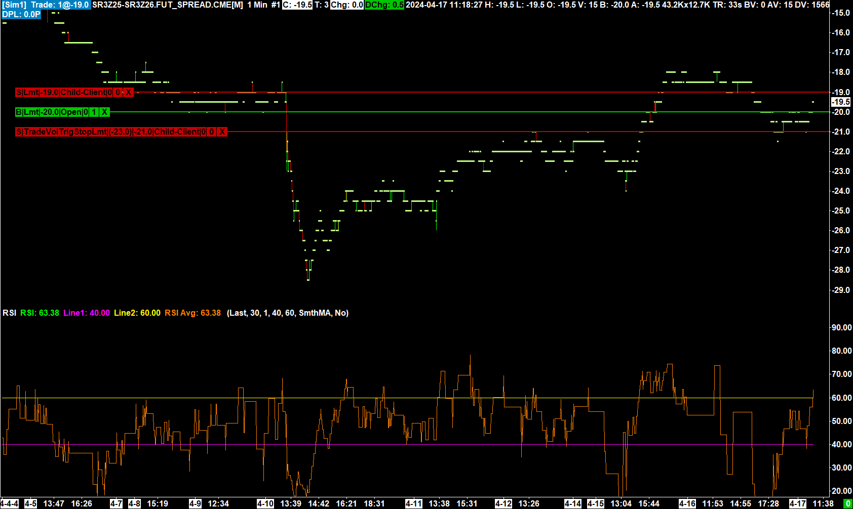

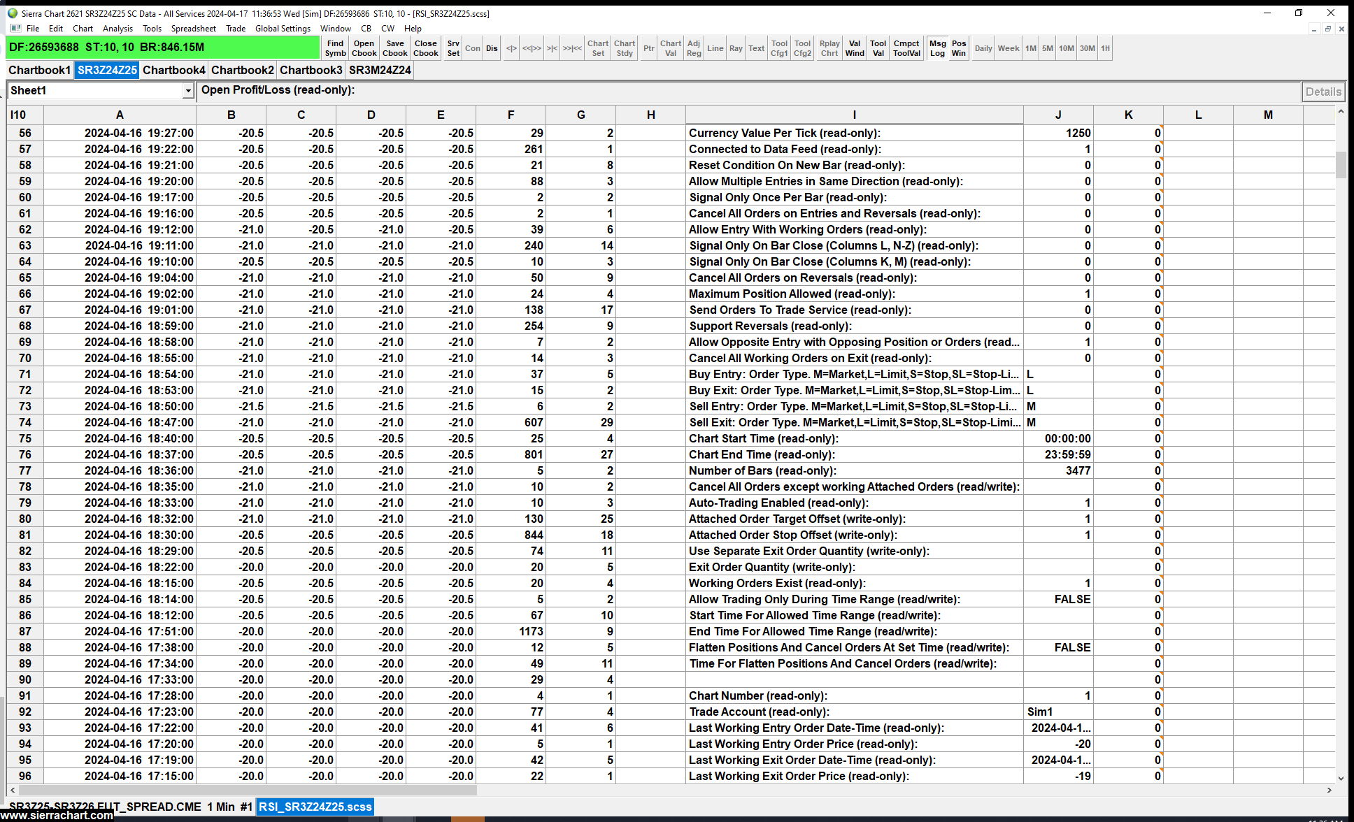

[2024-04-17 10:55:31]

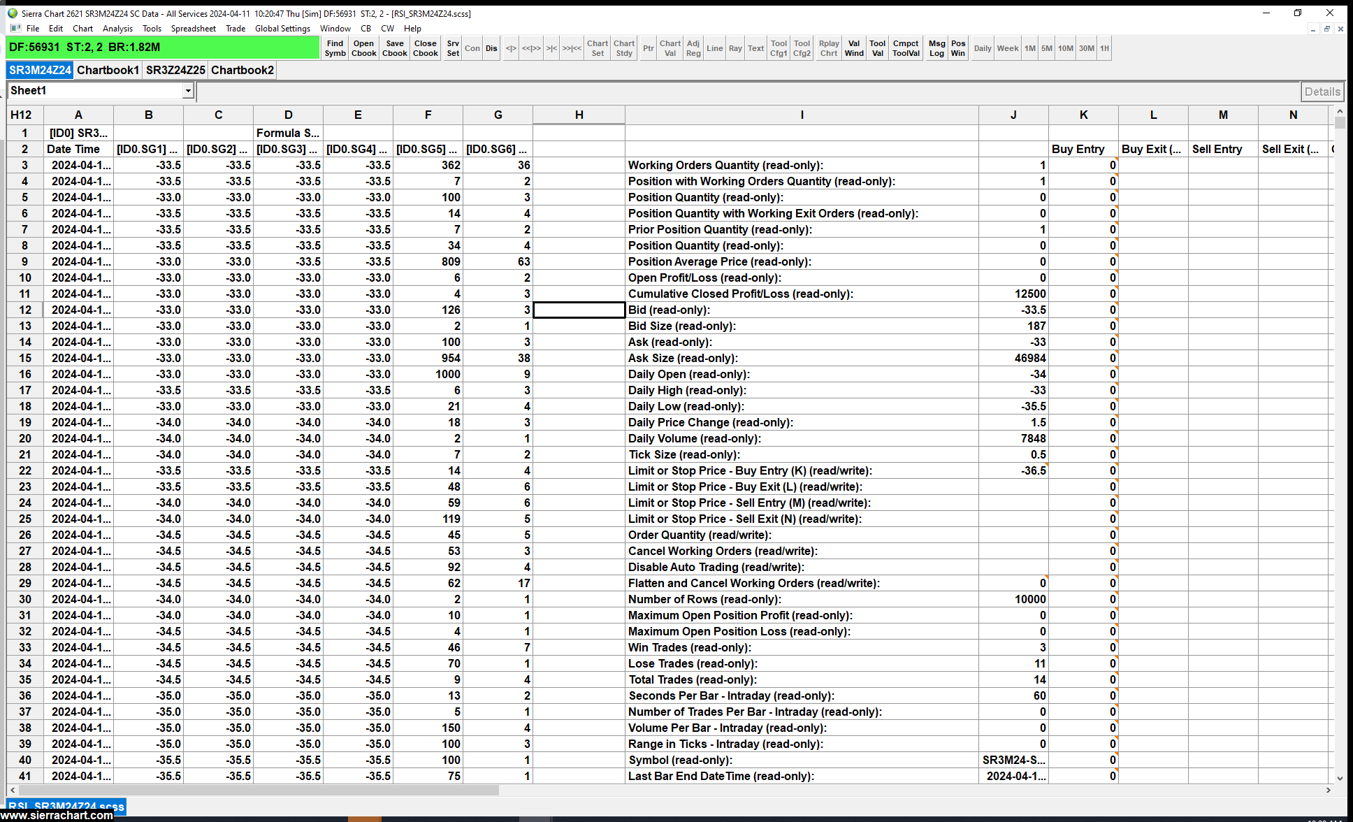

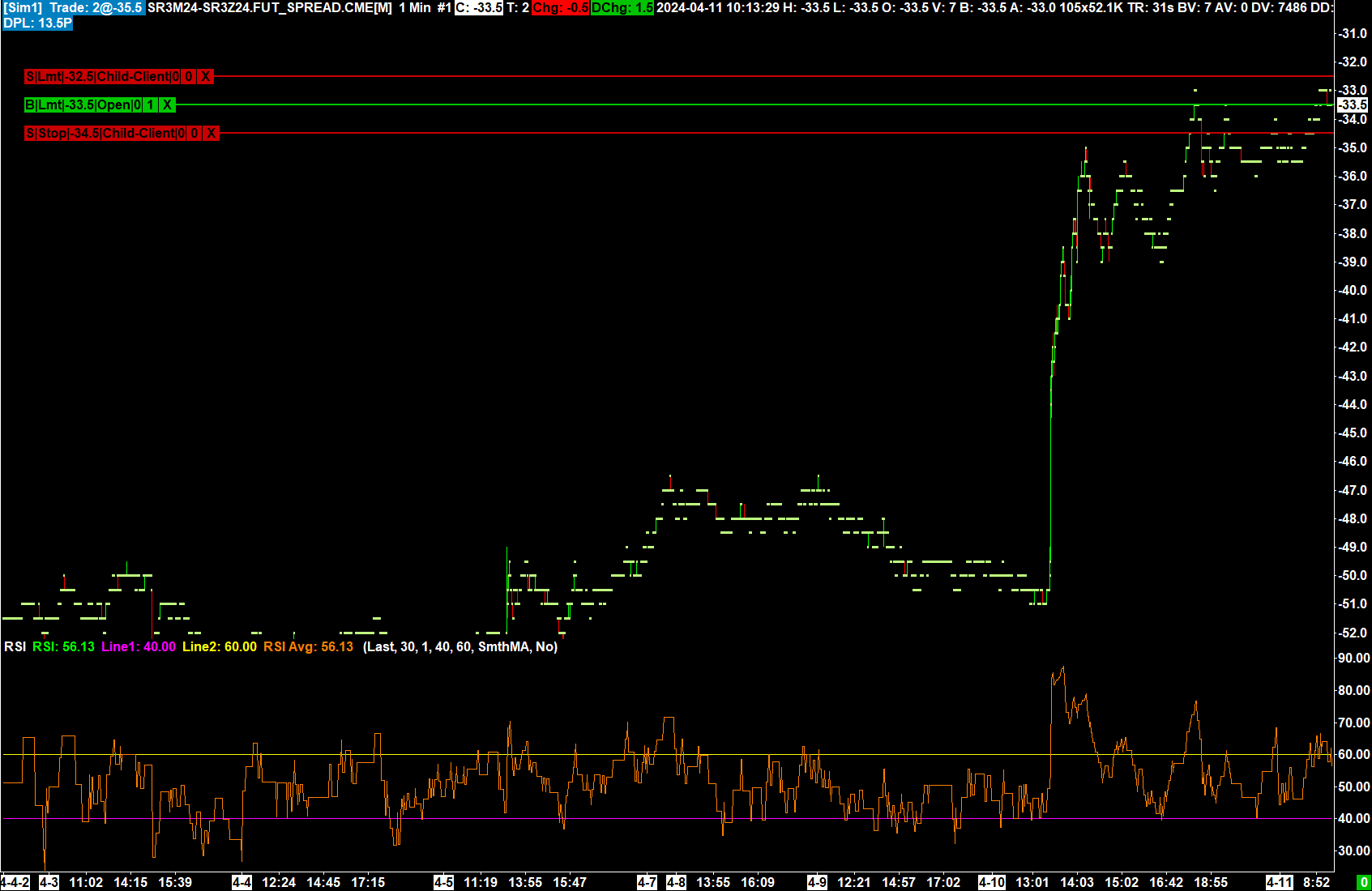

https://www.sierrachart.com/image.php?Image=1713350136168.png
https://www.sierrachart.com/image.php?Image=1713350165281.png
https://www.sierrachart.com/image.php?Image=1713350215516.png
Hope this makes everything clear. Static value in J22 cell is -24. Limit order is placed at -20.
