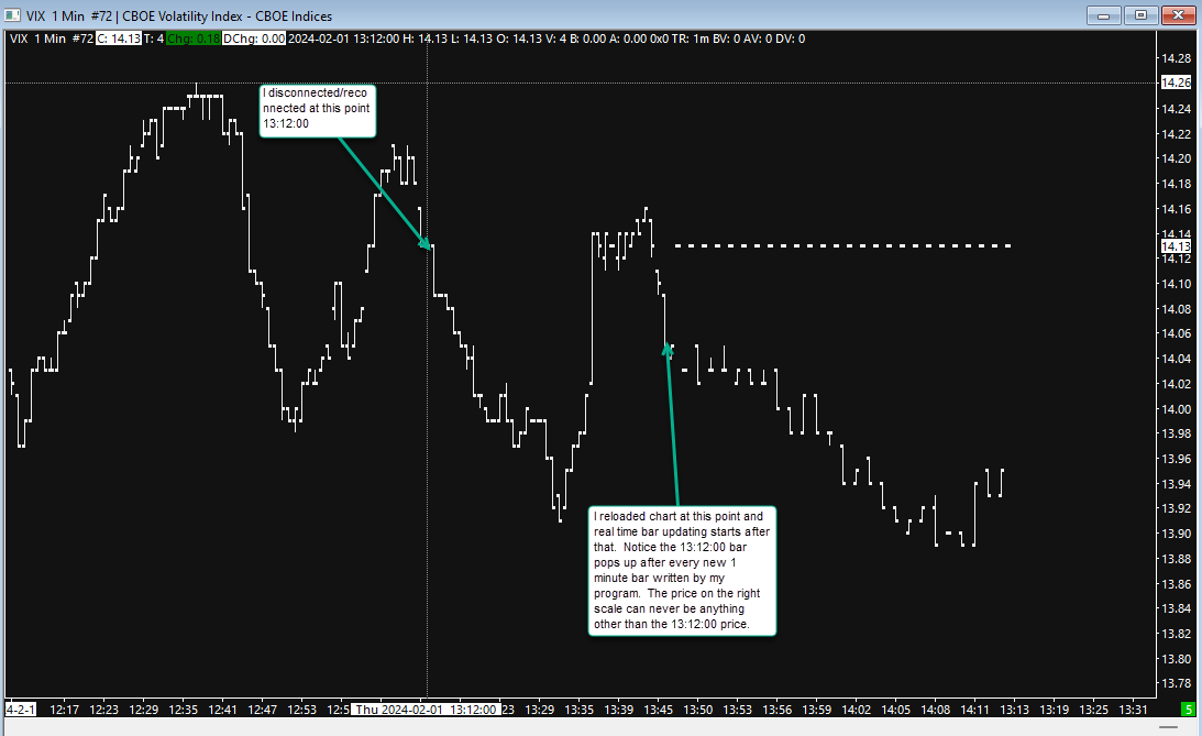

And this is how my bars print on the chart. One good 1 minute bar, which is immediately followed by another "out of order timestamp" 21:59:00 bar from the day before. But that is not how my intraday data is being stored in scid. My python program definitely isn't adding the 21:59:00 bar as you can see from the first intraday data text export.
If I disconnect/reconnect the data feed then the spurious extra 1 minute bar with prior timestamp that gets added after every new bar has the timestamp and price of the last bar before reconnection. i.e. if I disconnected/reconnected at 08:30, instead of the extra 1 minute bar having a timestamp of 21:59:00 it will now be 08:30:00 and the last price will be the price at 08:30:00. Then this 08:30:00 bar will be added after every new bar that is added by my program. Its like SC is storing the last known price prior to connection and then not allowing that to be overwritten by my program.

I've attached a chart to show you how this looks on a chart

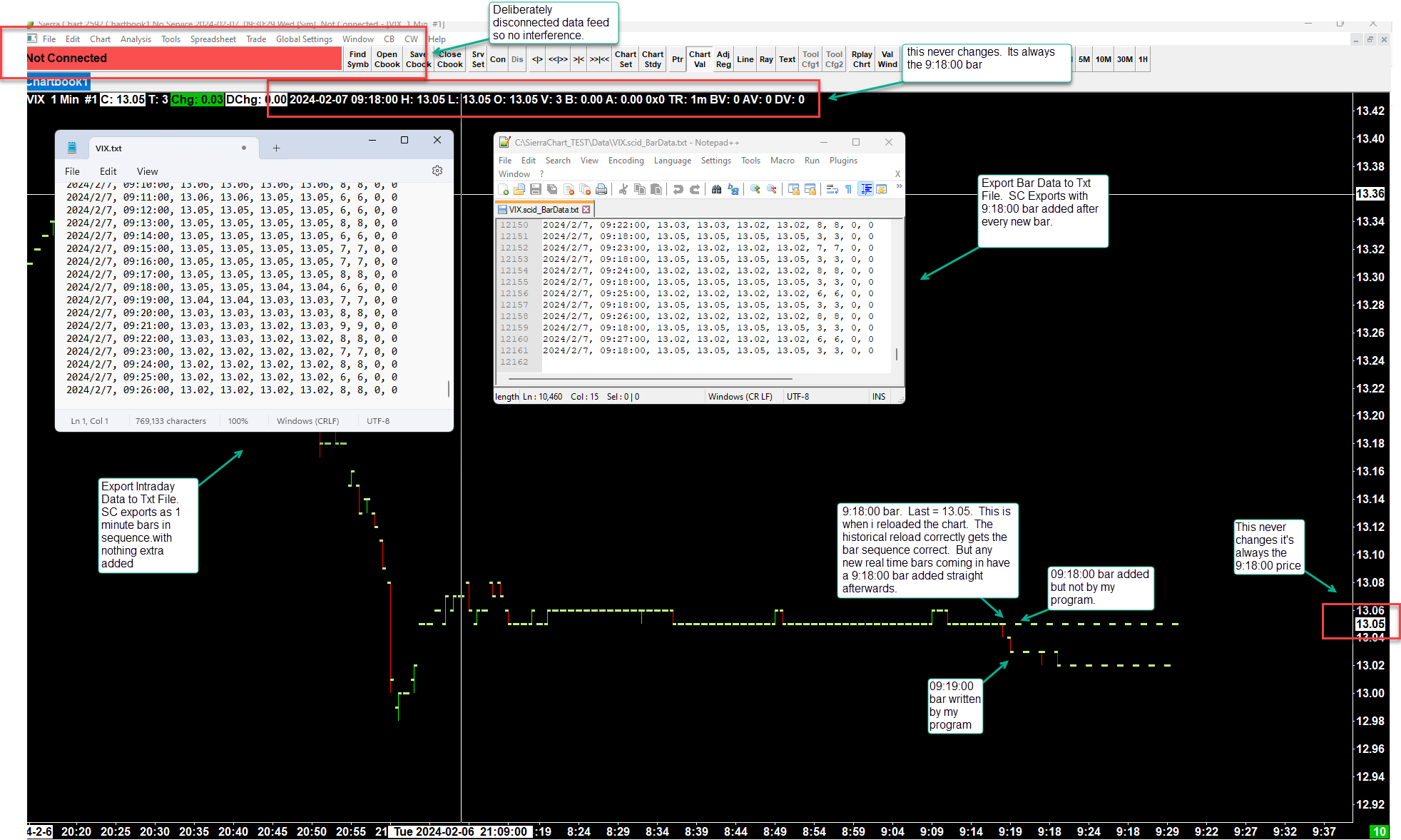

I've simplified the test environment. New standalone install of SC (not a sub instance). Not connected to any data feed. Intraday storage time unit = 1 minute. My external program feeding 1 minute records into VIX.scid. In the chart I still get the additional bar added by SC (I believe) after my program writes a new real time 1 minute record to scid. VIX.scid is correct with sequential data according to "Export Intraday Data to Txt File". But not correct when I export "Bar Data to Txt File" (SC adding the extra 09:18:00 bar?). I've marked up a picture with all details in the attachment. If I change Intraday storage time unit = 1 tick then chart displays real time data in VIX.scid correctly and sequentially - and if I "Export Bar Data to Txt File" similarly all rows are sequential and correct (i.e. no 09:18:00 row after each new real time bar). I know how busy you guys are I'm not expecting an investigation when your time could be spent better elsewhere. I realise it's a pretty esoteric use case of SC, its just frustrating me as I like to store scid data in my sub-instances to 1 minute to save disk space. Which works fine with Denali data but doesn't work when I feed my own data into scid directly. If it triggers any light bulbs great, if not no worries.
