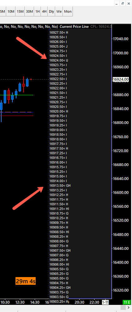

[2024-01-21 03:08:44]
User895355 - Posts: 57
Ok, I'm getting there, you'll see the price displayed in the
DrawToChart(HWND WindowHandle, HDC DeviceContext, SCStudyInterfaceRef sc)
window/rectangle on the right with letters next to them(The beginnings of a static TPO chart) in the attached image. Two things:
1. Can I make the window scrollable, or can I make that rectangle a scrollable list or something?
2. Frequently crashes Sierra. I have this:
if (sc.LastCallToFunction || sc.IsFullRecalculation)
if (tpoMap != NULL)
sc.FreeMemory(tpoMap);
delete tpoMap;
sc.SetPersistentPointer(sc.Input[0].GetInt(), NULL);
tpoMap = NULL;
return;
Since I'm also using an "iterator" ->
std::map<float, std::vector<char>>::iterator it;
do I need to delete and free up that memory too?

[2024-01-21 11:08:54]
User431178 - Posts: 910
Re-read this - ACSIL Programming Concepts: Allocating Memory for Classes - the section titled Allocating Memory for Classes
Or simply change your code to reflect that shown by User719512
No.
The iterator is a type based on the characteristics of your container, and you are not allocating memory for it on the heap.
If you want help fixing this, you will need to share more of the code, it is impossible to know with certainty where you are going wrong otherwise.
Date Time Of Last Edit: 2024-01-21 16:23:15

[2024-01-21 16:22:22]
if (currentBar < newYorkStart || currentBar > newYorkEnd)
return;
The above code should be below the LastCallToFunction block, and probably below the block where you allocate the new map.
Why?
What happens if you remove the study outside of NY hours? You would never clean up the memory that you allocated.
What happens when you recalculate the chart? You may well delete the map and not reallocate it, but the DrawToChart function is still being called, maybe with an invalid pointer being used.
You could set the below when you recalculate the chart.
sc.p_GDIFunction = nullptr
That would prevent the DrawToChart function being called until you do actually reallocate the map.
And what about the code that you use for drawing? Do you check that the persistent pointer is valid?
Date Time Of Last Edit: 2024-01-21 16:22:58
[2024-01-21 16:56:44]
Wow, thanks for your help! I've made those changes and it's not crashing now at all. Please see the changes I've made:

SCString pointer = "<";
if (sc.Close[sc.Index] == it->first)
val.Format("%.2f %s %s", it->first, chars.c_str(), pointer.GetChars());
else
val.Format("%.2f %s", it->first, chars.c_str());
sc.Graphics.DrawTextAt(val, sc.StudyRegionRightCoordinate - 200, (sc.StudyRegionTopCoordinate + 5) + count);
count += 8;
/* n_ACSIL::s_GraphicsPen MarkerPen;
MarkerPen.m_PenColor.SetColorValue(COLOR_WHITE);
MarkerPen.m_PenStyle = n_ACSIL::s_GraphicsPen::e_PenStyle::PEN_STYLE_SOLID;
MarkerPen.m_Width = 2;
sc.Graphics.SetPen(MarkerPen);
sc.Graphics.MoveTo(sc.StudyRegionRightCoordinate - 150, sc.RegionValueToYPixelCoordinate(sc.Close[sc.Index], sc.GraphRegion));
sc.Graphics.LineTo(sc.StudyRegionRightCoordinate - 200, sc.RegionValueToYPixelCoordinate(sc.Close[sc.Index], sc.GraphRegion)); */
return;
[2024-01-21 17:09:56]
Ok, good.
Not important, but if you like brevity, you might also like the auto and using keywords in c++.
[2024-01-24 06:53:01]
The problem I'm facing now is the tpo values are real-time. When I reload the chart the previous(historical) data is missing. What's the best way to grab that historical data first before the real-time kicks in again?
