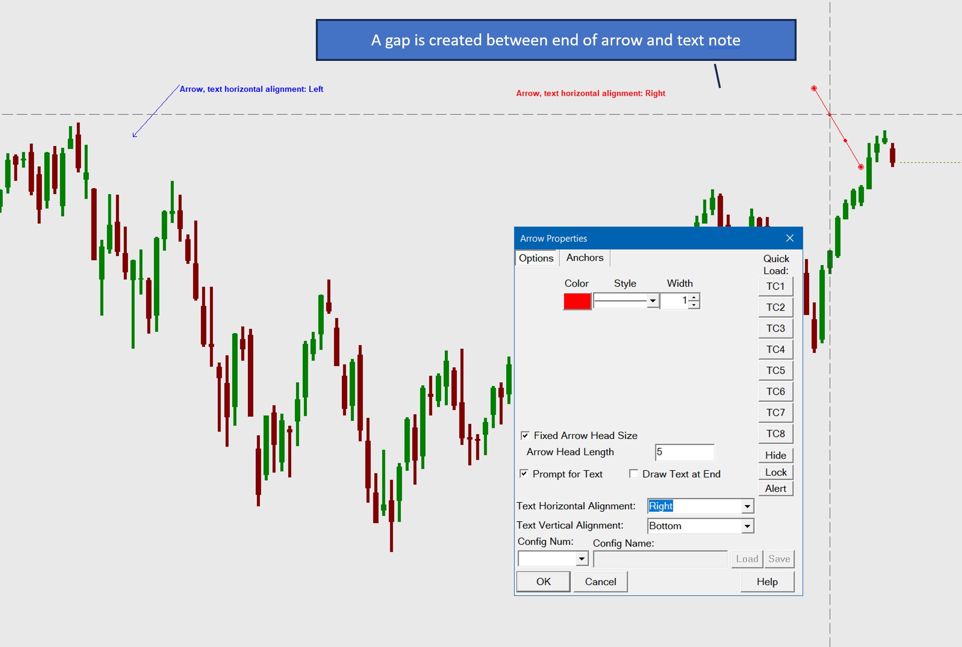

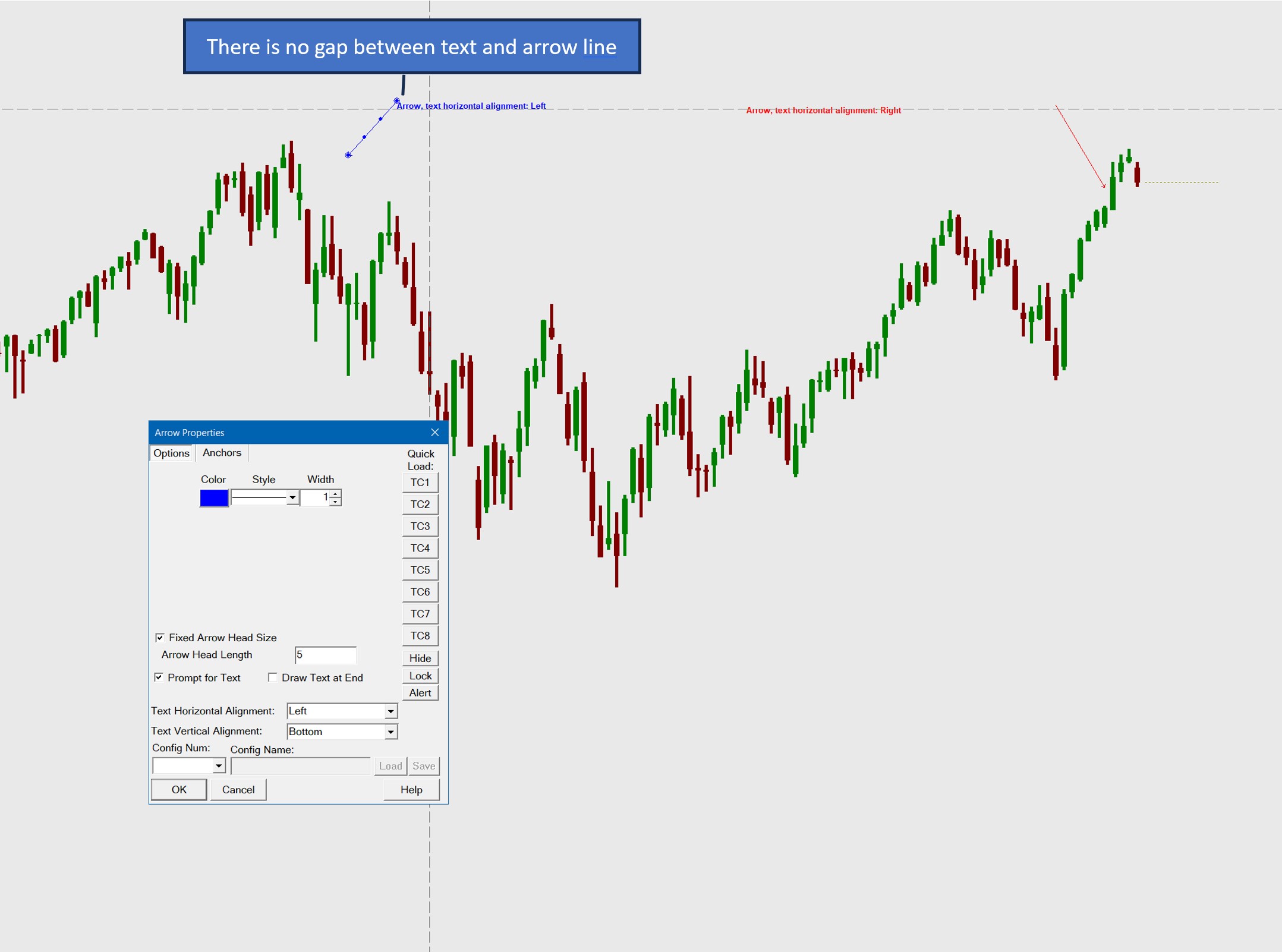

I am using Arrow drawing tool with text notes (I have "Prompt for Text" enabled in Arrow settings). If I use a setting "Text Horizontal Alignment: Left" for Arrow tool, then the note looks nice (screenshot "Left text alignment.jpg" - attached, arrow in blue colour).
However if I use "Text Horizontal Alignment: Right" then there is a gap between end of text and start of the arrow (screenshot "Right text alignment.jpg" - attached, arrow in red colour).
I also noticed that this setting doesn't get saved, I mean if I select "Text Horizontal Alignment: Right" in "Arrow Properties" window > click "OK" > then go back to "Arrow Properties", then the "Arrow Properties" box says "Text Horizontal Alignment: Left".

Can you please advice how to avoid this gap between the arrow and text?
imageLeft text alignment.jpg / V - Attached On 2024-01-06 10:51:12 UTC - Size: 229.79 KB - 149 views
imageRight text alignment.jpg / V - Attached On 2024-01-06 10:53:50 UTC - Size: 212.42 KB - 252 views

[2024-01-06 18:14:48]
User719512 - Posts: 522
Nice find.
I see this bug on v2580 and the gap when right aligned and the "gap" appears to be equal to the width of the text. Seems like there is a "TextSize.Width*2" in the code where there should just be a TextSize.Width.
Also see the bug with the dots rendered outside the start/end when the Arrow is down and vertical.
Also happens with the Line drawing tool and Parallel Lines tool when drawn down and vertical and when selected.
So +1 on this bug Ben000.
[2024-01-07 02:51:15]
We will resolve these in the next release.
The reason for the misalignment has to do with the alignment being done at a common point through the creation of a bounding rectangle. And when the text is outputted we should be using a left-top alignment but it is not using the default alignment at that point for this particular drawing type.
Date Time Of Last Edit: 2024-01-07 02:52:47
