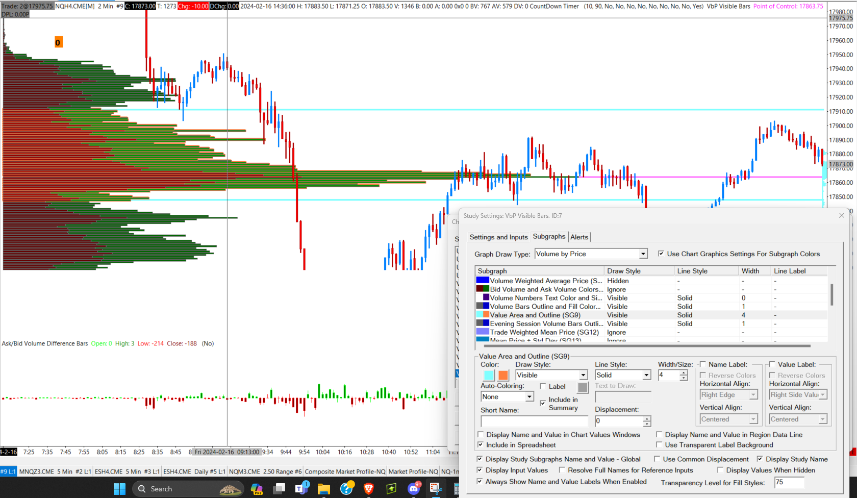

I'm able to control everything on the volume profile but the value area color ("Value Area High Value" and "Value Area Low Value" color. Something must be blocking it. Can you tell me what settings from the "Settings and Input" in Study Settings could do this.

I have the same issue. The Primary Color setting for SG9 should fill the Value Area does not fill the profile. It provides a line out similar to the POC that basically shows the high and low of the Value Area (cyan color). The secondary color does outline the value area as it should, but I don't want that at all (Orange color). However, I want the value area to be filled. For some reason the red and green fill colors do not go away and I have no idea how to change those. All the subgraphs that show red and green colors are set to ignore. I attached a screenshot for you to see. I appreciate any help you can provide. Tom
imageVolume Profile Issue Screenshot.png / V - Attached On 2024-02-18 00:25:37 UTC - Size: 446.53 KB - 236 views
[2024-02-19 15:35:45]
John - SC Support - Posts: 47955
Your Value Area is being colored, but since you have the "Bid/Ask Coloring" being used it is showing as a slightly brighter color than the standard Bid/Ask coloring.
If you want a specific color for the Value Area, then you would need to turn off the Bid/Ask coloring. Refer to the following:
Volume By Price Study: Bid Volume and Ask Volume Coloring Method
