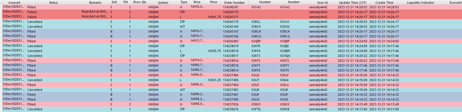

I added onto my position at 16916 and my original TP at 16924/25 had a profit based on original entry of 16898 profit line was set at$89. After adding in, that position lost profit, what's the point of adding on all I did was move my entry level way above, which even looked more that the half way level. I feel something is off, this is the first time I've seen this switch profits like that.

[2023-12-22 01:03:32]
RamRally - Posts: 35
MNQ
I uploaded a few things. The (2 - one exited 16913 Bracket pair - the one at 15:17 entered at 16900 is one of the first entries, got out at 16924, my entry after placing the 2nd at 16916 moved up to 16912. That $46.50 closed much less right before I entered that 2nd the TP profit was at $89. I feel like this screwed me over. Moved my entry way above half point and took my profit down. Entering another position was pointless and put me at more risk lessening profit and moving entry so high.

imageScreenshot 2023-12-21 185749.png / V - Attached On 2023-12-22 00:59:29 UTC - Size: 37.91 KB - 182 views
