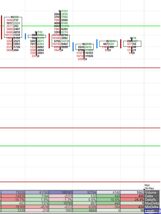

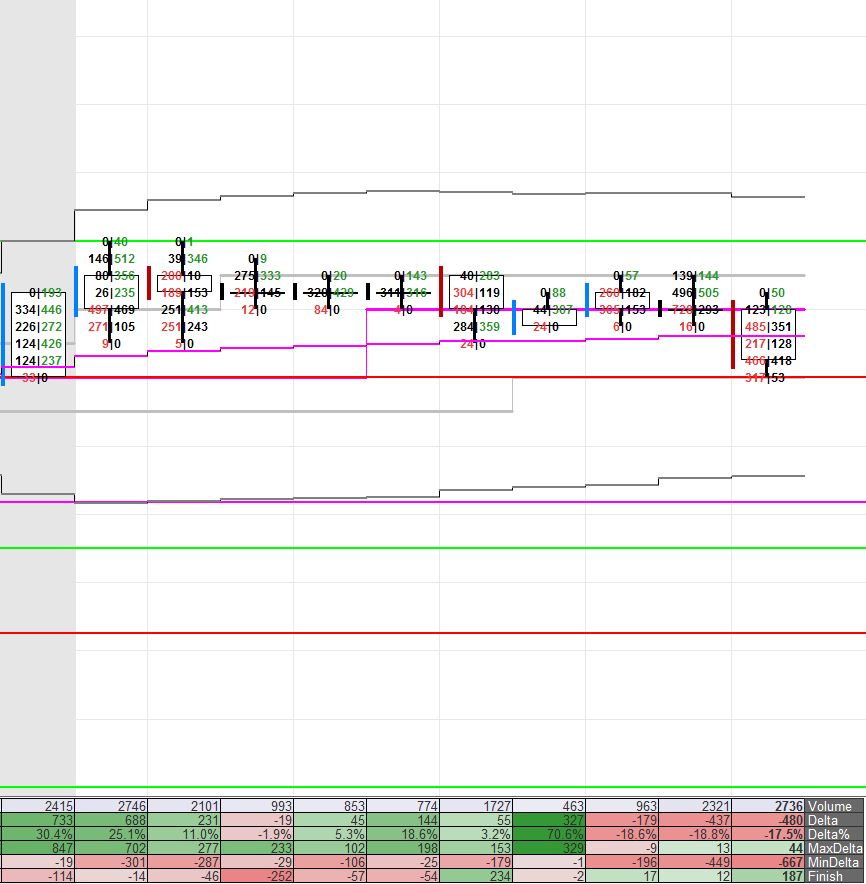

I would like to add one statistic with numbers bars calculated values, if it's possible
it's called finish delta with MarketDelta
Finish delta is pull back from max or minimum delta
I join a chart
Date Time Of Last Edit: 2013-05-05 13:49:12
imagefinish delta.JPG / V - Attached On 2013-05-05 13:49:08 UTC - Size: 78.36 KB - 1552 views
[2013-05-05 13:48:20]
user85017 - Posts: 37
sorry picture mistake
this one is good one
imagefinish delta.JPG / V - Attached On 2013-05-05 13:48:16 UTC - Size: 78.36 KB - 1445 views

Yes, I would also like to see the same values bar added to the Sierra Chart numbers bar charts. This is an excellent suggestion. Please add these values asap. Thanks in advance to SC support for accomplishing so much in so little time.

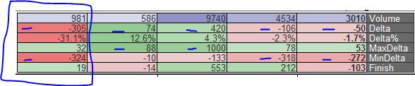

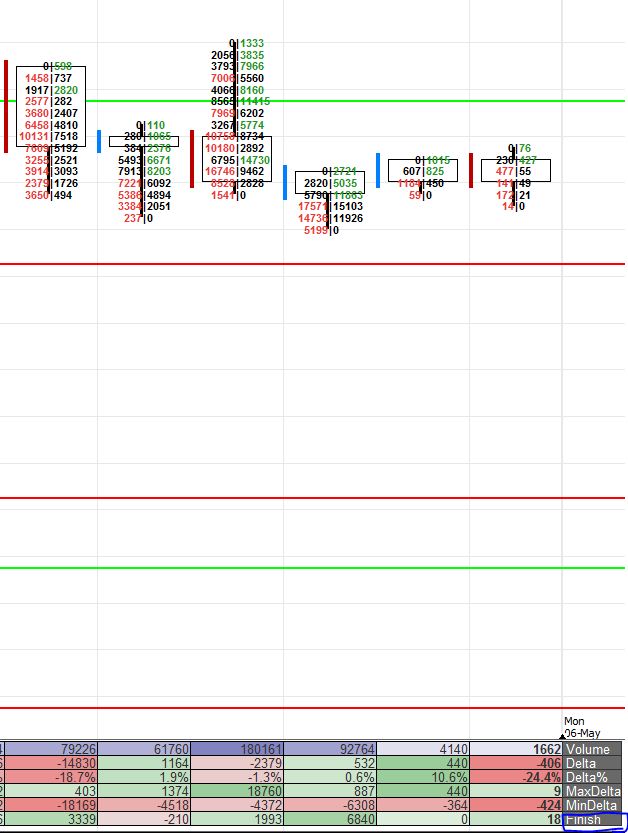

[2013-05-06 13:52:59]

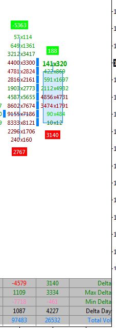

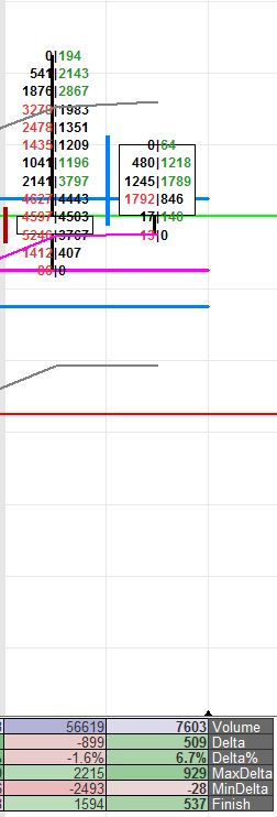

No it's not the rigth numbers
in MD the finish is 1594 so it's MIN DELTA- DELTA
in sierra the MIN DELTA is -7718 and DELTA is -4579 so the finish sould be 3139 and as you see on the picture, it's not
Date Time Of Last Edit: 2013-05-06 14:34:17
imagefinish md.JPG / V - Attached On 2013-05-06 14:33:53 UTC - Size: 36.62 KB - 1070 views
imagefinish sierra.JPG / V - Attached On 2013-05-06 14:34:10 UTC - Size: 31.99 KB - 1009 views

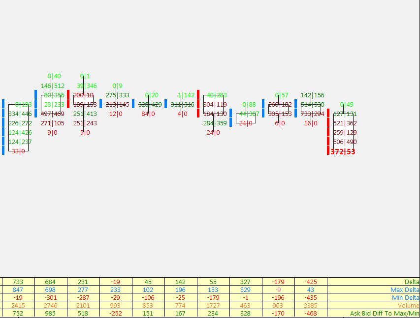

hello,
i don't think it"s going to work as you can see on pictures
in fact, the result is not rigth
imageMD.JPG / V - Attached On 2013-05-08 06:21:10 UTC - Size: 102.76 KB - 937 views
imageSIERRA.JPG / V - Attached On 2013-05-08 06:21:26 UTC - Size: 66.13 KB - 939 views

[2013-05-08 08:37:47]
as you can see on the picture, the Finish Delta is :
Delta - Highest (Max or Min)
exemple : first column : Delta = (-305) - MinDelta (-324) = Finish Delta +19
Delta is always the first number to subtract or add (depend if - or +) to the Max or Min Delta
Date Time Of Last Edit: 2013-05-08 18:44:49

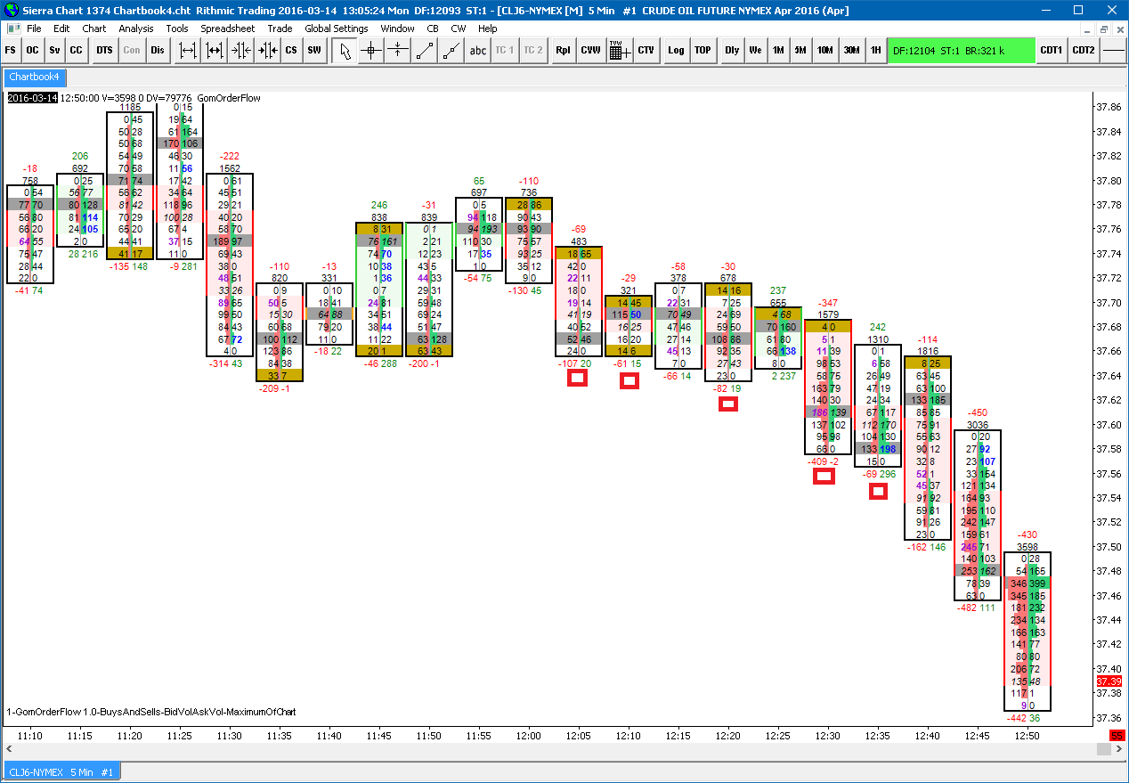

[2016-03-14 12:10:46]
gomifromparis - Posts: 244
OK thanks, will keep the space warm for it on the ladder..
Date Time Of Last Edit: 2016-03-14 12:10:56
imagegomladdersierra.png / V - Attached On 2016-03-14 12:10:19 UTC - Size: 89.51 KB - 957 views

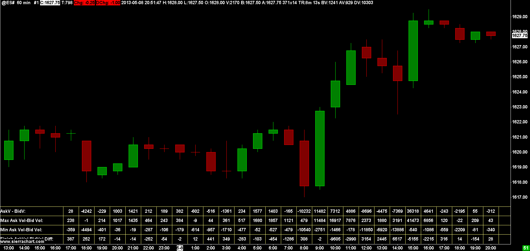

2garin - Posts: 189
Good Day a support.
When you create (compared to) similar charts of MD in the indicator Numbers_Bars_Calculated_Values errors appear. The errors related to the calculation of the parameter "Finish Ask Volume Bid Volume Difference (Finish AskVol BidVol Diff)". When you create a chart completely removed and re-loaded historical data.
Probably the screenshot you can help localize the error.
Date Time Of Last Edit: 2016-03-20 14:38:42
image55.jpg / V - Attached On 2016-03-18 16:49:58 UTC - Size: 287 KB - 1108 views
image56.jpg / V - Attached On 2016-03-18 16:57:18 UTC - Size: 115.26 KB - 1020 views
image57.jpg / V - Attached On 2016-03-20 14:38:35 UTC - Size: 265.8 KB - 1682 views
