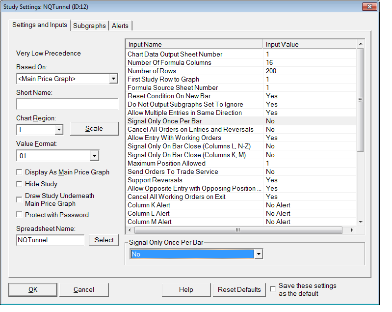

[2014-07-23 01:35:55]
vegasfoster - Posts: 444
Try this
image1.png / V - Attached On 2014-07-23 01:35:25 UTC - Size: 39.47 KB - 668 views
image2.png / V - Attached On 2014-07-23 01:35:29 UTC - Size: 43.37 KB - 560 views

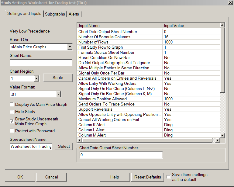

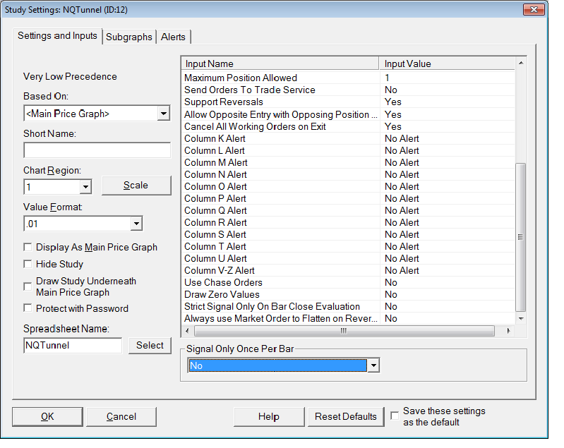

[2014-08-04 19:15:29]
Sawtooth - Posts: 4359
If you want to reverse position intrabar, this will do it:
K3:
=IF($J$8=0,CROSSFROMBELOW(E3:E4,AA3:AA4),E3>AA3)
M3:
=IF($J$8=0,CROSSFROMABOVE(E3:E4,AA3:AA4),E3<AA3)
This will enter when flat comparing current values to those in the previous bar, then reverse intrabar thereafter. But this will cause multiple successive reversals as price oscillates across the EMA. This is not a winning strategy. To mitigate this, you could reverse position when price has moved n ticks beyond the EMA:
K3:
=IF($J$8=0,CROSSFROMBELOW(E3:E4,AA3:AA4),E3>AA3+$J$21*1)
M3:
=IF($J$8=0,CROSSFROMABOVE(E3:E4,AA3:AA4),E3<AA3-$J$21*1)
See attached for the settings I used.
imageinfpz.PNG / V - Attached On 2014-08-04 19:14:17 UTC - Size: 48.03 KB - 644 views
[2014-08-04 19:18:17]
