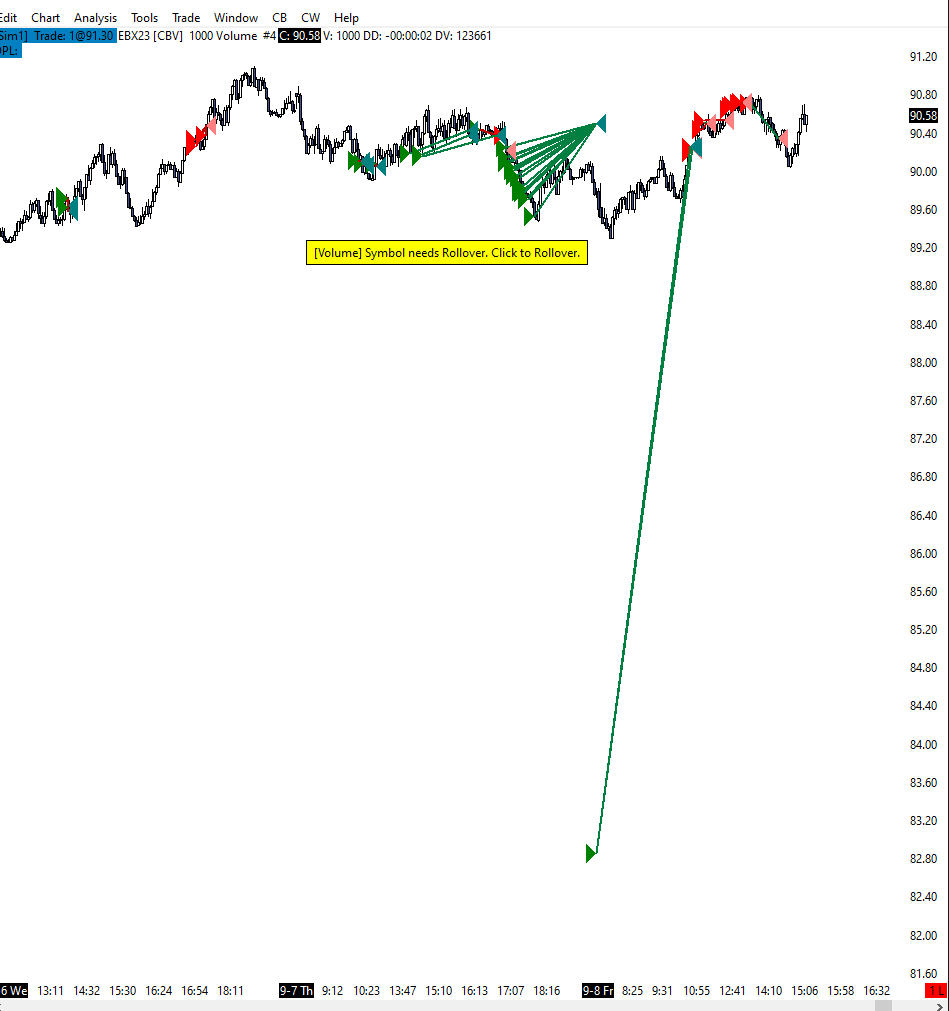

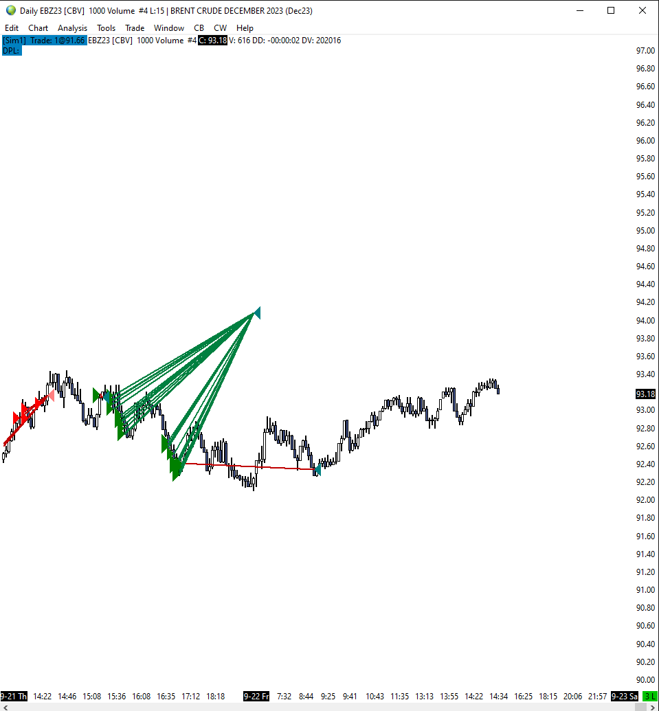

Hello, I am currently testing execution of overnight positions. I have attached a couple of screenshots of the strange real-time sim trading behavior where trades execute at prices the candles haven't been (all of the trades referred to here are traded in real time, not replay, and in sim).
I have adjusted number of stored time and sales records from 4000 to 5000 based on previous help articles I have read on this, but don't think this is the problem.
In the first screenshot attached I am trading IQFEED Brent EBZ23 in real time (not replay) and waiting till EOD/overnight while the trade plays out. In this case I left on a trade ~32 lots, and a limit order for around 30 lots for exiting the trade. In this case I chose most of the trades as EOD, rather than GTC, meaning most will cancel at the end of the day. However, the bulk of the exit has occurred at a price that the market hasn't traded.
The second screenshot is of another couple of examples of this behavior with a strange EOD and entry price. This isn't just a visual problem, as it also goes into the PnL and trade stats.
What does this mean for live trading in this situation? I assume it would have just executed at the market rate rather than what SC gives here. I like the functionality SC has for auditing trading performance and trades so the record being inaccurate is a problem. Any help appreciated, thanks.

imageSierra Charts Exit 1.PNG / V - Attached On 2023-09-22 14:00:57 UTC - Size: 39.59 KB - 327 views
imageSierra Charts Exit 2.PNG / V - Attached On 2023-09-22 14:01:05 UTC - Size: 35.23 KB - 284 views

They're not going to change their algorithm.
There is no algorithm involved.
For example, when the market trades THRU an order price, sc.SIM will not necessarily generate a fill.
This could not be the case and there must be some explanation in your case why this would happen.
Also, when a market order goes out, sc.SIM will sometimes generate impossible fill prices.
This is not true either. Sierra Chart does not generate fill prices. A market order will be filled according to the current bid and ask prices. You have to look at what those were at the time.
There is an explanation for everything in your case. It is impossible for us to say what happened in the cases you describe. We do not have the information to answer the questions. Only you do.
Why? We do not know.
You are able to answer this question. We cannot. There are many variables involved that we do not know at all. From our perspective we do not know what happened in your particular case. You are also using IQ Feed data which is not our data. Here is the relevant documentation:

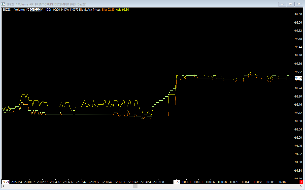

I've attached further information from activity log and using tick charts. As I said before, all these trades have been taken in real time with no chart replay used, and computer/SC was running in each of these cases.
Activity log shows the trade exited 30 lots on the limit order. At some point the data feed had the market with a tradeable bid/offer at 94.08 at 23:00:00.199 UK. Possibly a closing market dynamic as the Brent market hours are 1AM - 11PM UK on a Thursday- but it is dollars away from the last traded price, 92.24.
In these situations I would rather the simulated orders were linked to the last traded price, not the implied bid/offer prices available, when the market hasn't traded any volume in this area and could be down to data feed error. Anything that would allow the trades to carry on into the next day without hinderance would be a positive.

imageSC Trade Activity 1 Volume Bar Trade Data 21-09-23.PNG / V - Attached On 2023-09-25 11:03:02 UTC - Size: 28.97 KB - 255 views
imageSC Trade Activity 1 Volume Bar Chart w Bid and Ask Price 21-.png / V - Attached On 2023-09-25 11:04:43 UTC - Size: 27.89 KB - 385 views

We used to do this in the past but then it would create inaccurate fills when the bid and ask, are both away from the last trade price, and the last trade price is old and then we are filling orders against old data:
We can always add an option for this behavior. Maybe that is the best thing.

The bid and ask prices that you see from the Bid and Ask Prices study :
https://www.sierrachart.com/Download.php?Folder=SupportBoard&download=87611
Only show the bid and ask prices when there is a trade. If these are changing to out of range values, when the market is closed, and then an order is filled against those out of range bid and ask prices, then you are going to get an out of range fill price according to those bid and ask prices. Sierra Chart trade simulation mode does not know when a market is open or closed. This information will be added to the documentation.
