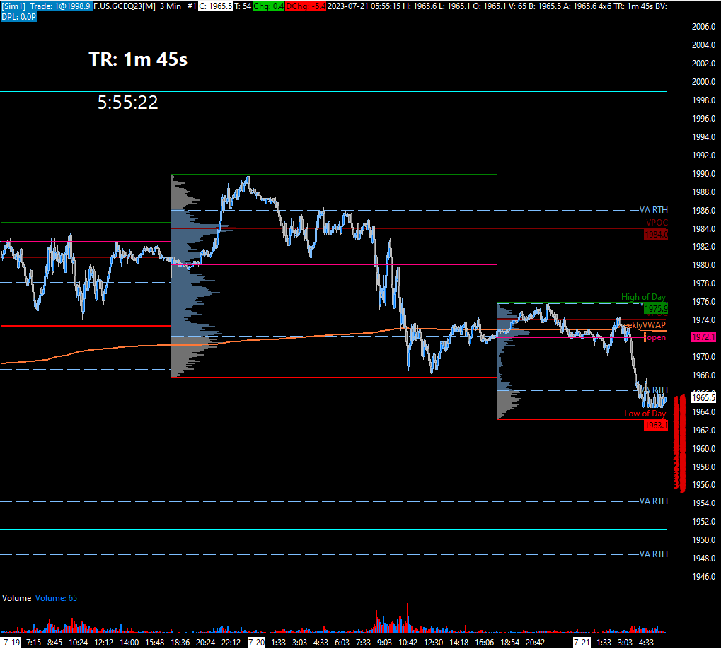

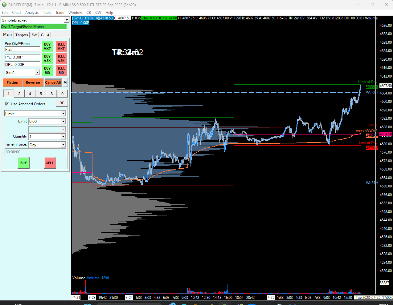

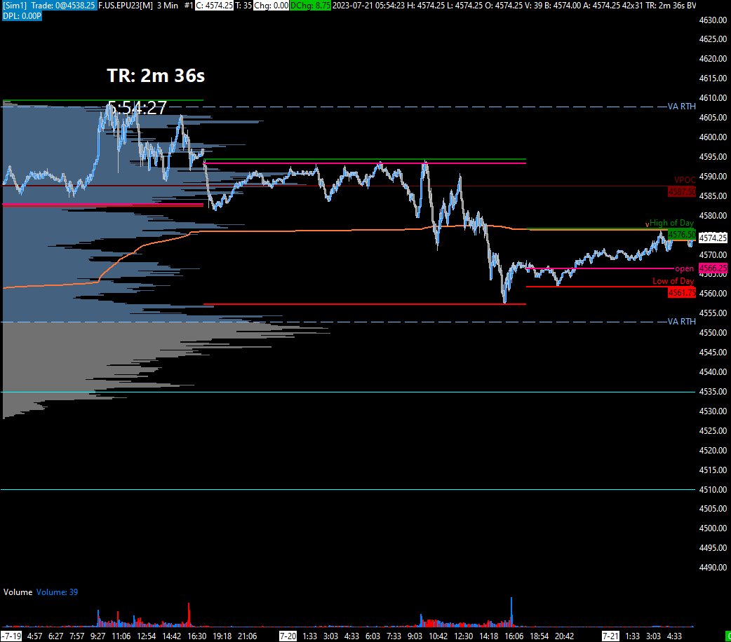

I have a problem. My September contract of the sandp 500 is not displayed correctly. I have already opened it in another chartbook and it does not work either. If I open the eurusd or the december contract for example, it works. I have already reloaded the chart. please help me. Attached are two pictures, one of how it looks and one of how it should look. Kind regards Simon Deinlein
imageSierra chart ok.png / V - Attached On 2023-07-21 16:33:12 UTC - Size: 50.88 KB - 199 views
imageSierrchart problem.png / V - Attached On 2023-07-21 16:33:18 UTC - Size: 45.75 KB - 202 views
[2023-07-21 16:34:21]
The contract itself is not displayed incorrectly, it is just your Volume by Price profile that is not as you are expecting.
Check the settings for the Volume by Price study. It looks like you have the "Volume Graph Period Type" set to "Visible Bars", but it looks like you want it to be "Multiple Profiles Based on Fixed Time". Refer to the information here:
Volume By Price Study: Volume Graph Period Type

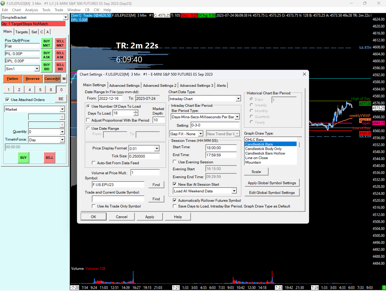

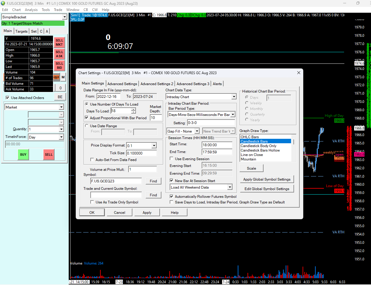

Hello, you were right, I had visible bars inside. You said that I now need "multiple profiles based on fixed time" in my studies, but unfortunately I can't set this up. could you please explain this to me. Many thanks and kind regards simon
imageGold session times.png / V - Attached On 2023-07-24 10:10:31 UTC - Size: 115 KB - 195 views
imageSnadP 500 Session times.png / V - Attached On 2023-07-24 10:10:42 UTC - Size: 111.73 KB - 182 views
[2023-07-24 19:11:42]
The option for "Multiple Profiles Based on Fixed Time" is part of the Volume by Price study. Refer to the following:
Volume By Price Study: Multiple Profiles Based on Fixed Time

sdeinlein - Posts: 13
Ich habe alles so eingestellt und habe es auch geändert. Leider ist der Fehler immer noch da kann es sein das der Fehler bei euch liegt. Denn wenn ich zum Beispiel Crude Oil, Gold oder einen anderen Chart öffne funktioniert es. Der Dezember Kontrakt vom Sand P wird auch richtig angezeigt. Auch der Kontrakt vom micro e mini wird richtig angezeigt. Ohne das ich etwas an denn einstellungen geändert habe.
[2023-07-25 16:43:54]
From Google Translate:
I set everything up and changed it. Unfortunately, the error is still there, it may be that the error lies with you. Because if I open Crude Oil, Gold or another chart, for example, it works. The December contract of the sand P is also displayed correctly. The micro e mini contract is also displayed correctly. Without having changed anything in the settings.
What exactly are you seeing and how is your Volume by Price study setup?

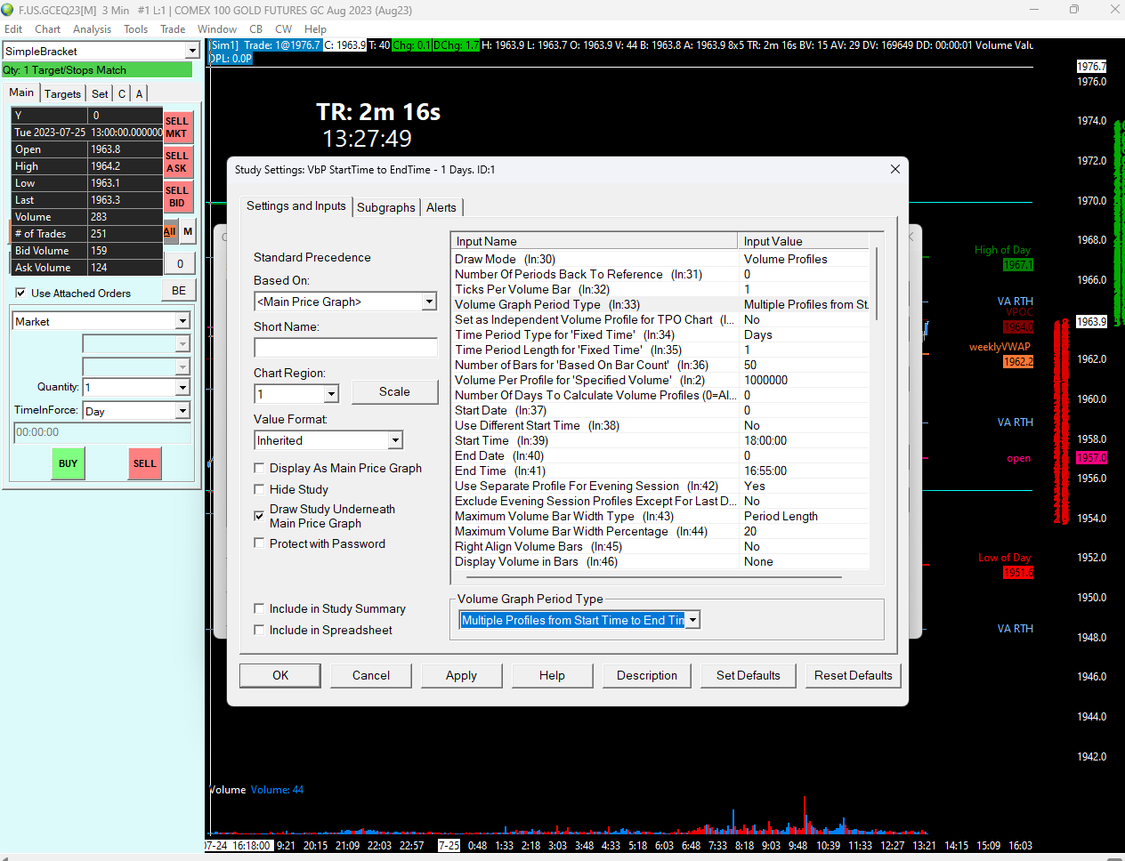

[2023-07-25 17:30:10]
is this picture also ok ?
imagevolumen sierra.png / V - Attached On 2023-07-25 17:29:25 UTC - Size: 118.14 KB - 179 views
[2023-07-25 18:08:48]
We see that your Volume Profiles are set to "Multiple Profiles from Start Time to End Time" and that you have the times specified as "18:00" and "16:55". But we do not see the Volume Profile and why you believe that it is incorrect for these settings.

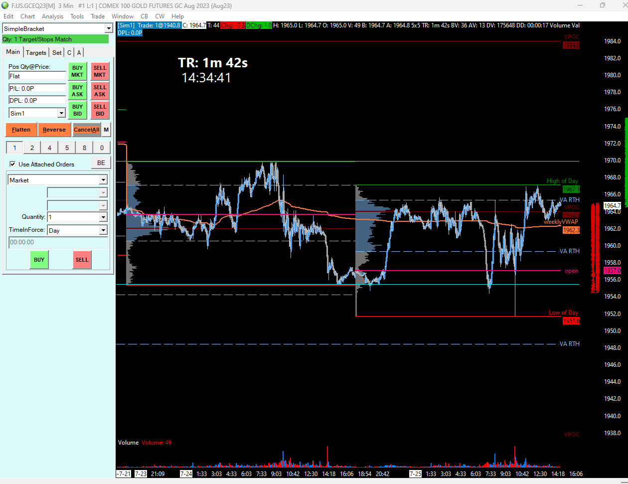

[2023-07-25 18:36:43]
the volume profile should always be displayed per day. It should look like on the gold chart and not like on the sandP chart.

[2023-07-26 13:19:48]
For the Gold chart, on the Volume by Price study, what is the "Volume Graph Period Type" set to?
