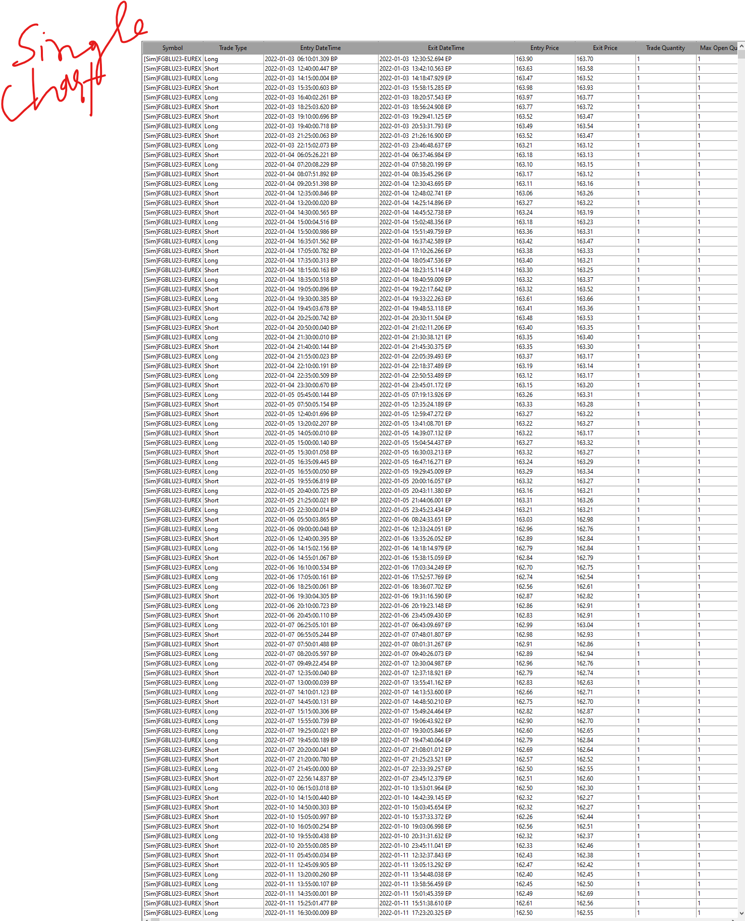

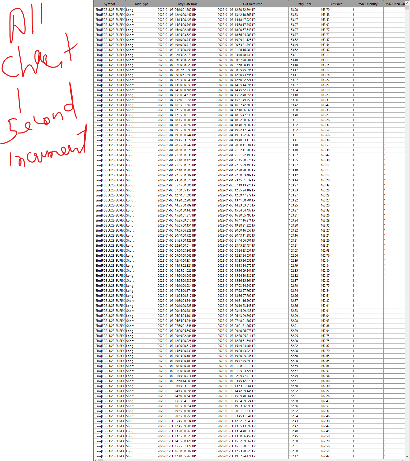

I have only one chart in the chartbook on which I am running my strategy. However, I am getting different results when I select different "Charts to Replay" option. Also, when I run the strategy for All chart in the chartbook (which contains single chart), all trades enter near the end of the minute and not at the point of time signal was generated. I have also observed that backtesting for all charts in chartbook happens at a faster rate. Please give some insights over this. I am also attaching few trades from the results for visualization.
imagesingle_chart_mode.png / V - Attached On 2023-07-11 10:30:51 UTC - Size: 140.77 KB - 227 views
imageall_charts_mode.png / V - Attached On 2023-07-11 10:34:24 UTC - Size: 133.33 KB - 224 views

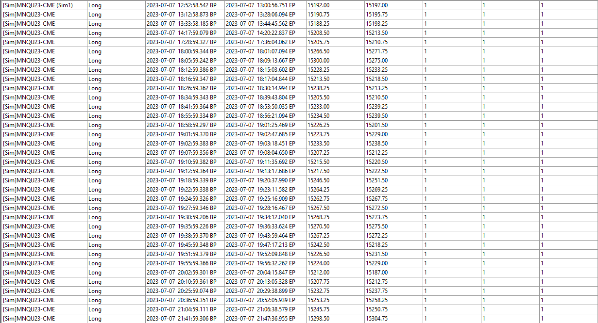

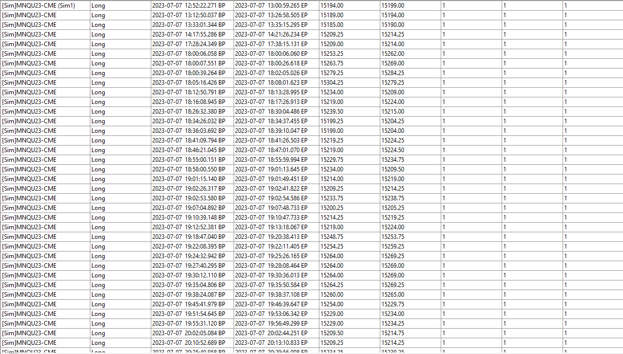

I AM SHARING WITH YOU TRADE LIST OF SINGLE CHART AND ONE IN WHICH ALL CHARTS(ONLY ONE CHART IN CHARTBOOK) HAS BEEN USED. YOU WILL OBSERVE THAT THERE IS STILL GAP OF MICROSECONDS
imageScreenshot 2023-07-21 144336.png / V - Attached On 2023-07-21 13:45:23 UTC - Size: 275.38 KB - 230 views
imageScreenshot 2023-07-21 135951.png / V - Attached On 2023-07-21 13:45:30 UTC - Size: 249.29 KB - 252 views
