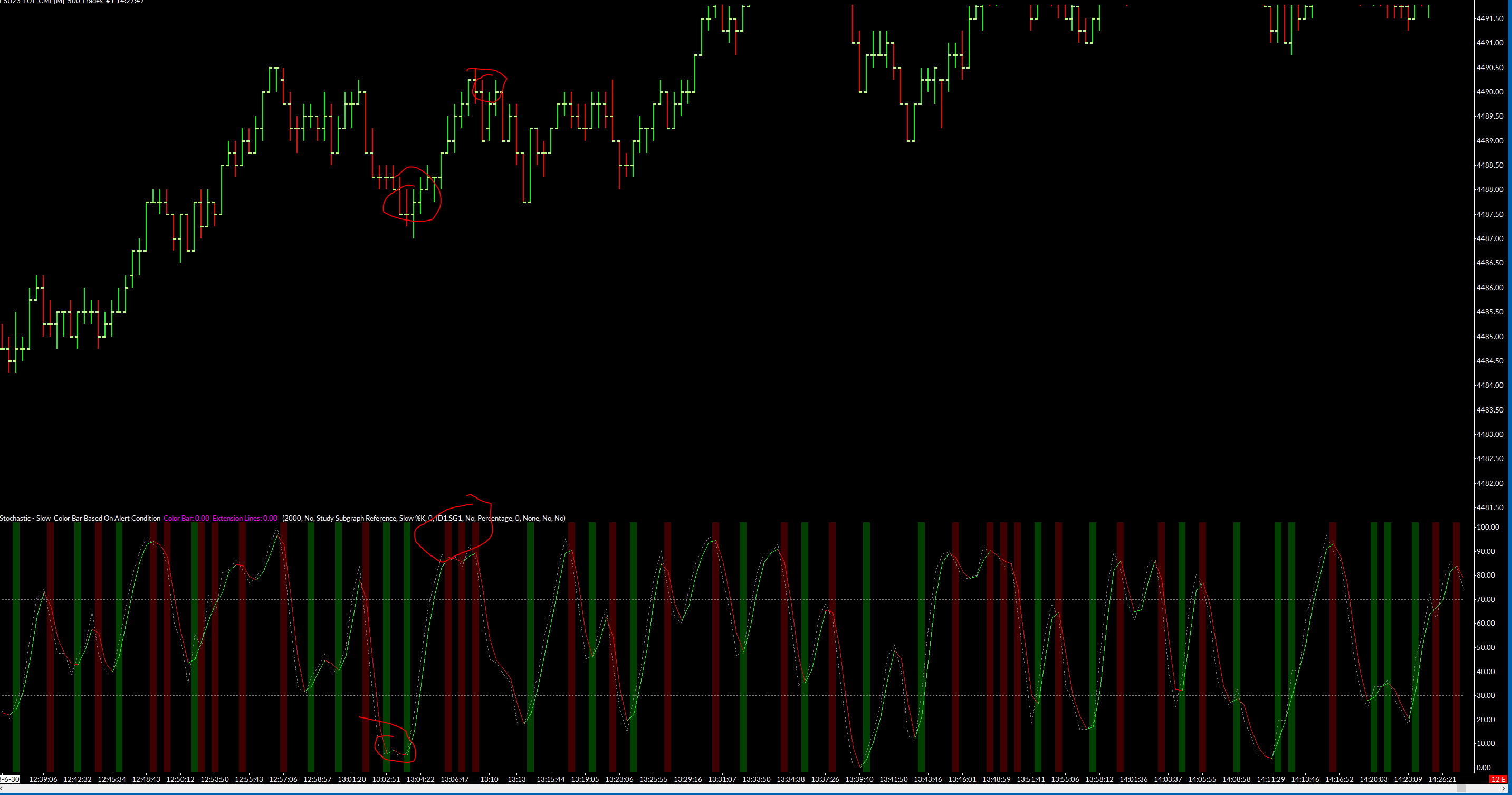

I got my code to highlight the background on stochastic cross however would prefer having dots/circle on low/diamond/arrow instead at the spot on bottom stochastics cross. I've attempted to do this but am unable to get the dots to show up vs background coloring which I find too busy. I'm looking for times there are 2-3 crosses in an extended market near each other. I find this signal pretty reliable but don't want the stochastics part of chart too big in order to be able to actually SEE these crosses.
In summary I don't want to color the background but instead want a colored dot near %k or d showing the cross will look cleaner and less distracting to my eye.
imageCapture.PNG / V - Attached On 2023-07-03 11:34:55 UTC - Size: 248.65 KB - 342 views

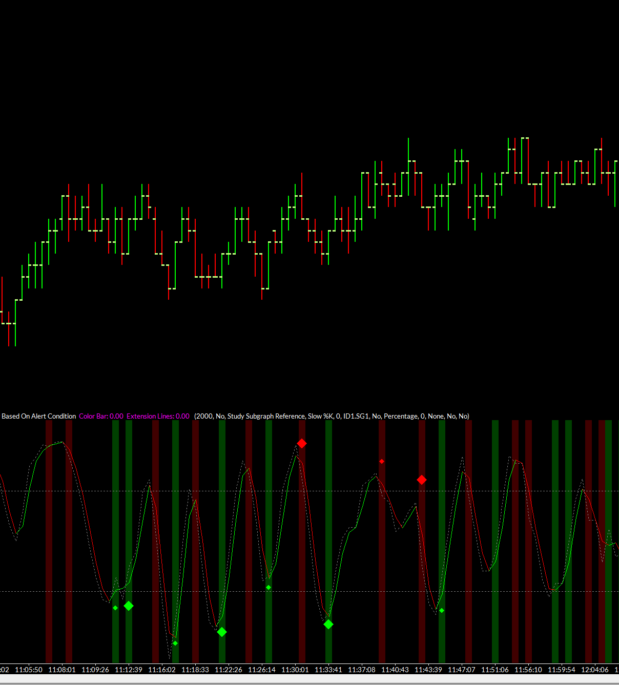

I thought it was clear from previous pic where if stochastic crossed UP background was green and when down red. Instead of coloring background I want a circle or triangle/diamond or whatever to mark the stochastics indicator which is on one of the bottom panes.
imageCapture.PNG / V - Attached On 2023-07-03 21:39:46 UTC - Size: 113.75 KB - 273 views

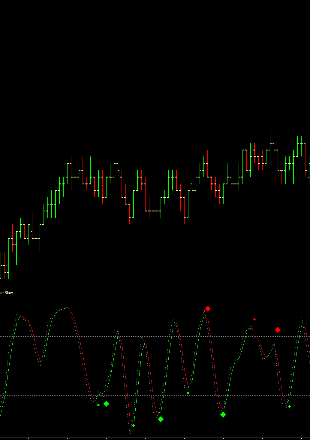

I hid the background coloring to show just the diamonds. I manually added this with drawing tools but want to have them showup on alert condition.
imageCapture.PNG / V - Attached On 2023-07-03 21:42:08 UTC - Size: 45.54 KB - 325 views
