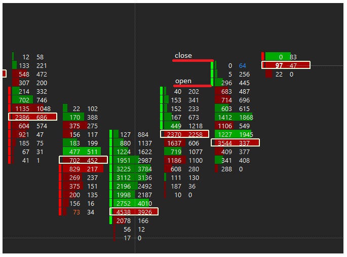

im looking for a range bar type which is based on the open - close range of the candle.
So if the range between open and close exceeds for example 12 ticks there should be a new candle created.
It seems that the existing range bar types cant handle this use case.
Regards,
Kai

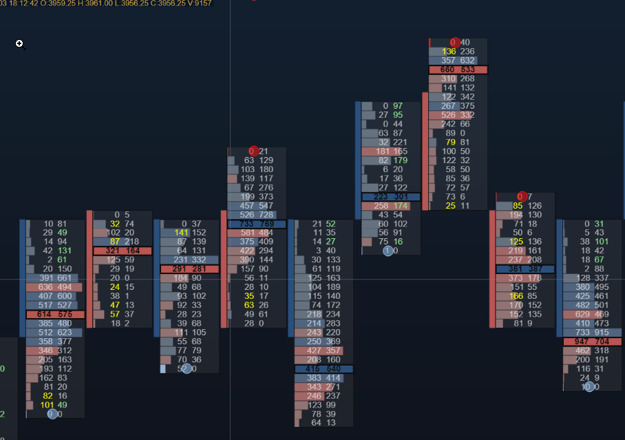

Kai - Posts: 10
my problem is another one. When i input a value of 12 ticks for example, the range of the whole candle consists of 13 ticks. But i want that amount of ticks for the range between open and close of each candle.
The attached screenshot shows what i see with Range Bar - True.
The range between open and close of a candle isnt 13 ticks for each candle. Its only 3 ticks for example.
