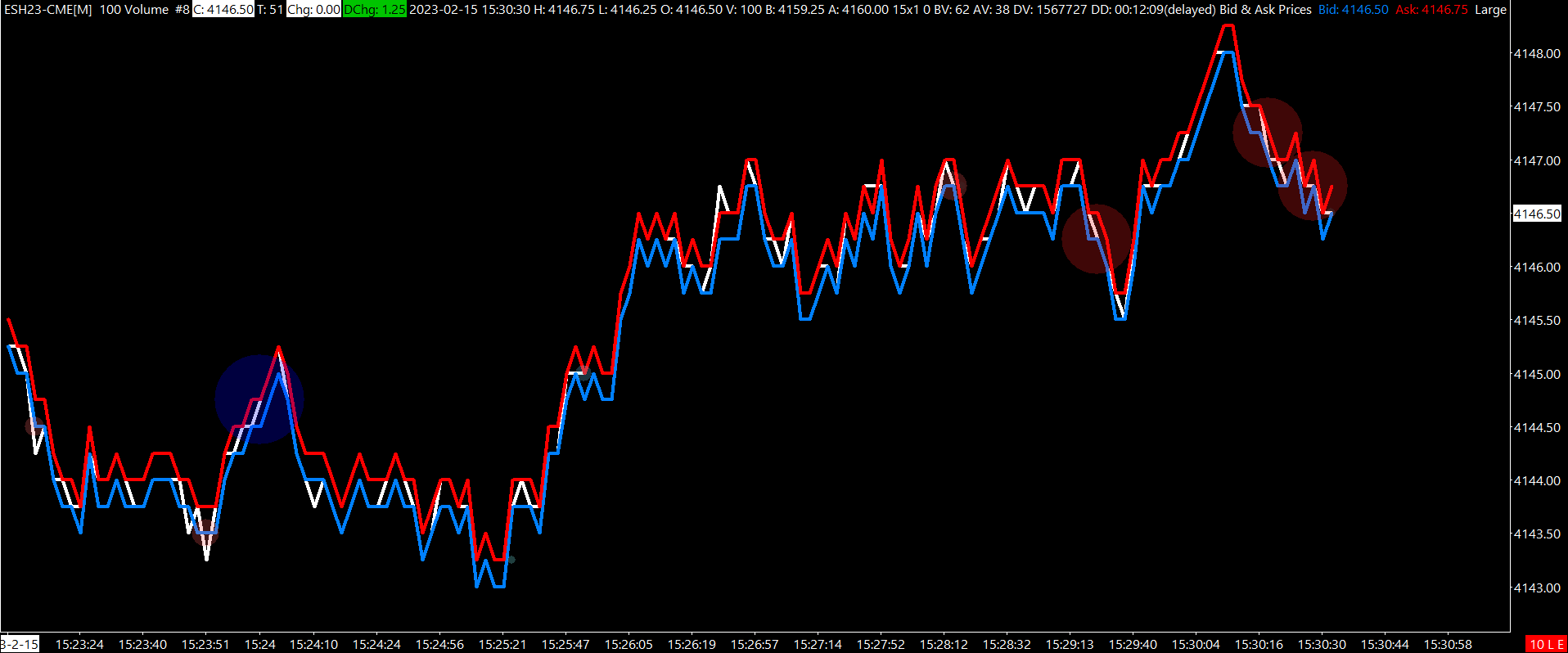

I've been noticing that my Market Depth Historical Graph (MDHG)stops displaying at certain times, today from 9:58 - 10:30 NY time
I have configured my trading Time Zone Settings to New York (-5EST/-4EDT)in Global Settings and my and my chart settings > session times to Start 09:30:00 /End 16:14:59. Also 16:15- 09@29:59 for the
ETH overnight session.
The other studies are fine just the MDHG.
Is there any reason why this happens?
Kind Regards
Stephen

Please give us a screenshot of what you are seeing so we can make sure we are fully understanding. Follow the instructions at the following link to get us a screenshot:

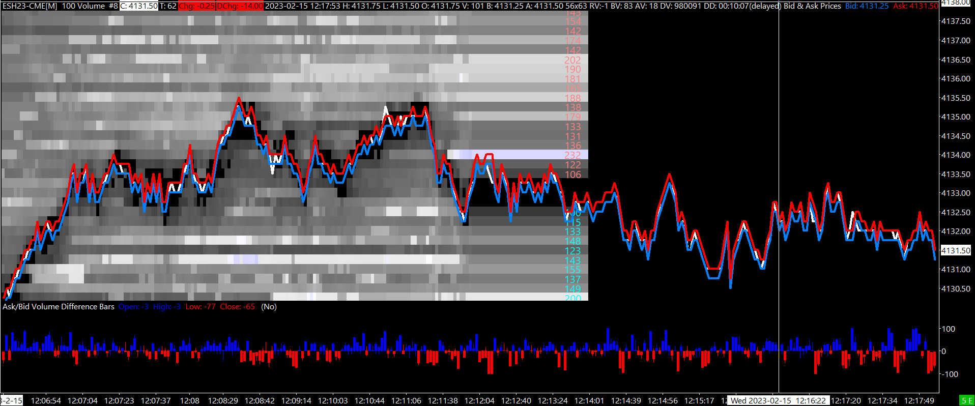

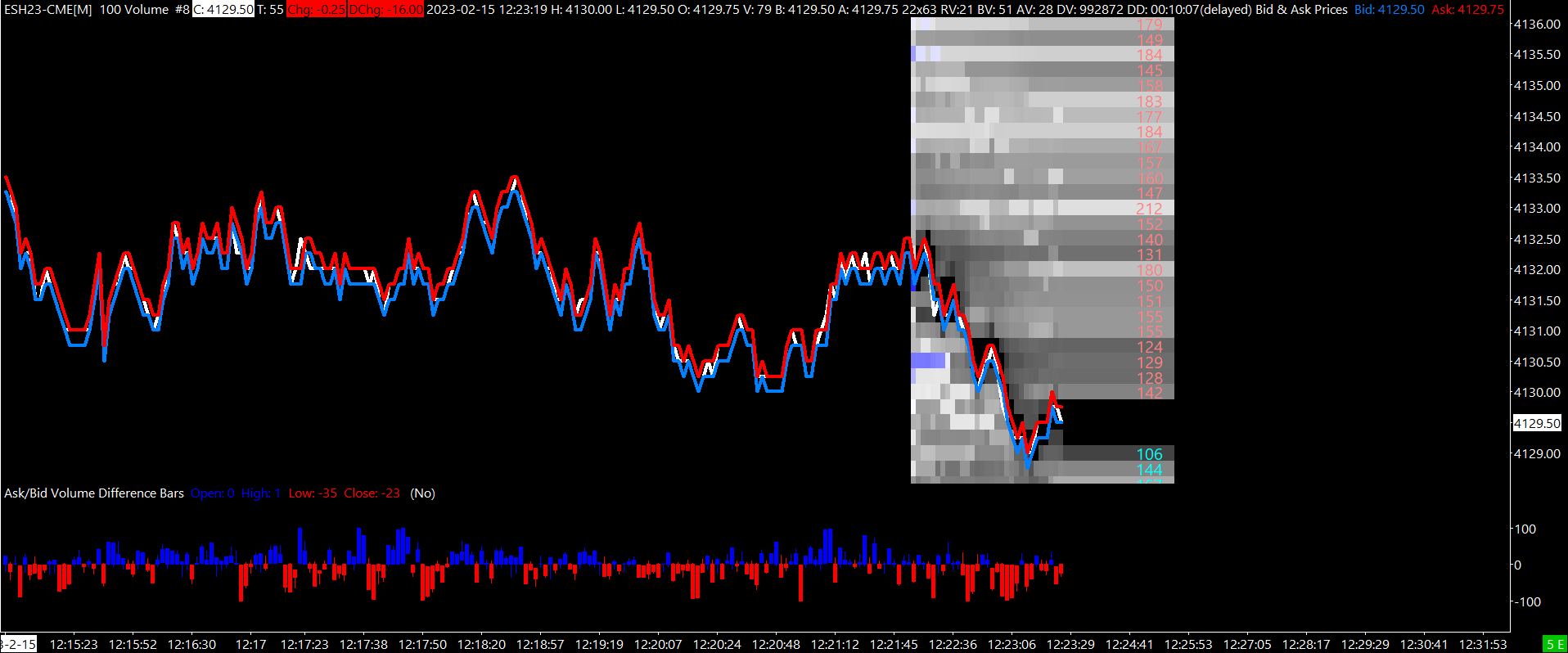

[2023-02-15 22:20:10]
Stav - Posts: 104
Hi John,
Please see two images first with Market Depth Historical Graph, second without it.
Many thanks.
Kind Regards
Stephen
imageESH23-CME[M] 100 Volume #8 2023-02-15 12_28_00.966.png / V - Attached On 2023-02-15 22:18:19 UTC - Size: 72.49 KB - 321 views
imageESH23-CME[M] 100 Volume #8 2023-02-15 12_33_27.512.png / V - Attached On 2023-02-15 22:18:34 UTC - Size: 58.71 KB - 305 views
imageUploadImage.png / V - Attached On 2023-02-15 22:19:33 UTC - Size: 39.54 KB - 270 views
[2023-02-15 22:29:13]
The first image (ESH23-CME[M] 100 Volume #8 2023-02-15 12_28_00.966.png) is showing something very interesting. The bar data is in the chart, but the MDHG is showing the information for "After Last Bar" within the data.
The only way we can think for this to occur is if your system had just downloaded historical data, which will be up to the current time. Since you are then on the Delayed Streaming Data, the current price information and market depth data is behind where the chart bars are located. It would then take 10 minutes for that data to "catch up".
But we really are not sure exactly what is occurring. Please make sure you have the system running for at least 10 minutes and see if your MDHG is at the end of your chart as it is supposed to be. If you are then missing some data for the MDHG, then try to redownload the missing data using the information we provided before.
Otherwise, if you are getting this kind of situation occurring frequently, where things are simply not lining up and you have not been disconnected at all, then let us know and we'll have to figure out where to go next.

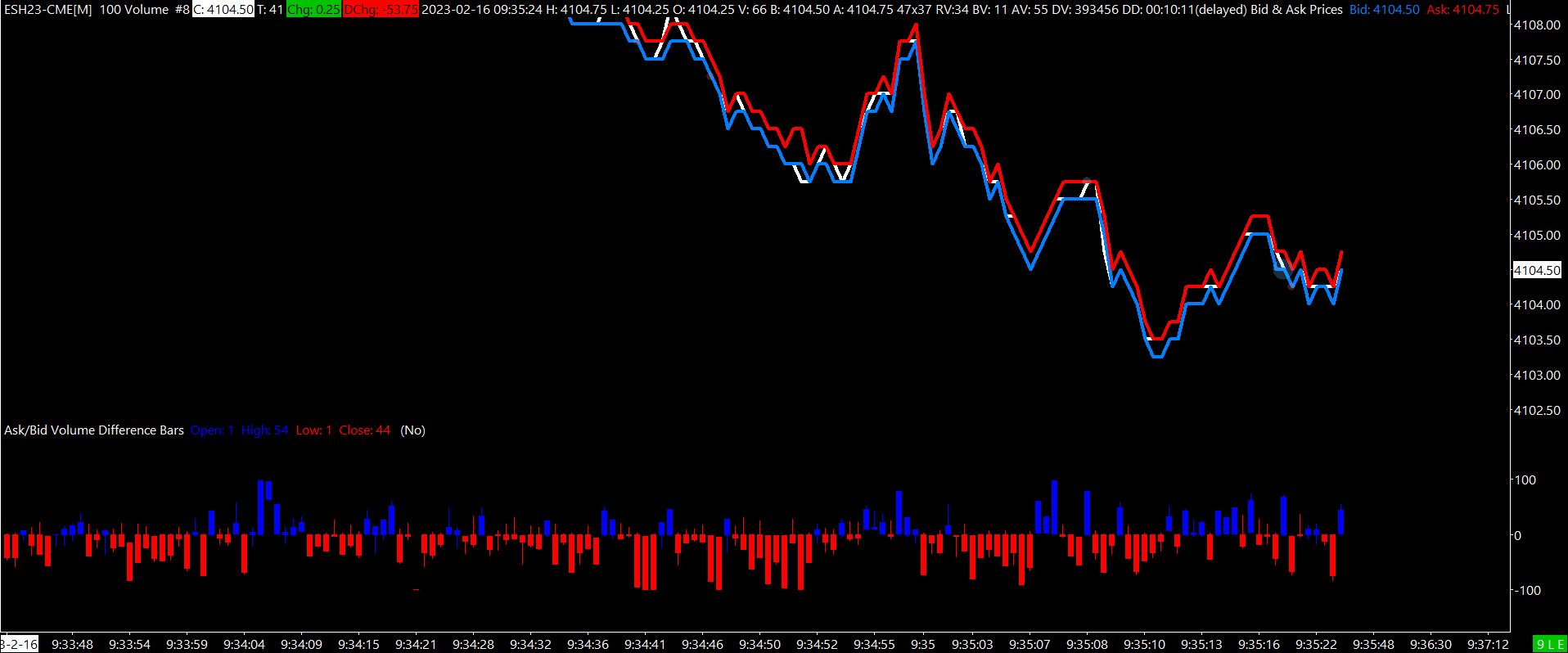

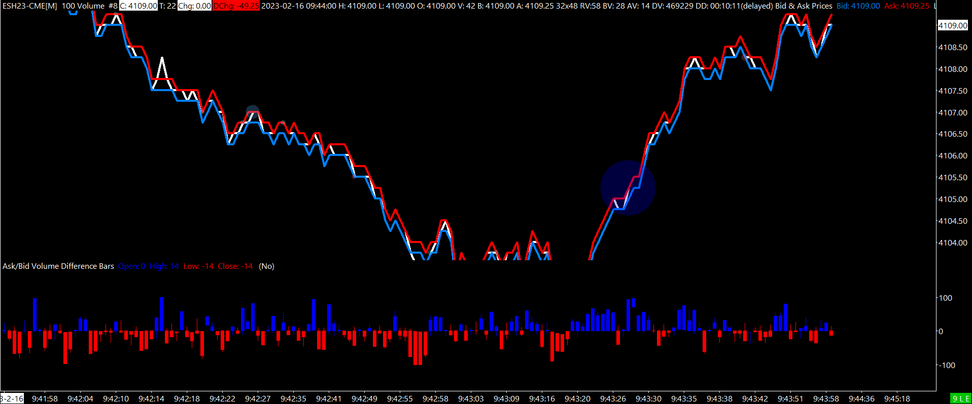

[2023-02-16 14:56:45]
Stav - Posts: 104
Hi John,
Problem still persist, not sure what to do.
I am right clicking and using the - Confirm Market Depth Download for ESH23-CME starting at 2023-02-16 09:36:18 984002 but it still doesn't populate with the MDHG data.
All my time settings are as above, very strange. I also connect and disconnect SC data feed but still nothing, strange that all the other studies are working fine though.
Not sure how we can move forward on this.
Please see screen shots.
Thank you for your help
Kind Regards
Stephen
imageESH23-CME[M] 100 Volume #8 2023-02-16 09_45_36.244.png / V - Attached On 2023-02-16 14:56:21 UTC - Size: 35.29 KB - 306 views
imageESH23-CME[M] 100 Volume #8 2023-02-16 09_54_12.448.png / V - Attached On 2023-02-16 14:56:32 UTC - Size: 38.93 KB - 214 views

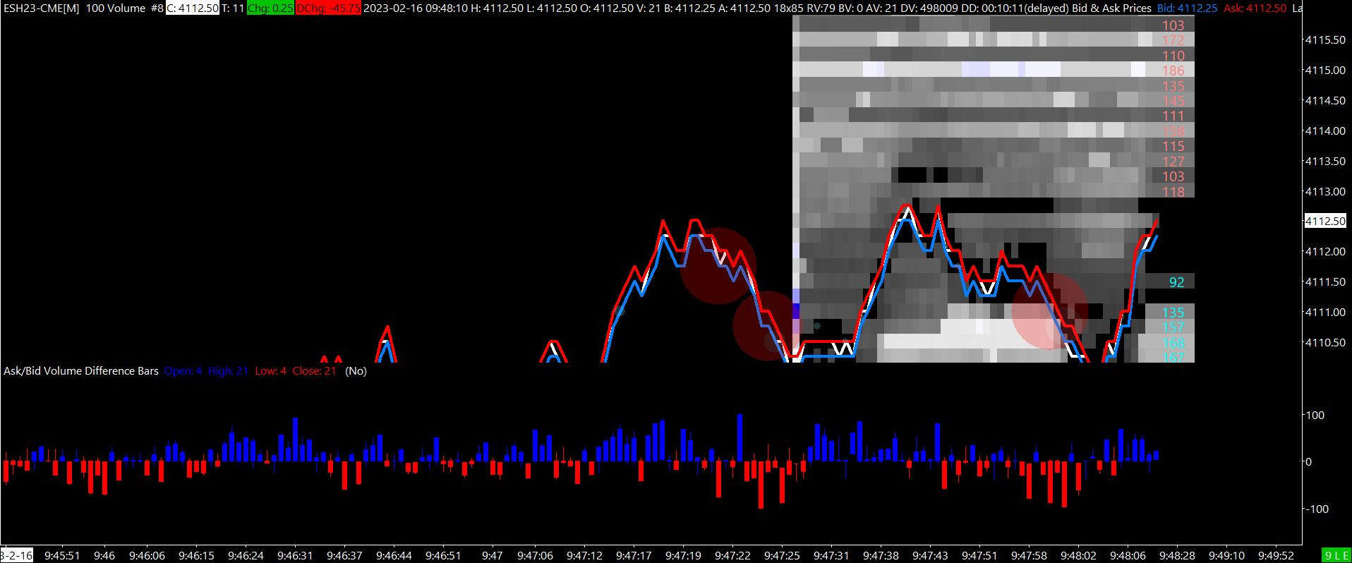

[2023-02-16 15:02:23]
Stav - Posts: 104
Hi John, SC
Just to add from last message to you at 14:56:21 (UK time) now its showing the MDHG data, but not sure
when it will stop again, see new image.
Thanks.
Kind Regards
Stephen
imageESH23-CME[M] 100 Volume #8 2023-02-16 09_58_21.665.png / V - Attached On 2023-02-16 15:02:05 UTC - Size: 49.22 KB - 291 views
[2023-02-16 16:38:08]
Stav - Posts: 104
Hi John SC,
Just to say working okay so far now. So maybe like you say its a catchup problem relating to my
delayed feed
Thanks.
Stephen

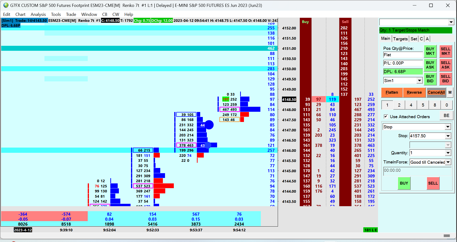

[2023-04-12 14:15:18]
Stav - Posts: 104
Hi Sierra Chart,
The problem with my MDHG is occurring fairly regularly.
I've checked the message log and there is no mention of download error (No windows error code).
MY instrument is ESM23 - June S&P mini futures.
Global trading Time Zone Settings to New York (-5EST/-4EDT).
Session Times: - 9:30 - 16:30 (Day) 16:31 - 09:29:59
The limit Bid/offers on the DOM different from MDHG please see screenshot below.
It becomes in sync when I Download Depth Data from Date-Time but not always, strange.
I've check my internet coonection and it seem fine and so really not sure why this is happening.
Kind Regards
Stephen
imageScreenshot (206).png / V - Attached On 2023-04-12 14:11:31 UTC - Size: 179.15 KB - 177 views
[2023-04-12 15:39:48]
What is the Input for Depth Quantity Type to Display After Last Bar set to?
[2023-04-12 16:52:04]
Stav - Posts: 104
Hi John,
It is set to Last Depth, should this be set to to Maximum Depth?
Number Of Minutes To Extend Last Known Depth - This is set to 60. Again maybe I should det this to 0 for all?
Thanks for your help.
Kind Regards
Stephen
[2023-04-13 14:28:49]
Having the "Depth Quantity Type to Display After Last Bar" set to "Last Depth" should give you a match between the Market Depth Historical Graph and the DOM.
Please get us a chartbook with that chart in it so we can take a look. We do not know why you are not getting a match. Follow these instructions to get us the chart:
[2023-04-13 14:44:25]
Stav - Posts: 104
Hi John,
Yesterday I set Number Of Minutes To Extend Last Known Depth to 0 (all) and the MDHG is displaying all the time so far.
I will send you a chartbook the next time when No MDHG showing or when the MDHG and DOM are not displaying same data for limit order depth.
Kind Regards
Stephen
[2023-04-13 19:07:35]
Stav - Posts: 104
Hi John,
Please see attached chartbook 4. I have deleted all other studies not relevant.
It shows how the bid/offer limit orders in the MDHG do not correspond to those shown in DOM.
Many thanks.
Kind Regards
Stephen
attachmentChartbook4.Cht - Attached On 2023-04-13 19:07:19 UTC - Size: 7.3 KB - 296 views
[2023-04-13 20:28:47]
If you can, please give us a screenshot of what you are seeing so we can match up the time.
[2023-04-14 14:29:45]
What we think is occurring is related to the fact that you are using the Delayed Market Depth data. As such, when you first start the system, or anytime you force a download of the data, the data itself is downloaded to the current time, and that is what you are seeing in the Market Depth data in the Market Depth Historical Graph. But the DOM is showing the delayed Market Depth data. So there will be a discrepancy between the data until the 10 minute delay has passed. After that point, the data should match up.
Please take a look at this and let us know if it matches what you see. It does for us, using your Chartbook (and our own).
