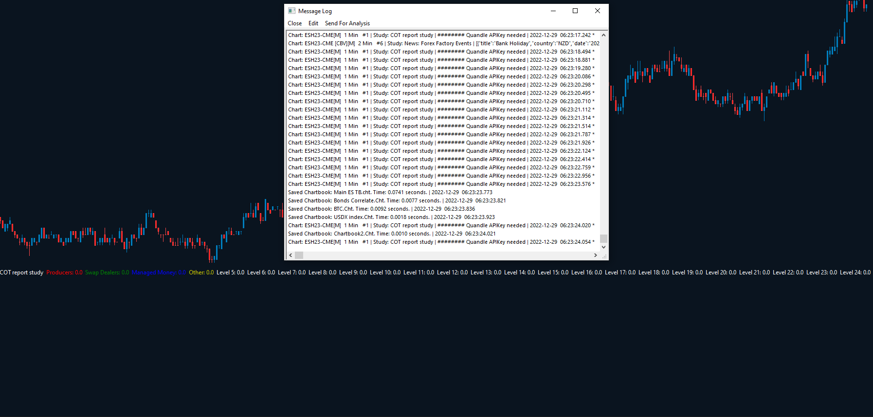

blackcobra777 - Posts: 28
it is compile but now i cant use it shows nothing and sys cot report stud### quandle api key needed etc? what is this how can set all this to show cot and work it ? i attachted the screenshot too you check it and help to get through this thanks..

[2022-12-29 20:40:28]
ForgivingComputers.com - Posts: 1253
According to the Message Log, you need a Quandle API key. A quick search locates this site: https://rapidapi.com/zakutynsky/api/Quandl/details

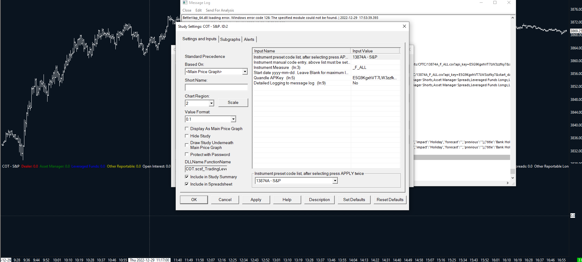

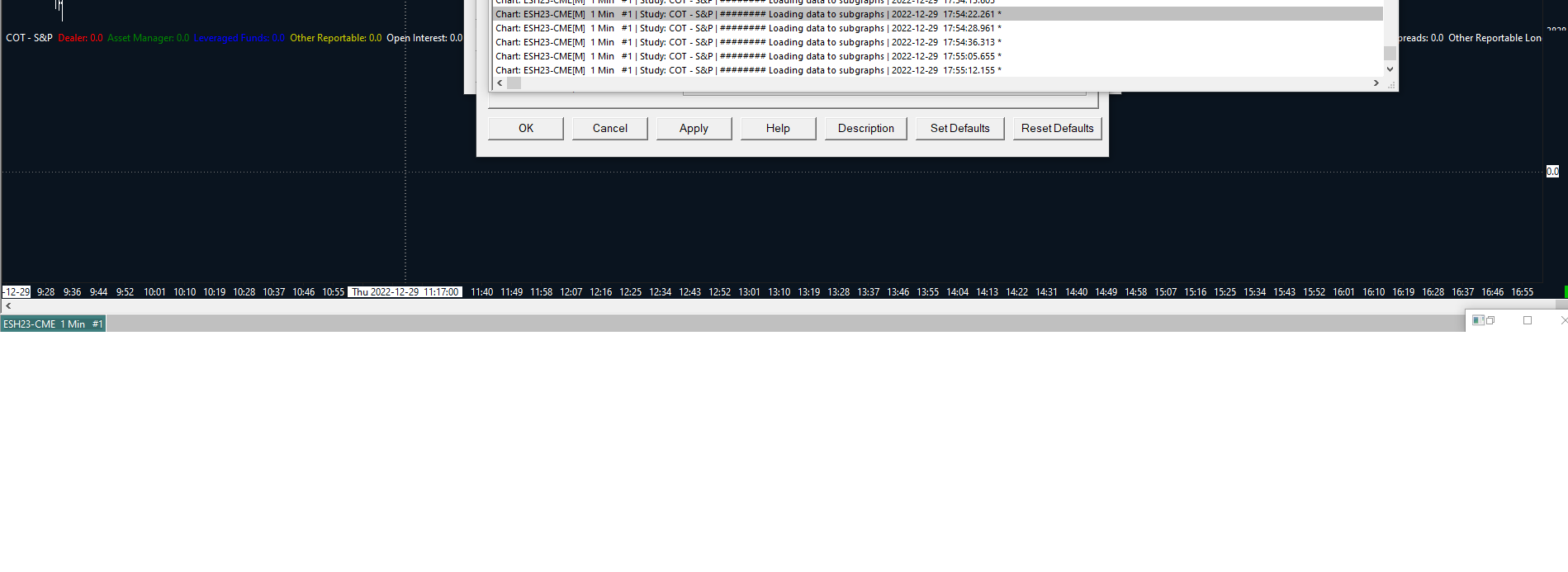

sTILL CANT SHOW ANYTHING IDK WHY , See the readon i attached a two screenshot again, one is the log report says loding data but cant show anything other is settings of cot may be i i did it wrong check it plz and help me to see this..
imageAPI2.png / V - Attached On 2022-12-29 23:02:53 UTC - Size: 36.03 KB - 223 views
imageapi3.png / V - Attached On 2022-12-29 23:02:58 UTC - Size: 83.12 KB - 206 views
[2022-12-29 23:28:51]
User431178 - Posts: 910
COT data has one data point per week, try looking at it on a weekly chart instead.
[2022-12-30 00:10:22]
yeah it works thanks
