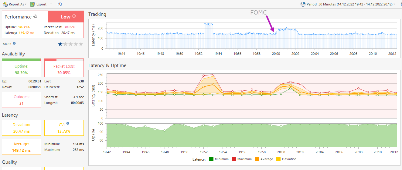

Attached is the statistic of the last minutes heading into FOMC. Timezone is Central European
imageSNAG_ 2022-12-14 - 20-13-26.png / V - Attached On 2022-12-14 19:14:41 UTC - Size: 84.11 KB - 272 views

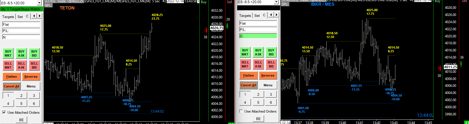

Left : Teton
Right : IBKR
Same Denali feed [M]
image2022-12-14 20-22-40.png / V - Attached On 2022-12-14 19:24:16 UTC - Size: 30.2 KB - 302 views

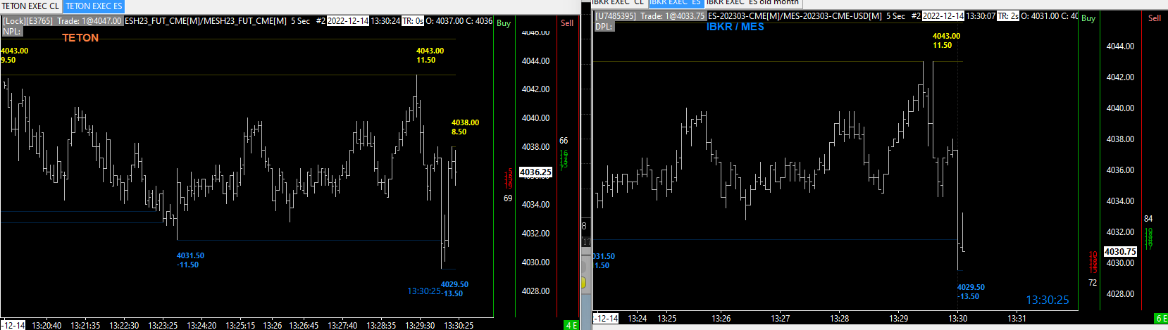

Just to help.
I'm fan of Sierra Chart.
image2022-12-14 20-30-25.png / V - Attached On 2022-12-14 19:31:14 UTC - Size: 45.47 KB - 257 views

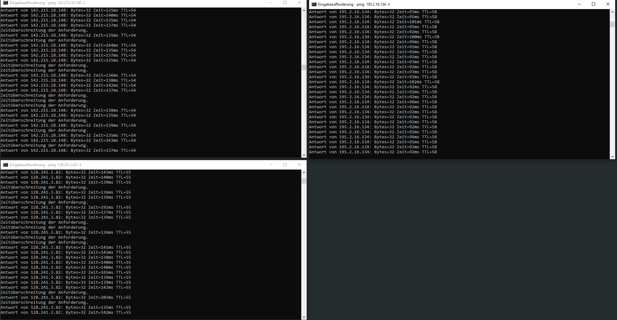

Checking the same IP it shows massive paketloss for me. Strange that Teton an all the other IPs I monitor are ok. Only Denali and the Equinix IP are having very bad stats.

I can locate the issue 100% between hop 10 and 11 - so it is an peering issue with NTT when markets get wild.
Ping to 195.2.16.134 shows nearly no paket loss. Ping to 128.241.2.153 a lot!

Screenshot that highlights it attached. I checked with two carriers (VDSL and cable) and also a 5G Backup connection - clearly out of my scope and not fixable for me ;-(
But happy I found it after weeks of issues and relying on another datasource.

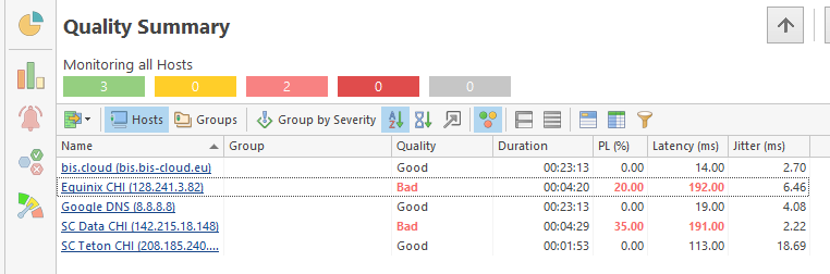

What is this software youre using to monitor connection quality, ping, etc? Thanks!
It's EMCO ping monitor in it's free version
