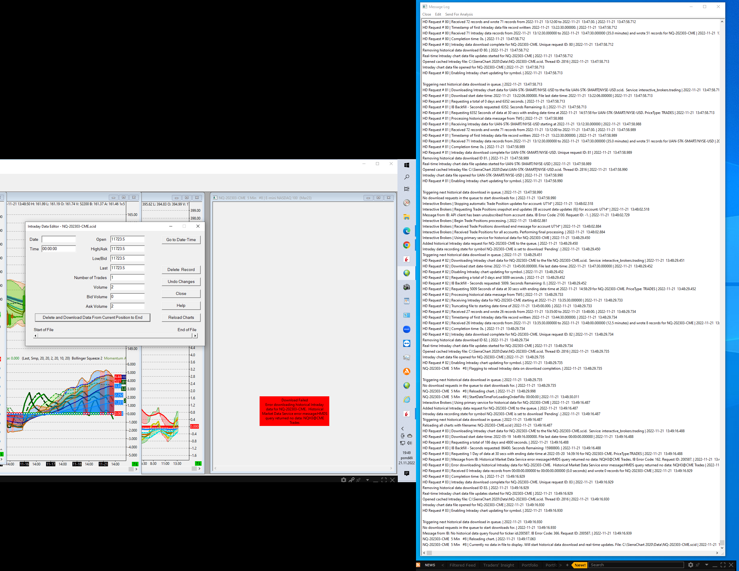

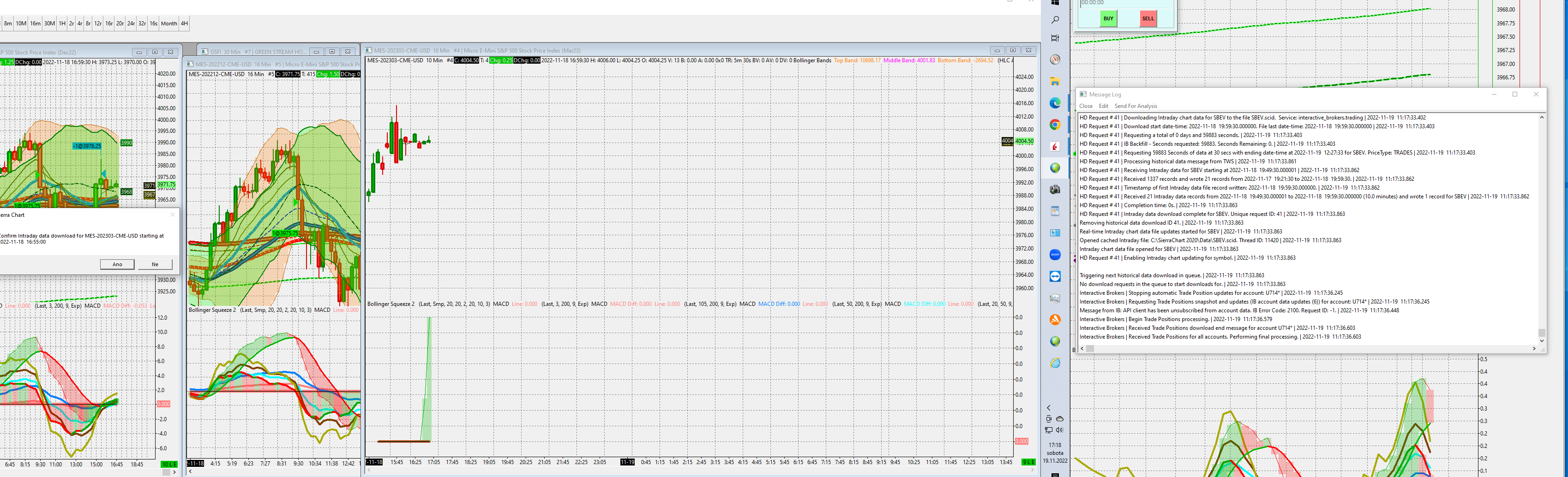

After correcting previous errors in intraday charts (TWS and SCH versions), everything worked correctly 202212. When entering the symbols MES 202303, NQ 202303, etc. the problem with loading history in intraday charts appeared again - it is missing and when using delete and down... it is not filled in and when using edit/down.... they are even deleted and everything starts from scratch.
Please find and correct the error.
Thank you Marie.
image2022-11-19 (11).png / V - Attached On 2022-11-20 17:52:40 UTC - Size: 352.54 KB - 322 views
image2022-11-19 (10).png / V - Attached On 2022-11-20 17:53:07 UTC - Size: 406 KB - 268 views

i tried the recommended offline and i have IB TWS Build 10.20.1c and SC version 2455 but the problem still persists
image2022-11-21 (18).png / V - Attached On 2022-11-21 19:15:21 UTC - Size: 527.34 KB - 222 views
image2022-11-21 (19).png / V - Attached On 2022-11-21 19:15:36 UTC - Size: 544.92 KB - 305 views

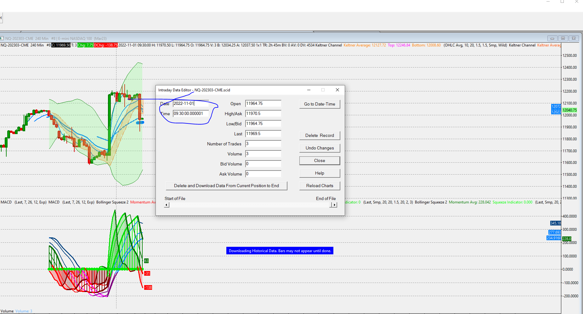

thank you again for your hints and replies. I have been in touch with IB and their respond is that they can not influence what is displayed on the 3rd party GUI, which makes sense to me. IB was updated to latest version as well and still for some reason I have a problem to download data from the past. SCH allows me just certain date, usually one day maximum. As per Screenshot if I want to change the date for example starting 3 months ago it changes the dates just automatically to some "random" dates. The same is applied when I use delete and upload data. It shows the notification that the data starts only from specific date.
Any suggestions, please?
Thank you very much
imageprtscn (1).PNG / V - Attached On 2022-12-07 17:45:37 UTC - Size: 114.53 KB - 287 views

The screenshot you attached is showing the Data Editor. That is not related to how to get more data. It is used to adjust any particular data point for some reason (typically you should not use this).
Refer to the following for how to get more intraday historical data:
Historical Intraday Data (Missing Data / Download Errors / Viewing More Data): Downloading/Viewing More Historical Intraday Data
