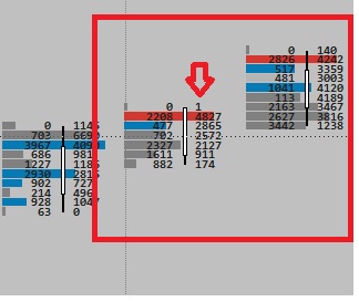

According to the documentation a new bar can only appear when the retracement critera is met: "A new bar is only started when prices reverse from the High or the Low, depending upon which side is being monitored for, by the specified number of price ticks."
However I've seen bars where a new bar appears and the retracement criteria has not been met. May be something wrong with this type of bars?
Thank you.
David
imageReversal bar.jpg / V - Attached On 2022-10-25 13:24:02 UTC - Size: 50.89 KB - 601 views
[2022-10-25 16:09:34]
The situation you display is possible. The Reversal Bar will does not work in a way that you would need to see a 3 tick difference between the two bars. A new bar is started when the current bar has reversed 3 ticks from its high or low. Refer to the information here:
Chart Settings: Reversal Bar (in ticks) (ReversalAmount - MinimumLength) (Chart >> Chart Settings >> Bar Period >> Intraday Chart Bar Period >> Bar Period Type)

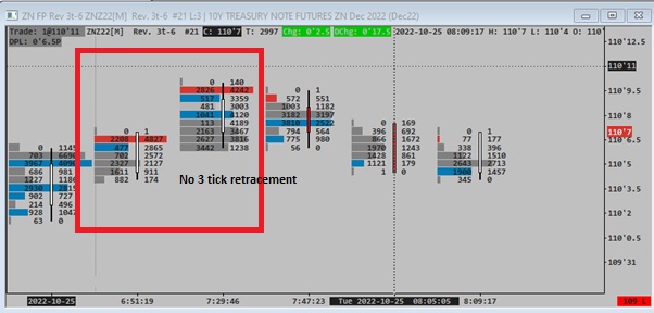

[2022-10-25 16:42:39]
davidfc85 - Posts: 9
Hi John,
Thank you for you answer.
In that case there was no 3 ticks reverse from its high. Please find attached a comparison tick by tick where can be seen that there is no 3 tick retracement from its high and a new bar starts.
Thank you!
David
imageReversal bar tick by tick.jpg / V - Attached On 2022-10-25 16:42:31 UTC - Size: 146.69 KB - 660 views

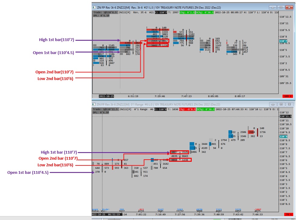

[2022-10-25 16:58:24]
I think that the reversal is being evaluated before the bar has reached the minimum length, so when the bar gets the minimum length it starts the next one.
Isn't supposed to evaluate the reversal only when the minimum length is reached?
Thank you so much.
David
Date Time Of Last Edit: 2022-10-25 16:58:40
[2022-10-25 17:27:26]
This is the relevant documentation for what is occurring at those bars:
When using a Minimum Length setting, as soon as the Minimum Length is reached, and if the price at that point is the specified number of ticks from the high if the prior bar reversed at the low, or from the low if the prior bar reversed at the high, then a new bar will be initiated which means that the opening can be the same as the closing price of the prior bar. This can mean that in the case of candlestick bars, that in some cases you do not notice any wicks for that subsequent chart bar.
[2022-10-25 18:21:16]
Hi John,
Thank you so much for your support. I see the point in the documentation.
However, would it be possible to implement in Sierrachart a type of bar where the reversal will be evaluated only after the minimum length has been reached? In that case there wouldn't be bars where the opening is the same as the closing of the prior bar, and we can see the reversal after a big push (selected by minimum length).
Thank you again!
David
