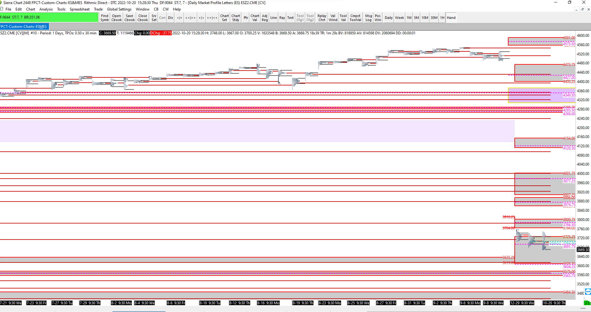

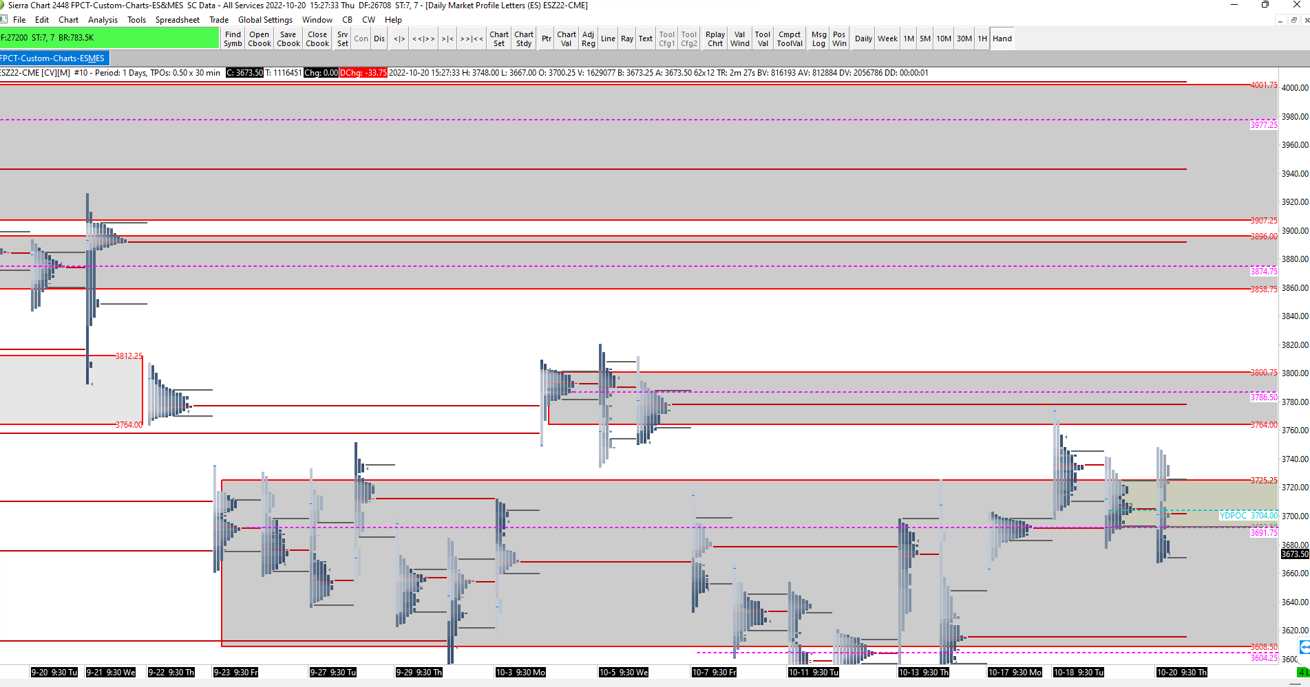

I am set-up to use Denali Data, I am verified as a Non-Professional, and I have activated CME Exchange Data with Market Depth
However, when I connect to [SC Data All Services] my Data is different to when I connect to [Rithmic], (1) I am on SP11, (2) I have enabled [Common Settings]: "Allow Support for Sierra Chart Data Feeds"="Yes"
See the attachments showing how different my data is when I connect to the different Services, the SC Data-All Services attachment is exactly what I want.
Please help
imagewhen connected to Rithmic (for Order Routing Only).png / V - Attached On 2022-10-21 14:33:51 UTC - Size: 99.29 KB - 183 views
imagewhen connected to SC Data All Services.png / V - Attached On 2022-10-21 14:34:03 UTC - Size: 94.78 KB - 188 views

We are not understanding how you are switching between the data that is used in each chart. Just changing the symbol would not do it. Are these two different charts in different chartbooks?
We do see that there is an issue with the chart you list as "Rithmic" in that the dates jump from September to December 29, to October 20. This could be data, but it also could be a study that is causing an issue.
In addition to letting us know about the above, we also want you to remove the TPO study from those charts in order to view the underlying data and see how that looks.

Answer: I am not just changing the symbol. This is the same chart that is left open, and all I am doing is switching the data/trade service setting between SC and Rithmic. This is the same chart in the same chartbbook

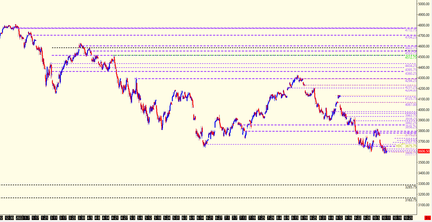

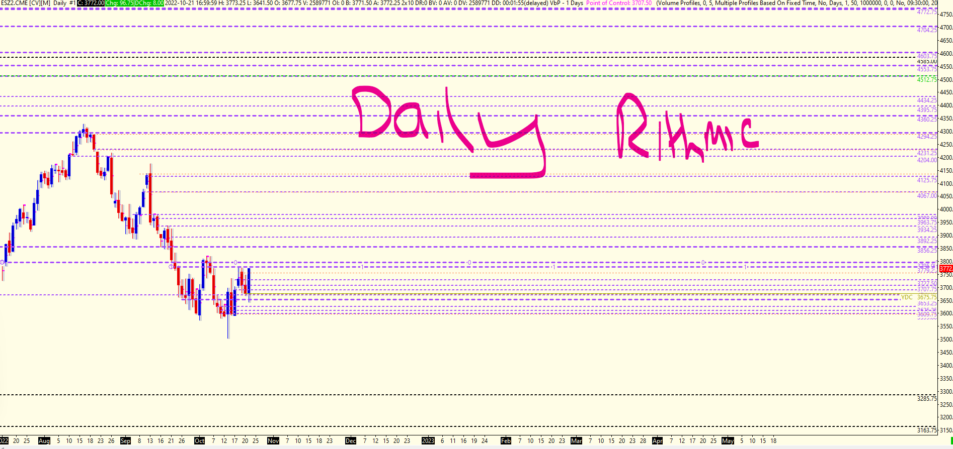

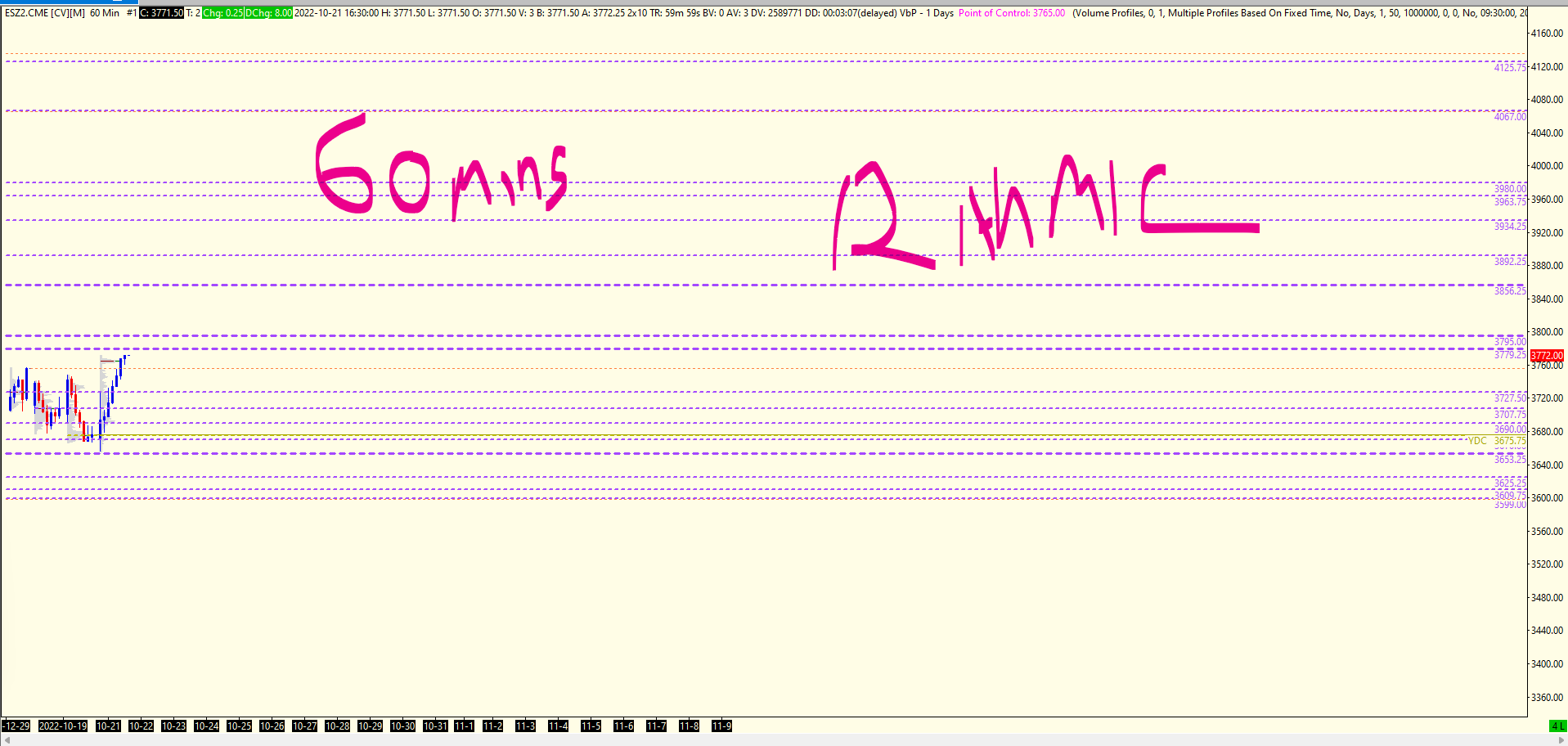

Answer:This cant be the study as it works when I switch the Data trade settings to SC and do not change anything in the study and its the same chart on both attached pics. It is not just this TPO chart, it also happens on all other charts where that study isn't actiavted. I have attached another 3 pics of another chart but 3 different situations when I switch the data over from SC all data to rithmic. When I do a a 60minute chart or daily, on SC all data it works fine as shown in picture. Then when I switch to Rithmic data and 60 min data it looks like the attached. But while staying on the Rithmic data and move that chart to the daily, It shows more previous data that then 60 minute but still missing loads before and not 400 days to how I have set it.

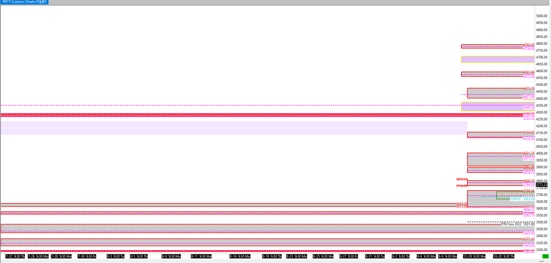

Answer: I have attached the picture when I take the study off which gets rid of all data as TPO is a study. But to answer this question more, it is not a study issue as it happens across all of my charts when switchin between SC data and Rithmic with no studies open.

imageSC data chart 1.png / V - Attached On 2022-10-22 06:26:28 UTC - Size: 70.57 KB - 184 views
imageDaily rithmic data.png / V - Attached On 2022-10-22 06:29:27 UTC - Size: 108.88 KB - 171 views
image60 mins rithmic.png / V - Attached On 2022-10-22 06:48:12 UTC - Size: 83.79 KB - 179 views

Added the no study TPO chart here as can only upload 3 in previous message.
imageno study .png / V - Attached On 2022-10-22 06:49:20 UTC - Size: 61.89 KB - 185 views
