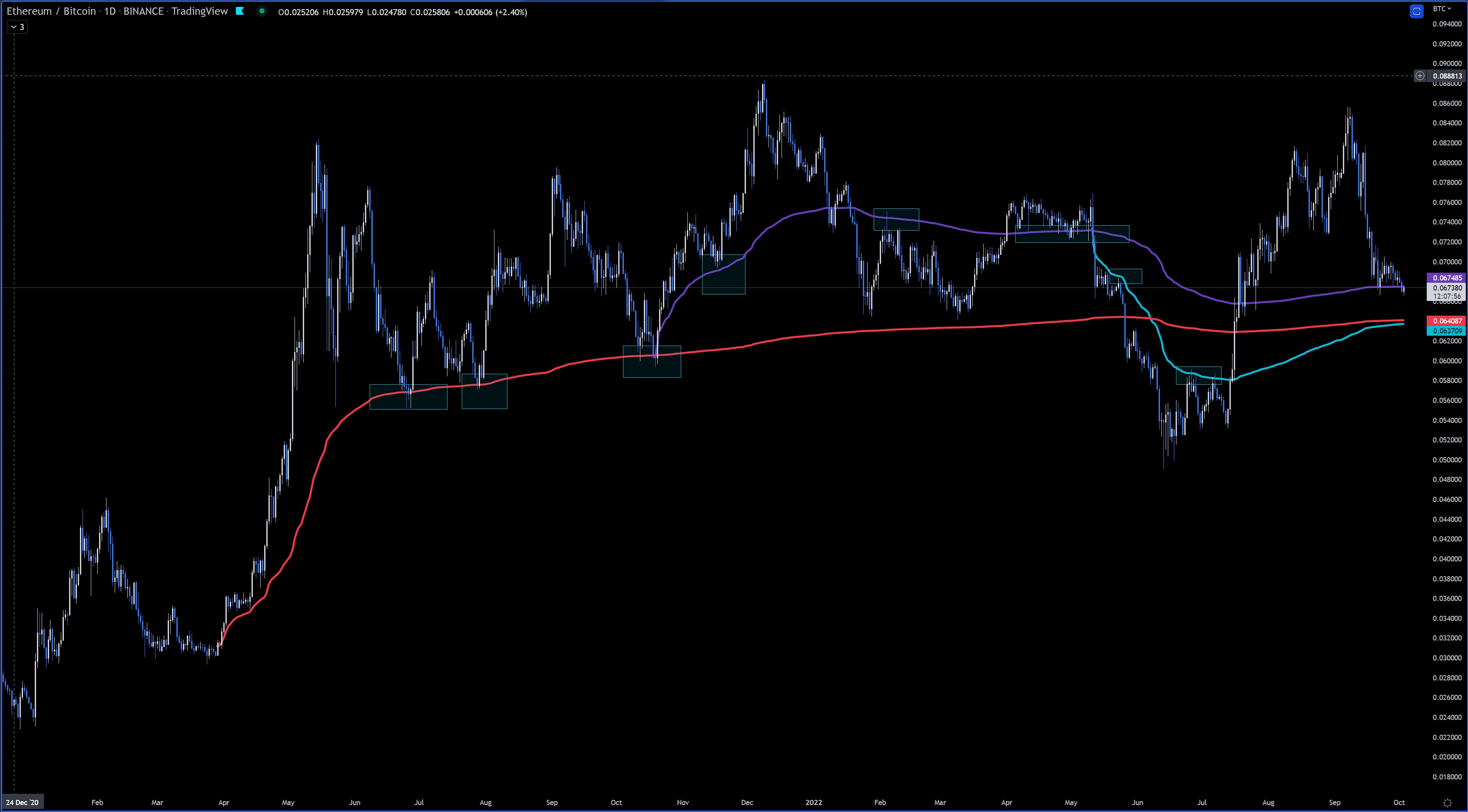

IMAGE 1 shows an example of the behavior of price when meets anchored VWAP.

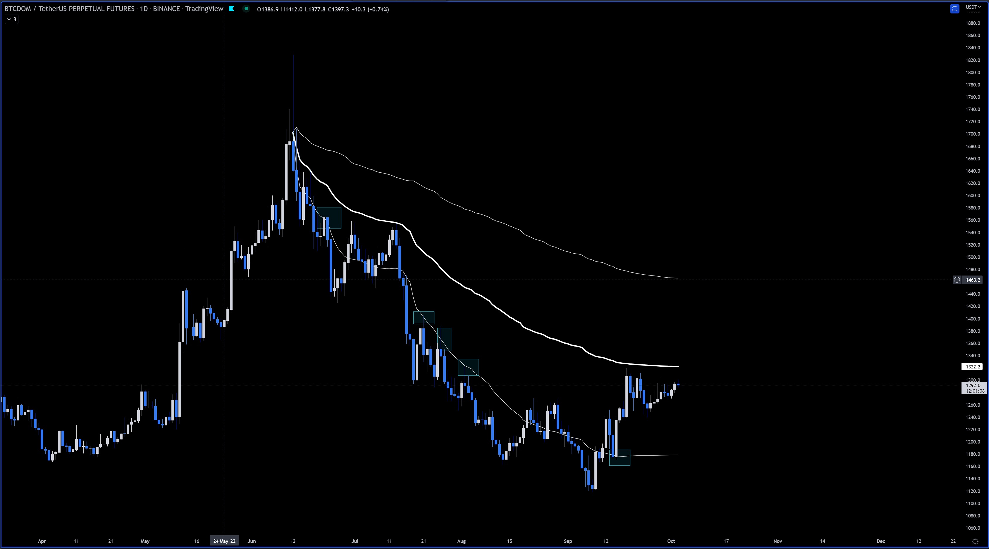

IMAGE 2 also shows that when price moves very aggressively can also respond to the standard deviations of the anchored vwap from the critical point that signifies a change in sentiment.

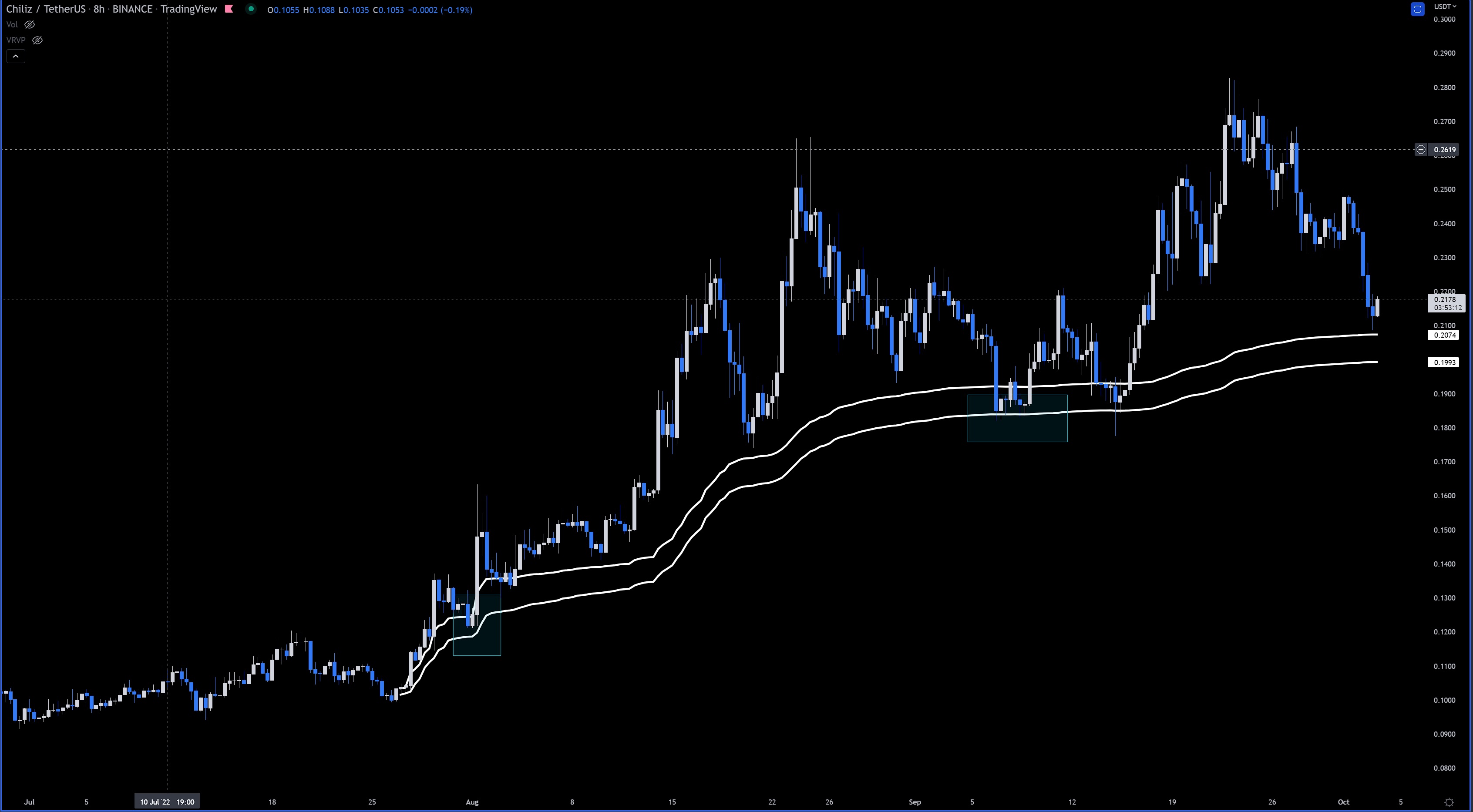

There are instances when a bounce from a support or resistance VWAP level is not "clean" in the sense that some relatively small penetration occurs before the expected trend reversal.
So in many instances, the fix for this, even illogical, is to calculate the vwap curve using the lows of the candles when the anchor point is used for support and the high of the candles when the anchor point is used for resistance.
The aim of this is to create a curve that is more "forgiving" than the original curve (lower if support and higher if resistance) and thus attempt to capture that penetration of price.
IMAGE 3 shows this.
Therefore since VWAP is just an approximation to a more complex reality, and the rejection point is not absolutely precise but vague, what is usually attempted is a form of a VWAP channel ( or standard deviation channel). The capability to initiate two VWAPs from the same point. One with underlying or HLC/3 data and another one with high or low data so effectively forming a VWAP channel area in which the potential rejection might occur. Something that IMAGE 3 illustrates.
