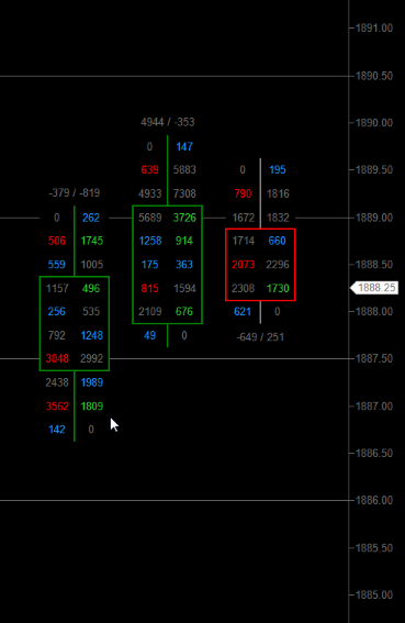

Good morning,
How can i have an order flow like this picture ?
I read this topics but it did not work.
https://www.sierrachart.com/index.php?l=doc/doc_NumbersBars.php
Thanks for your help.
imageorder flow.PNG / V - Attached On 2014-05-14 11:10:46 UTC - Size: 33.52 KB - 2295 views
[2014-05-14 11:42:35]
Dom7364 - Posts: 258
Number bars study, then BID VOL X ASK VOL then you higlight the number with dominant diagonal option.

[2014-05-14 16:36:20]
User73873 - Posts: 14
Thanks Dom7364.
In fact, I would like the total of Bid and ask below the candle.
And if it is possible, to draw the open, the close, the high and low like the previous picture. A candle in fact.
imagesierra.png / V - Attached On 2014-05-14 16:33:11 UTC - Size: 145.14 KB - 6301 views
[2014-05-14 16:47:48]
As attached?
http://www.sierrachart.com/image.php?l=1400086020938.png
[2014-05-14 16:53:23]
Yes Dom. The same.
[2014-05-14 17:00:07]
For the totals you will want to use the Numbers Bars Calculated Values study:
http://www.sierrachart.com/index.php?l=doc/doc_NumbersBars.php#NumericInformationBelowBars
You cannot draw an actual candlestick outline, but instead you can enable a study input to draw boxes from the Open to Close. This is documented in this section here:
http://www.sierrachart.com/index.php?l=doc/doc_NumbersBars.php#InputSettings
Refer to the input "Open to Close Boxes".
[2014-05-14 17:09:32]
First, you setup your number bar with colours, Bid vl x ask, column 1 colouring method: Text on diagonal Dominant side. You can then adjust colours as you want. Second, you create another chart bok with a candle chart for the same intrument (not sure it has to be the same but anyway). THen you add the study : Price overlay to add to the chart that contains the number bars, and you choose the chart number corresponding to the candle chart you've created. You then set the region to 1 (same as number bar view), and check the option "draw study underneath main price graph).
This way you will have full candles, and you will see the figures above it. If you wznt candles to be hollow, just make you candle chart hollow, and then check "use colours from study": YES in the Price overlay settings.
I hope this makes sense. Pls note this is doing exactly the same as your inital chart, i.e, shows volume imbalances diagonally (the way a footprint chart should be read, bid/ask view).
