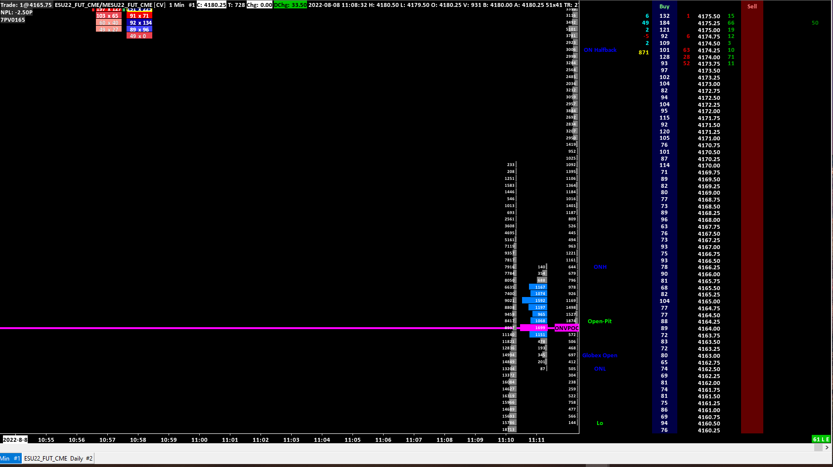

[2022-08-08 15:09:54]
Steve Leon - Posts: 319
I have a day, overnight and microcomposite (several days/week) displaying on my chart
Today my overnight profile appeared very shortened
I played around with a number of study inputs and chart settings but could not get the entire overnight profile.
I have set for start time to from start time to end time. with start time set to 18:00 and Ebd Time to 9:29:59
It was working last week
I wondered whether this was due to the Sunday night overnight session ? I remember at one time there was a setting for revers session times but i cant find it on the new format ?
The other question I have is that for the three profiles mentioned I have
Volume Profile Bars Length Relative to all Visible Profiles set to YES for all three profiles
The volumes and volume bars seen in the individual profile do not seem to reflect this. For example the volume numbers for my micro composite profile are larger (of course) than for my day profile. The window widths are all set the same at 5. The Volume bars appear larger on the day profile even thought the volumes are less
Thank you

[2022-08-08 18:46:06]
John - SC Support - Posts: 48429
We really need to get your chart to understand all the pieces. Please make a copy and get us a chartbook with just that one chart in it by following these instructions:

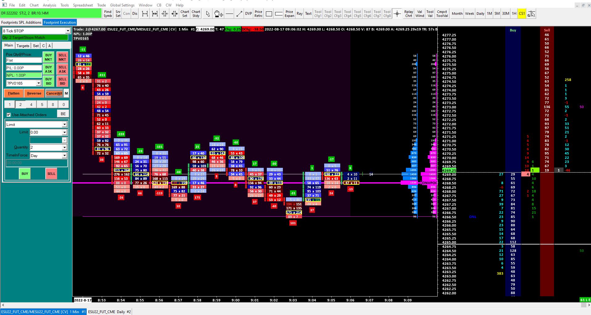

[2022-08-17 13:10:52]
here is attachment
imagesierra overnight profile issue 8-17.PNG / V - Attached On 2022-08-17 13:10:29 UTC - Size: 214.94 KB - 544 views
[2022-08-17 14:29:21]
What exactly is the issue with the image you provided? We are not sure why the two volume profiles are the same, but there does not appear to be anything "missing".
Something to keep in mind when using the "Align to Far Right" for the Volume Profiles (hopefully this explains what you are seeing). In order to conserve resources, the system only draws the profiles for the bars that are in view at that time. In addition, the particular profiles that are drawn are stacked on top of each other starting from the far right - this means that the exact location of any particular profile can change depending on what bars are displayed at the time. So the Evening Session profile may not be the second from the right profile every time.
The best way to see that your profiles are correct is to scale way out (decrease the bar spacing) so you have all the bars that cover the time periods of all the profiles, which may also require changing the vertical scale. You will then be able to see the profiles stacked as you would expect and you can then ensure that they are covering the periods they are supposed to.
[2022-08-17 16:41:13]
The profiles are actually drawing more than just the bars in view at present
The picture I had sent shows two profiles. The one on the far right is intended to show the day/cash session/nyse start/9:30 am.
Because it was before that time it was displaying what should be the overnight session. The overnight profile seems to be "truncated".
I experimented with a number of different settings/options and it seemed to give me what i am looking for when i set the 2nd profile for the right to ALL VISIBLE BARS and select the start time and end time that i am looking for.
I had been using From Session Start Time to End or One Period from Start Time to End Time. That seemed to work but was occasionally giving me the noted problem with the truncated profile from time to time.
I assume i should be using 0 = Number of Periods Back to Reference; for what I am trying to do ?
I also assume that i should have Use Different Start Time set to = Yes and then enter Start time of 18:00 for start of overnight session and End Time = 09:29:59.
For now the problem seems resolved
Any additional insight you can provide is greatly welcome
Thank you

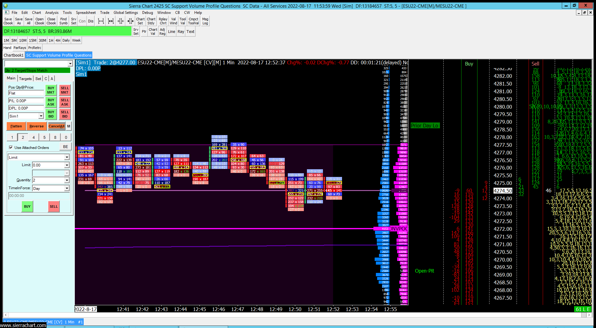

Sorry, it's not that they are only drawing for the visible bars, they are drawing for the period you define, but if the bars are off the top or bottom, then you will not have the profile drawn, as there is no profile to show at that level.
We really do not think there is an issue, but it is just a matter of understanding what is being drawn. The main thing to keep in mind is that you will NOT have the same order of the profiles going from right to left, unless all the bars are within view (top to bottom). The thing to do is to compress your scale to ensure that the range of the data is all within view, and you should see all your profiles. Let us know if this is not the case.
Here are examples from the chartbook you sent us.
First, this is the image of a fairly standard view which only shows 2 profiles:
https://www.sierrachart.com/image.php?Image=1660755240416.png
Second, this is the image of a compressed view where you can now see all 4 profiles:
https://www.sierrachart.com/image.php?Image=1660755476903.png
You can see that unless the range of the bars is in view (above/below, not forward/backward), you do not get the profile showing up.
