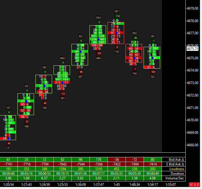

See attached chart: In order to display properly formatted bid/ask quantities, deltas, and volume in chart area 2 I have [value format] set to "1" in the Numbers Bar Calculated Values study. Anything else (including "inherited") will display fractionated values.
Question: How can I still make use of the price-related subgraphs in a CBBOAC formula without breaking the formatting of how the NBCV matrix is displayed in chart area 2?
Out of curiosity, I tried setting the CBBOAC [value format] to "0.01" but that didn't work, of course. Therefore, I'm forced to into a dilemma... display the matrix and lose formulaic ability, or the opposite.

[2022-01-09 04:11:03]
There is not support for this:
What you can do though is use a hidden Numbers Bars Calculated Values study with the appropriate Value Format and reference that.

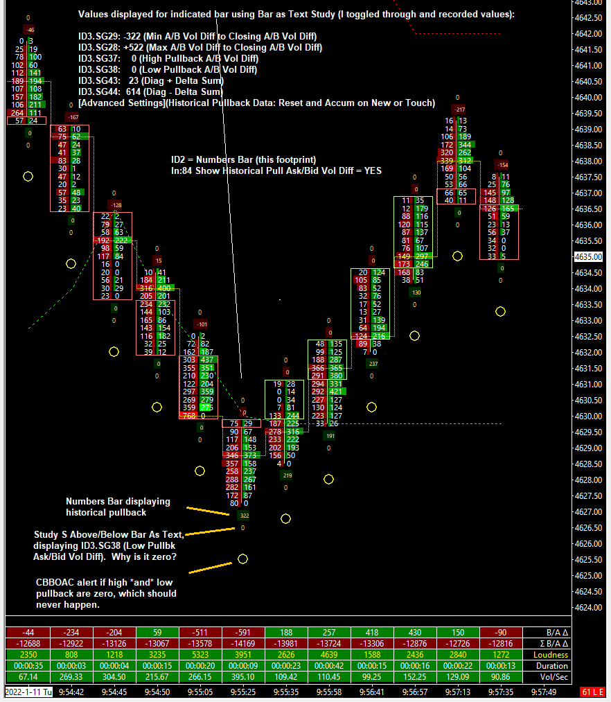

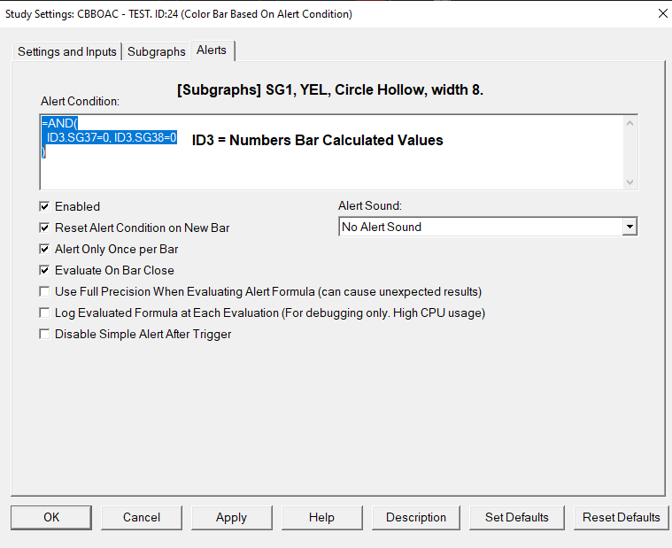

Problem Description:
The Numbers Bar study is correctly displaying the Historical Pullback Ask/Bid Volume Difference in the chart display (In:84 = YES). However, both sets of numbers come back as zeros (0) when referenced from the Numbers Bar Calculated Values study. I do have historical pullback enabled (as evidenced by the values being displayed). I have attempted to display these values via Study Subgraph Above/Below Bar as Text, and they display as zero (0). I have also tried to reference them in a CBBOAC formula, and both sets of values evaluate to zero (0) each time.
Please see the attached screenshots, as well as the privately attached chartbook.
imageError1.PNG / V - Attached On 2022-01-11 23:03:01 UTC - Size: 30.22 KB - 358 views
imageError2.PNG / V - Attached On 2022-01-11 23:03:08 UTC - Size: 128.87 KB - 348 views

[2022-01-12 20:22:35]
You need to have the Pullback subgraphs in the Numbers Bars Calculated Values study set to "Visible" in order to get the data for those subgraphs. Unlike other subgraphs in the Numbers Bars Calculated Values study, these are not calculated unless you have them displayed.
Also, you have both the Study Subgraphs Above/Below Bar As Text set to the same subgraph.
