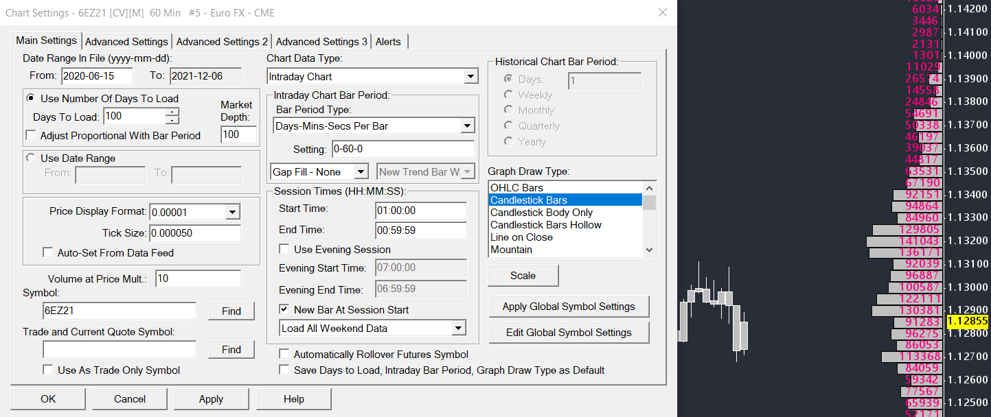

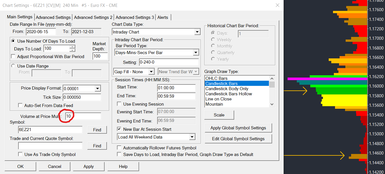

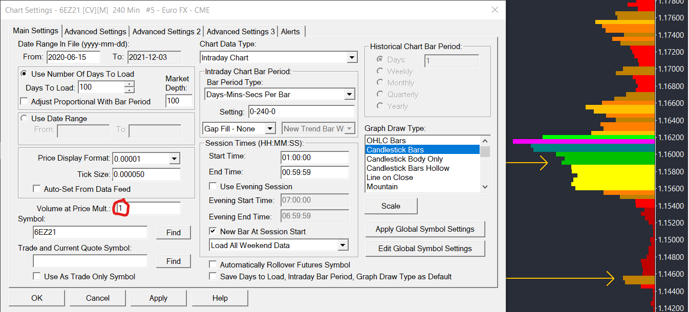

[2021-12-04 13:52:43]
User350195 - Posts: 37
Chart Settings 'Volume at Price Multiplier' is causing Volume by Price study to create different volume levels than by using 'Ticks Per Volume Bar' setting directly in the study.
Example 6E Chart:
Set Volume at Price Multiplier to 10 for - This will set VbP study Ticks Per Volume Bar to 10 ticks.
Set back Volume at Price Multiplier to 1 - This will keep VbP study Ticks Per Volume Bar at 10 ticks but data will be different!
So basically when setting VbP Ticks Per Volume Bar directly in the study, you'll get a different result than the same configuration with the Volume at Price Multiplier in chart settings.
I am not sure which one is correct but it seems direct study Ticks Per Volume Bar config is more accurate.
Please check sreenshots, arrows show how levels are changing in different configurations, it has a major effect on Bid and Ask Volume coloring methoods calculation as well.

[2021-12-06 16:01:48]
John - SC Support - Posts: 48658
We are not able to reproduce this. When we setup for the same symbol you are using, we get the same profile regardless of whether the Volume at Price Multiplier is set to 10 or 1.
Please try turning on the volume display in the profiles and see if you see differences in the volume numbers that are displayed. Please give us screenshots with the volumes displayed.
Also, what is the data period you are viewing for the profile and is there any possibility that the difference in the profile is just due to new data?

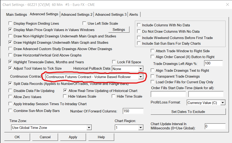

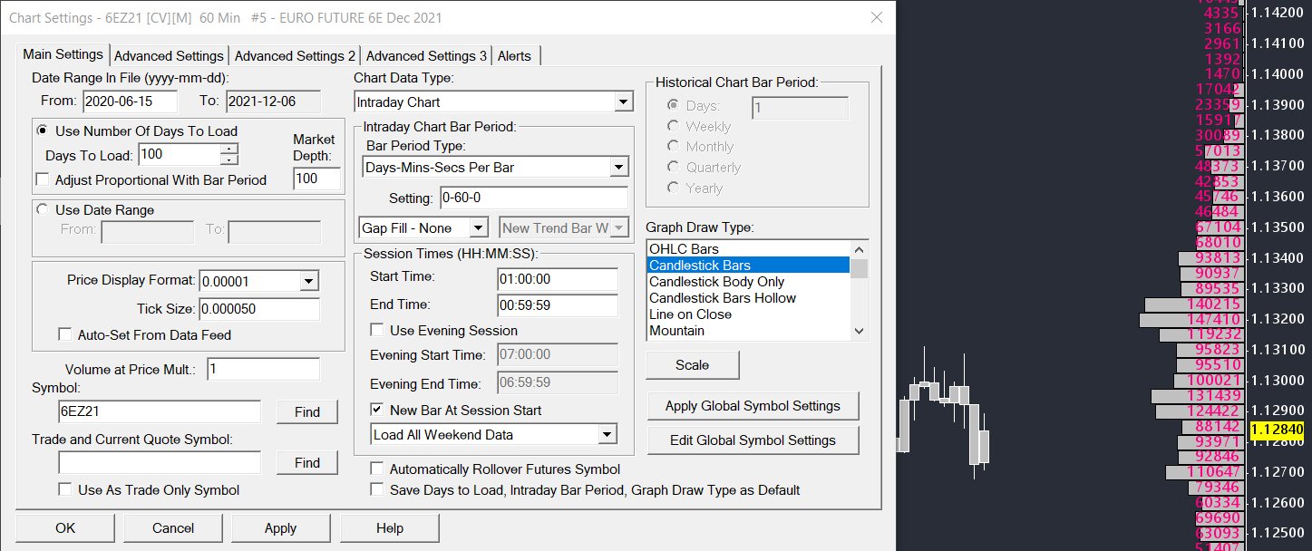

[2021-12-06 17:06:24]
Please check the attached screenshots. Also I have enabled Continues Contract setting. Not sure if that causes the issue..

[2021-12-06 21:59:29]
When we do the two scenarios, the data is exactly the same.
Although we do not think this accounts for all of what you are seeing - you have to remember that since you are looking at "All Bars" when you switch back and forth between these scenarios, if you are connected to the data feed, then you will see some differences as new data has been loaded.
In the end, we think this is related to your IB data.
Here is what we would like for you to do to verify it is the data feed or not. When you have a chance (and are not actively trading) change your setting for Global Settings >> Data/Trade Service Settings >> Current Selected Service to SC Data - All Services. This will give you access to the Delayed Streaming Data From Sierra Chart.
Then open the chartbook that has this chart in it and select Edit >> Translate Symbols to Current Service to get your symbols changed to the new service.
Then go to that chart and select Edit >> Delete All Data and Download and delete all the data in the chart and it will redownload it for you using the Sierra Chart data.
Then look at the two situations and see if you continue to have an issue. If not, then the only thing it can be is your underlying data.

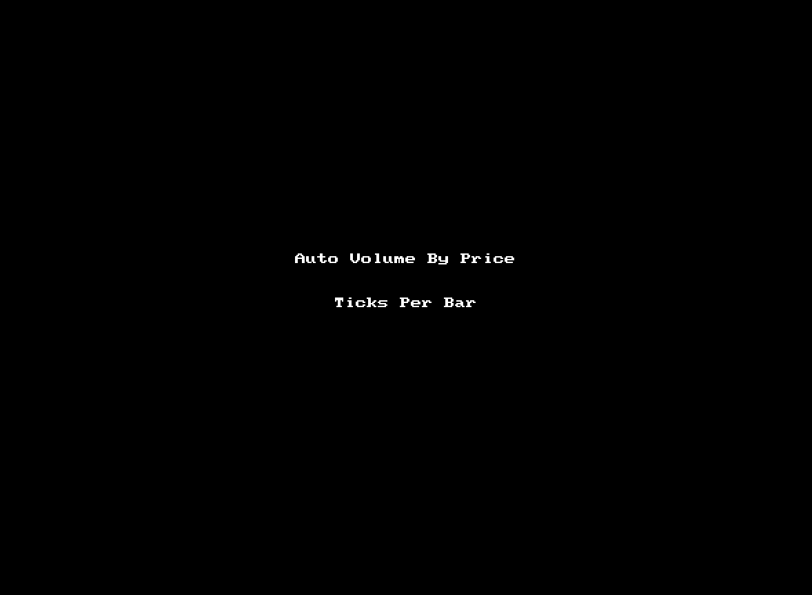

frozentundra - Posts: 102
@User350195 try this code we built as a workaround, been working extremely well for us:
https://github.com/FrozenTundraTrader/sierrachart/blob/main/auto_vbp_fixes.cpp
[2022-01-23 19:48:11]
@frozentundra
Hi, what is this code fix is for? I can't find any info. Also I placed file into SierraChart\ACS_Source directory it din't fix my issue..
[2022-01-23 22:22:30]
@User350195 - It's more a workaround than a fix, for the issue where if you switch symbols, then switch back, your VbP Ticks Per Bar doesn't return to what it was set at.
The code itself is there to read through, but in summary it sets up an automatic calculation to have your VbP Ticks Per Bar setting be completely automated and is rendered to be consumable by the human eye. So for example, if you load TSLA daily chart, then load AAPL, the code will automatically adjust the VbP Ticks Per Bar to make it readable without you having to modify the settings by hand.
I've attached a gif file I recorded to demonstrate what I mean ^^
As far as how to use it, you'd need to use the SierraChart remote compiler feature to compile the .cpp file into a DLL and then select that DLL in your Studies > Add Custom Study to the chart where you have your VbP.
If this doesn't provide a workaround for the issue you were facing then I apologize, please ignore, but I thought it was relevant and it is what @Malykubo and I were struggling with until we wrote this workaround.
Regards,
Frozen Tundra
imageauto VbP ticks per bar.gif / V - Attached On 2022-01-23 22:20:34 UTC - Size: 3.32 MB - 453 views
