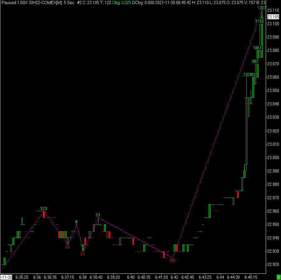

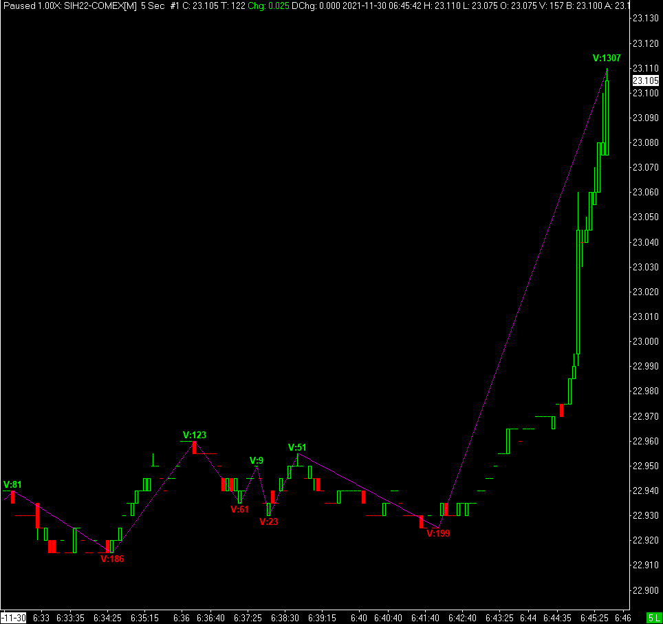

I have managed to get it working the way you recommended. The only issue now is the old values placed at Value on High are not being removed as the ZIG ZAG progresses. Please look at the attached pictures for chart 1 and chart 2 to see what I mean. I decided to use the "Chart Recalculation - Periodic" study with a 1 second recalculation time to address this, but it seems like this study is not doing a recalculation at all. If I go to Edit --> Recalculate All Charts on the menu, this fixes the problem. I am not sure why the "Chart Recalculation - Periodic" is not doing the same. I have also attached the updated chartbook.

imagePaused 1.00X SIH22-COMEX[M] 5 Sec #1 2021-12-03 20_51_22.png / V - Attached On 2021-12-04 04:53:23 UTC - Size: 17.25 KB - 335 views
imagePaused 1.00X SIH22-COMEX[M] 5 Sec #2 2021-12-03 20_37_51.png / V - Attached On 2021-12-04 04:53:31 UTC - Size: 14.96 KB - 298 views
