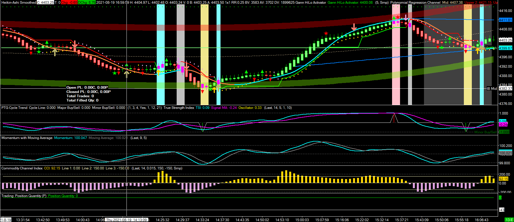

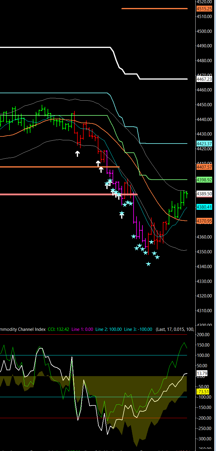

Currently, I have an alert based on conditions on several CCI studies, I am alerted whenever the CCI line crosses either below -200 or above 200, marking an extreme condition in the market.
My next step is I want to add an alert on the candle (could be another symbol or change the color of whatever candle it is) on the candle's close and the CCI crosses back into the normal range (between -100 and 100) after being in an extreme condition.
Any help would be greatly appreciated!
imageCCI Indicator Signal.PNG / V - Attached On 2021-08-19 14:07:52 UTC - Size: 57.98 KB - 565 views
imageCCIX Indicator.PNG / V - Attached On 2021-08-19 14:08:00 UTC - Size: 18.99 KB - 455 views

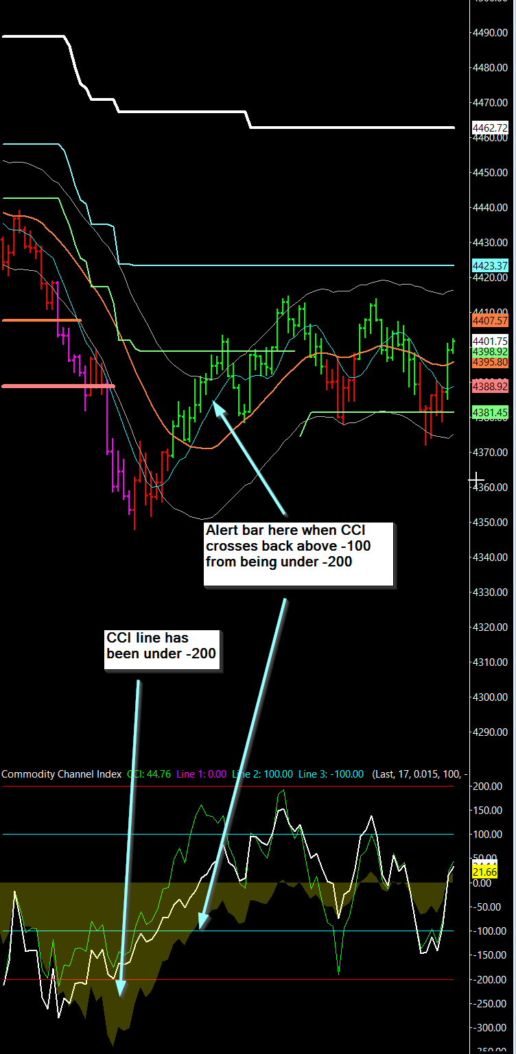

Hi Tom, I'm sorry if my question was not clear. The code you wrote for me alerts when price crosses above -100 from being under -100, and vice versa.
That is certainly part of what I want, however, I want to add a condition that so that the indicator only alerts me if the CCI has been under -200 and not just under -100.
For simplicity's sake I am going to talk about only 1 side for now

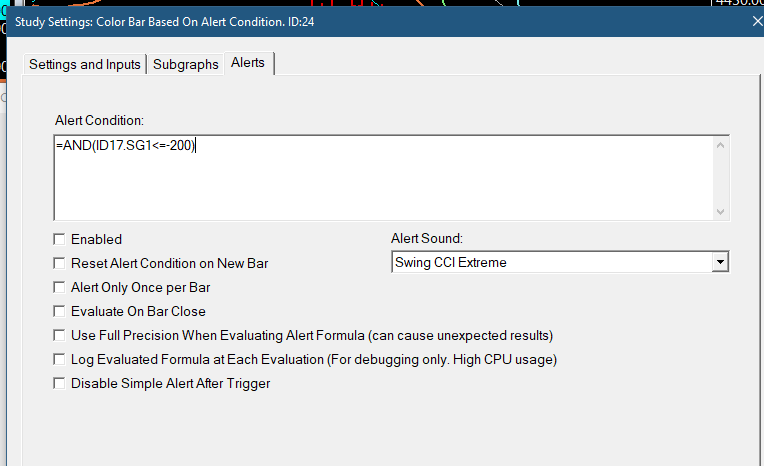

=AND(ID17.SG1<=-200) //this alerts me whenever the CCI line is under -200
=AND(ID17.SG1[-1]<=-100,ID17.SG1>-100) // this is what you wrote which alerts me when the CCI line crosses the -100 line back into normal range
now I just need to combine them so that it will only alert me on the -100 crosses ONLY IF it has been in an extreme condition (under -200)
Date Time Of Last Edit: 2021-08-20 13:21:25
imageCCI extreme crosses.png / V - Attached On 2021-08-20 13:10:39 UTC - Size: 95.31 KB - 544 views

Sawtooth - Posts: 4361
For this, you'll need to create a persistent TRUE when the CCI is <-200, and release it when it goes >-100, then find the bar where this occurs. Try this:
1. Add the Spreadsheet Formula study, and Hide this study.
Use a formula like this in its Formula field:
=IF(ID5.SG1>-100,0,IF(ID5.SG1<-200,1,ID6.SG1[-1]))
where ID5 is the CCI study, and ID6 is the Spreadsheet Formula study.
This creates a persistent 1 when the CCI goes <-200, and releases it to 0 when the CCI goes >-100.
2. Add the Color Bar Based On Alert Condition study.
Use a formula like this on its Alerts tab:
=AND(ID6.SG1[-1]=1,ID6.SG1=0)
where ID6 is the Spreadsheet Formula study.
This finds the bar where the persistent 1 was released.

tuanluu20902 - Posts: 24
Thank you so much for your detailed instructions! It worked, very much appreciated for the help!
